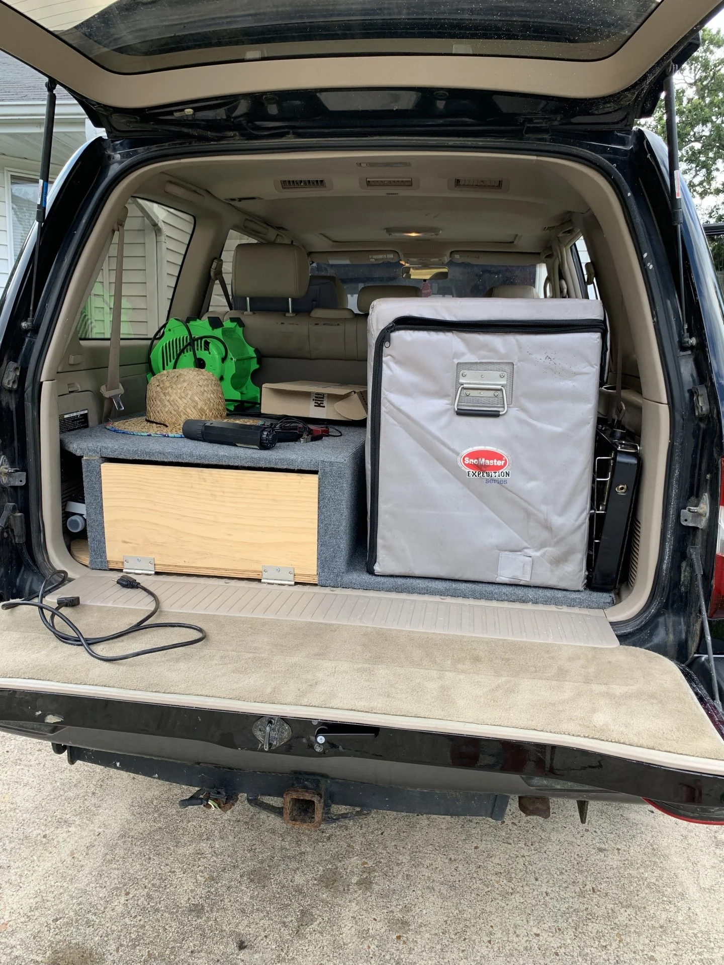

about to start the install of the snow master ex85 into the 100 series. I currently have it in my truck in a homemade drawer system. Recently as the temps have climbed and I changed my drawer the fridge I don’t think has adequate ventilation for cooling as it has a hard time holding temperatures after a couple days. Granted it is in a truck bed under a camper shell also.
I have added speed holes in the drawer to help it breathe a little and I believe it has helped.
however just as I’ve got that setups about dialed I picked up this 100 series to swap everything over too.

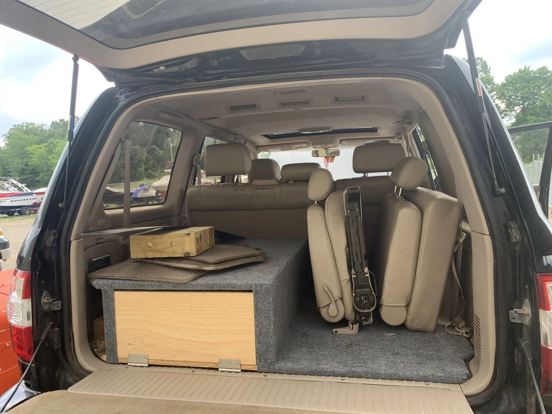

my current plan has the fridge on a slide mounted to the floor of the cruiser. With. Drawer next to it, and storage around it. I definitely want to make sure I am giving it enough ventilation to do its job, while maximizing the space around it for storage.
I’m sure being in the cabin of the vehicle with the air conditioning will help considerably, but hooping to do this project once unlike the 5 times Ive redone the truck.
I plan on cleaning the coils of the fridge before it goes in the 100 too.

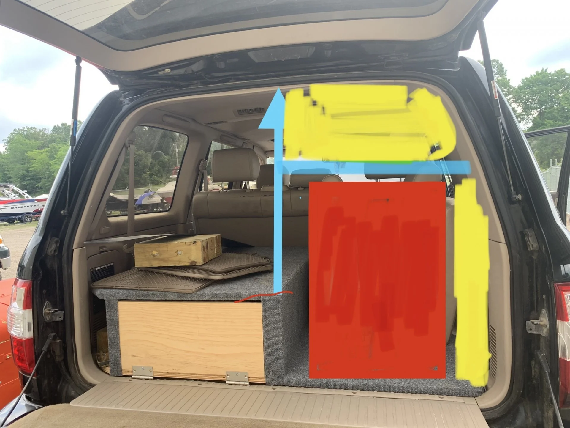

Current setup is the truck, the buildout has a start on the 100. The fridge will go on the right side.

Just sat the fridge in to test fit.
Centered between the pre existing drawer area, and wheel well I’ve got about 1.5” on each side. With the wheel well side having a more open area. Plus about 10” between the fridge and seat.

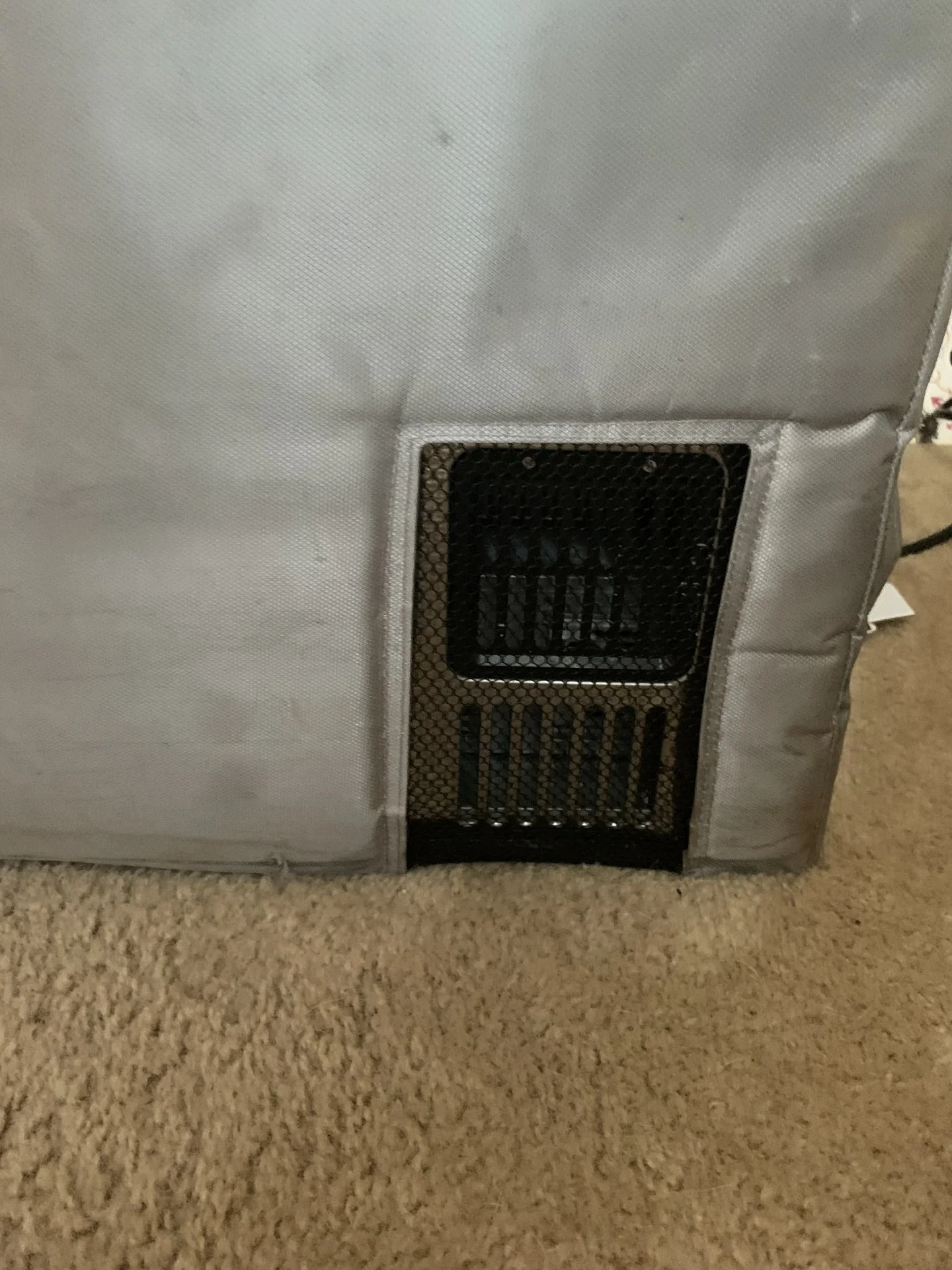

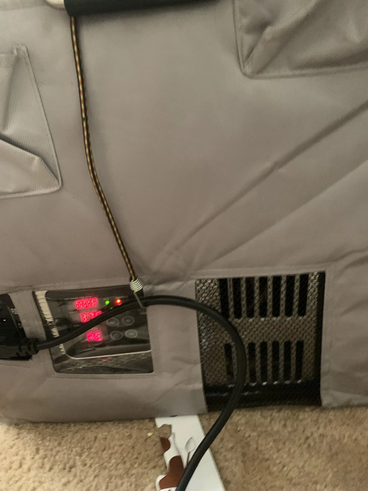

1.5" is not very generous if there are critical vents there. Is there a built-in fan?
Are there enough vents in that cover? and well located?
Is that the whole vent area (in and out) for the fridge? Seems way little if it is.
cheers,
george.
Looks pretty minimal unless the internal fans shift a decent amount of air. Anyhow, getting good airflow will make a big difference in fridge efficiency.
Also, the side with the 1.5" clearance will be major cooling bottleneck, especially since the vents are essentially at ground level.
I keep at least 6" behind and to the side of my ARB vents and I can tell when the weather is hot and air is not circulating out of the vehicle when camped on a hot day.
Maybe needs a snorkel :)
cheers,
george.

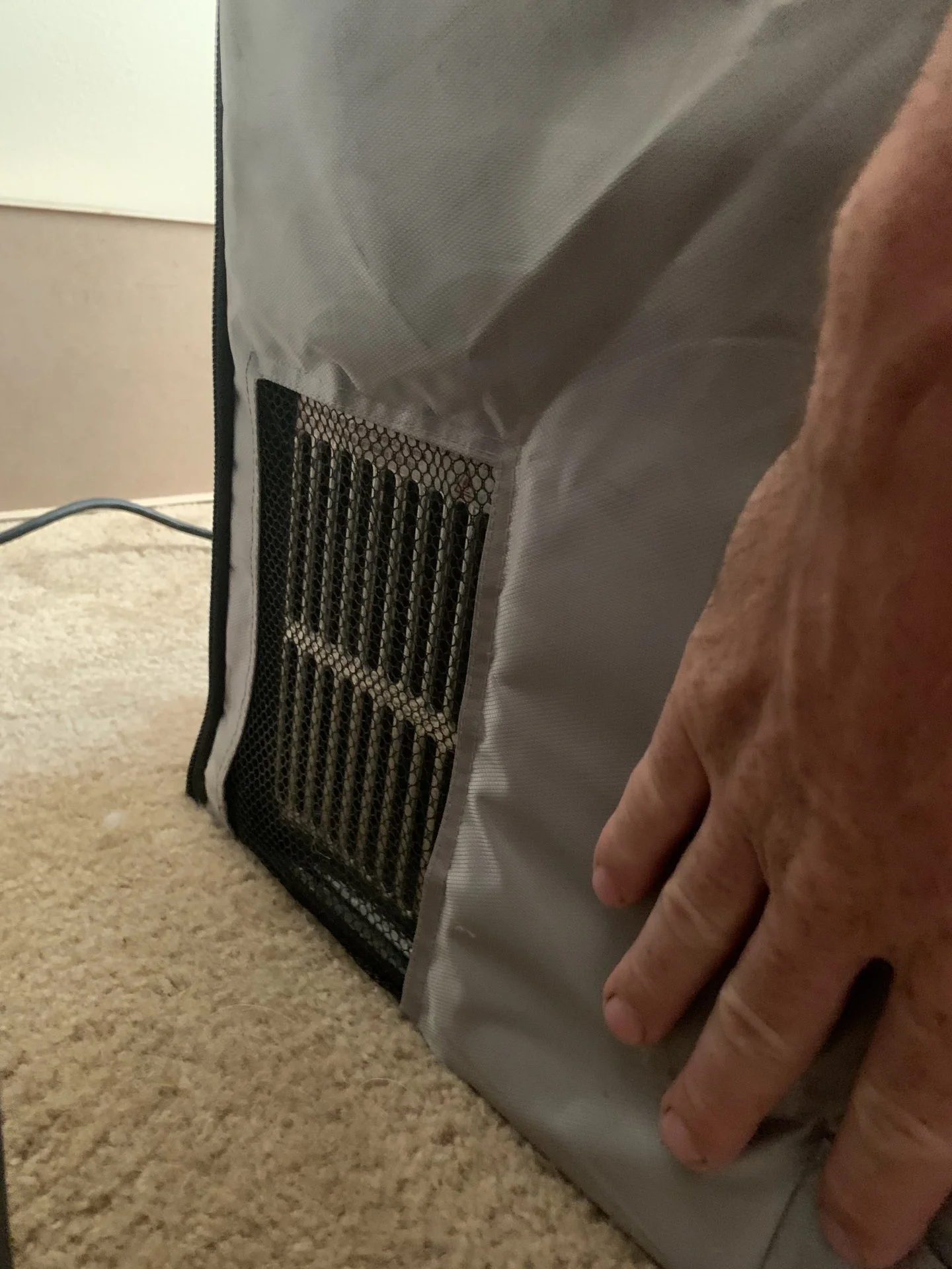

More vent pictures. I might give Jason a ring at ozark overland and see what he says. I got my fridge and most of my stuff from him.

Hard to tell from your pics but is your compressor, fan and vents facing the 2nd row seat? If so, trying flipping the fridge so those components are nearest the tailgate for better ventilation. If it proves successful, then try and flip your hinges so the fridge opens up on the "correct" side.
That’s correct. The compressor side is near the second row. However the hinges will not swap on this fridge. Also the wiring plugs/ controls are at the rear near the compressor.

That seems kind of tight for spacing but not too far off from a lot of other installations I've seen. It sounds like you have good clearance in the back where the comp/vents/fans are. Honestly, I don't worry too much about any of that while traveling, I often have to stuff crap into every available nook and cranny. Once you're in camp, yeah, make sure you have all the space for good circulation you can get. I don't stress too much about this sort of thing. Or much of anything else for that matter.

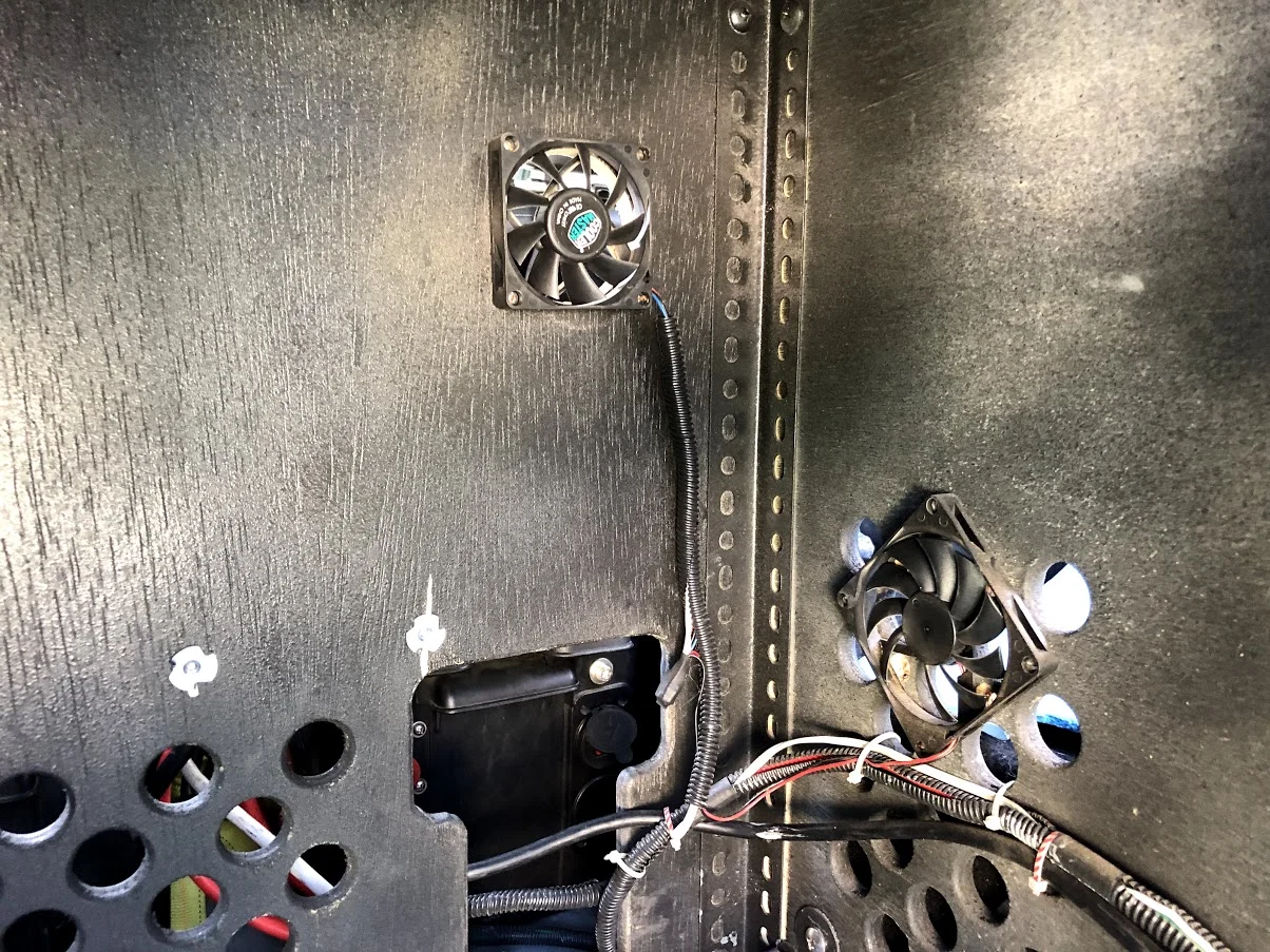

The vent holes aren't enough to keep the air around the fridge cool. I have about the same amount of space around my fridge and added a couple of computer fans to help exhaust the hot air out of the fridge cabinet. They are powered by the same circuit as the cooling fan in the fridge so they all turn on at the same time. Figure out which vent on the fridge is blowing out air and put the largest fan possible right next to it. If you can't do that then try and pull the air near the top away from any other openings.
Also, I'm not fully convinced that the fridge covers are helping any, especially if the fridge is already stored inside another box. They may actually be doing more harm than good by trapping the heat.

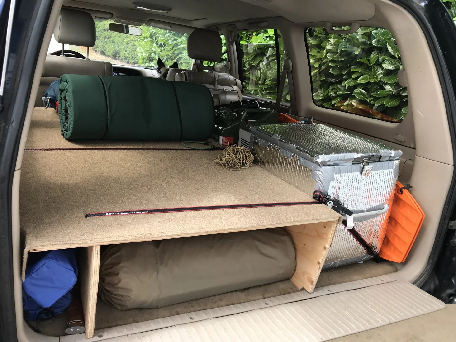

This is how I have an old (20 years old?) NorCold 12V frig in my UZJ100 desert exploring rig. It is hard wired to the starting battery with heavy gauge cable.
