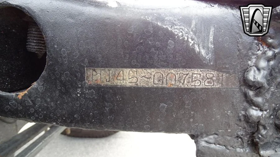

Thought y'all would enjoy seeing some expert frame welding. Question, what actually was welded here? I belong to a female toyota FB group and a woman posted this truck and that her and her husband were flying to FL to take a look but they don't know much about them. I suggested she post here and see if anyone is available to look with them but then I glanced through the photos and saw this. And yeah.... I already told her the bezel is on upside down, hahaha! 1977 Toyota Land Cruiser Coral Springs, FL - https://www.hemmings.com/classifieds/listing/1977-toyota-land-cruiser-coral-springs-fl-2717976
Florida is 99% a South America HJ45. That kind of money and can't even get the bezel right. Going to speed $50K for a 45 wound go FJ45 and look in the Middle East for a 8/80+ with a split transfer case. If the possible port buyer wants a diesel your limited unless you want a RHD from Australia. From what I read and discussed with a few Australians your better off with 2H if you want to add a turbo.
I'd guess that the welding is just to repair some accident damage to the bumper mount and could easily be redone if so.

The bed looks twisted on photo 87 or so. Maybe just some mounting bushes lost but could be a twisted chassis.

Definitely junk

There is really so much shown that isn't just non original for a restoration, but sloppy work.
