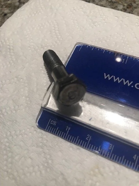

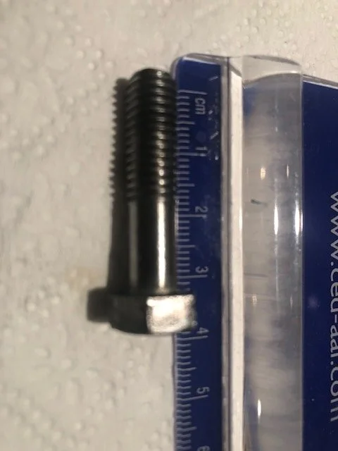

I've officially crossed over to the LV origonal/resto dark side! Deciding to restore and electro-plate all my original hardware put me over the edge. Presently trying to locate a M8x32mm fuel pump bolt - see pics - with #5 on non-indented head. Would love to bundle this with a a coffee can full of LV hardware, so if you're holding let me know. I've discovered that most of the bolts on my LV do not have the indented head, but I'm not sure if this is an "early" thing or an "LV" thing (if you know please share). Happy to plate some hardware for you in exchange. Thanks
