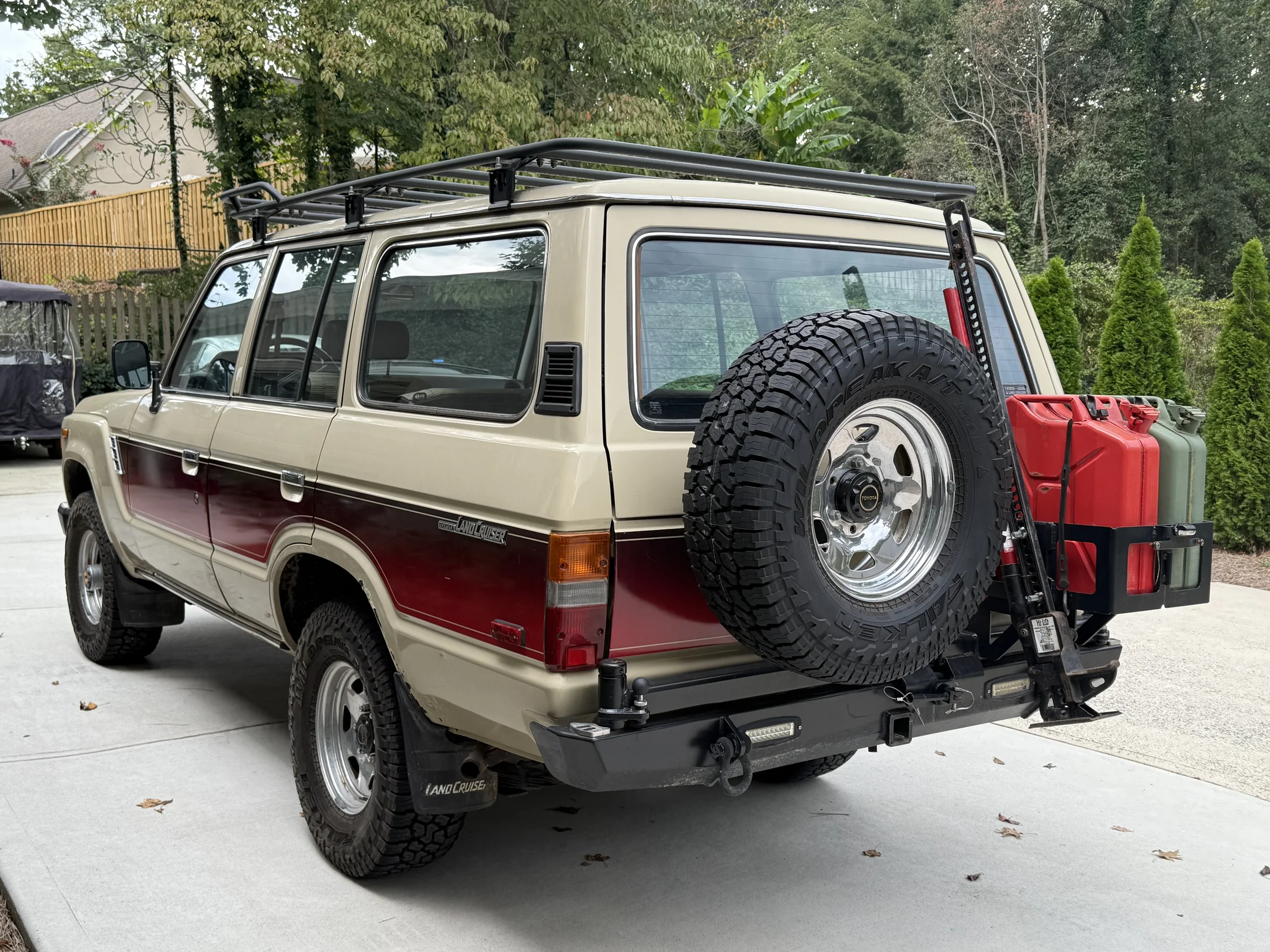

Picked this one up locally today, I'm pretty excited about it.

Probably most important priority right now- the swing-outs on that rear bumper are almost completely seized and I can't get the tailgate open without a LOT of effort. I need to grease the joints and maybe replace some bearings but I can't figure out how to get the stupid caps off the top.
Looks like you have 4+ bumper - email them and they can likely send you instructions on how to access (some folks have done that). Or you can drill and tap and create your own grease zerks. I need to do that myself…
Thank you. I've spent a couple hours today trying to get those arms off of the 4+ bumper and I've struck out. No combination of penetrating oil, heat, pry bars, big hammers, etc. can get them off there. I took the caps off and I'm just looking at a brass bushing inside of the arm sleeve, which rotate around a spindle. I'm assuming I have to get the assembly to go straight up off of the spindle? I'll call them or e-mail them.

Thanks everyone. I went to the tag office yesterday and the VIN is indeed clear, so I got a clean title on it (and apparently a pretty good deal). We have ad valorem tax in GA where they tax you at purchase based on the value of the vehicle. He didn’t know what to do with such an old car so he taxed me… $1. I was also (finally) succesful at getting the swing arms off the bumper, thanks to my other thread. The roof rack is very nice, super stable.
