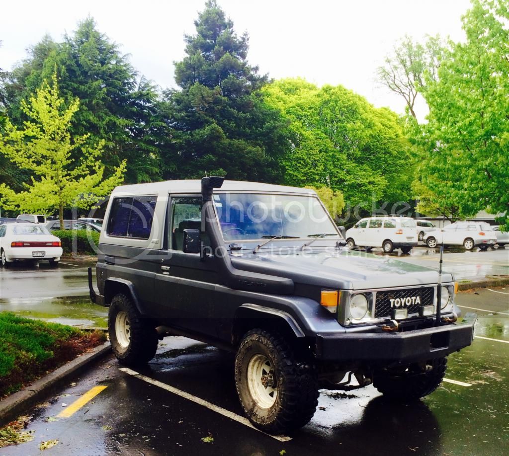

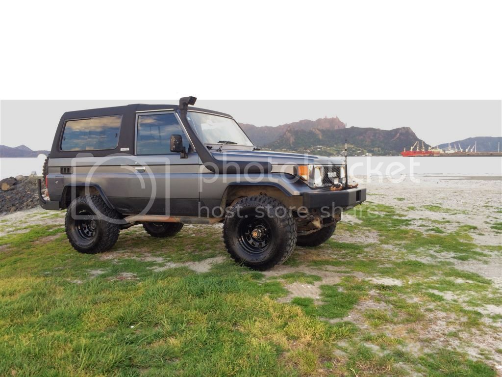

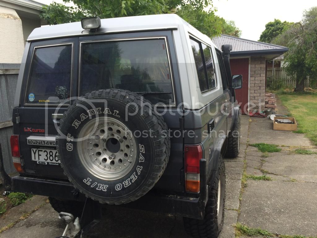

Hi
I am Andrew from New Zealand and after roaming the forum for a while and doing a bit of work on my Bj74 over the summer period I thought it would be best to start a build thread.
This is my JDM imported 1987 BJ74 Landcruiser. Modifications thus far are:
- 15BT 16v Motor Conversion
- Front and Rear Bars (need a winch :)
- Safari Snorkel + Diff breathers
- 2.5 inch suspension lift + Rancho 9000 shocks
- ARB Rear Air Locker
- LSD Front Diff
- 33 x 12.5 15 Achilles XMT Tyres
- 15 x 8 D window rims

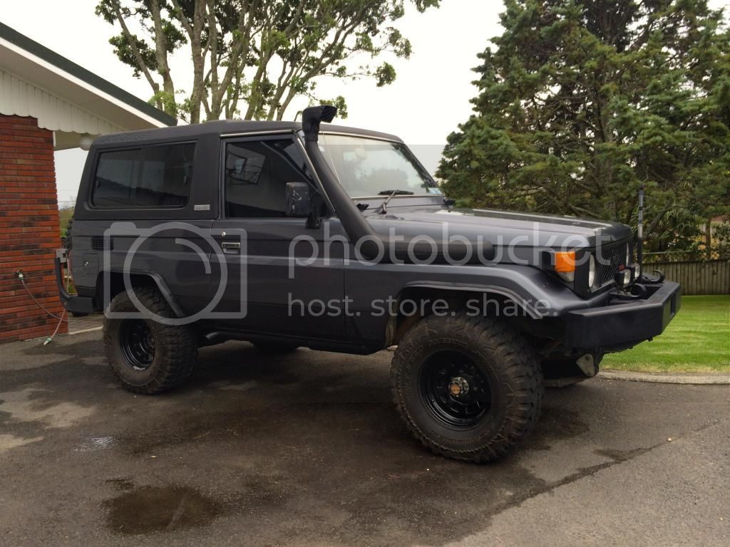

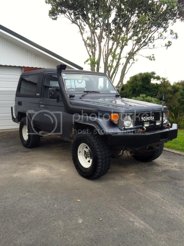

The truck has just came back from the panel beaters today after rust work on the rear drivers guard, it is now looking in top condition. I have a lot more work to do and any advice would be much appreciated.
Cheers

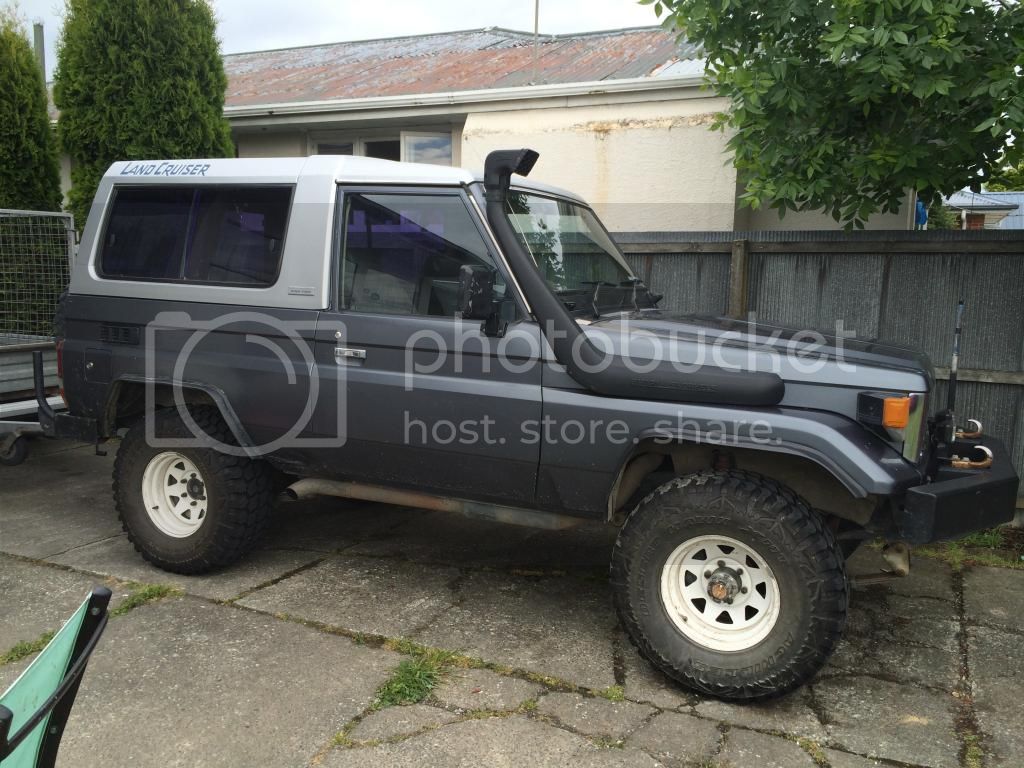

A couple months ago
a couple weeks ago (black wrapped FRP and 3M tints)

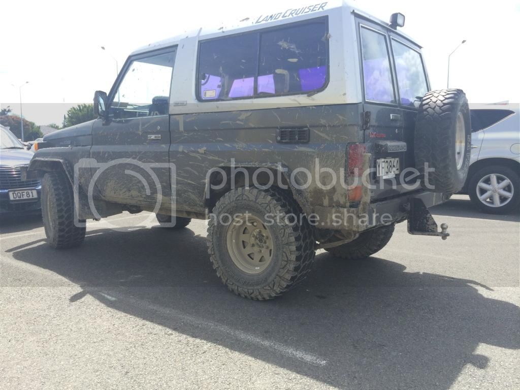

New Rims + Full Sized 33 inch Spare

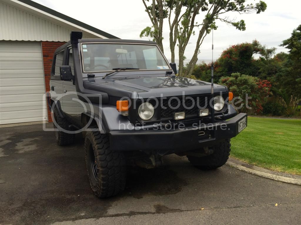

Current Condition with Black Grill (post panel beater)

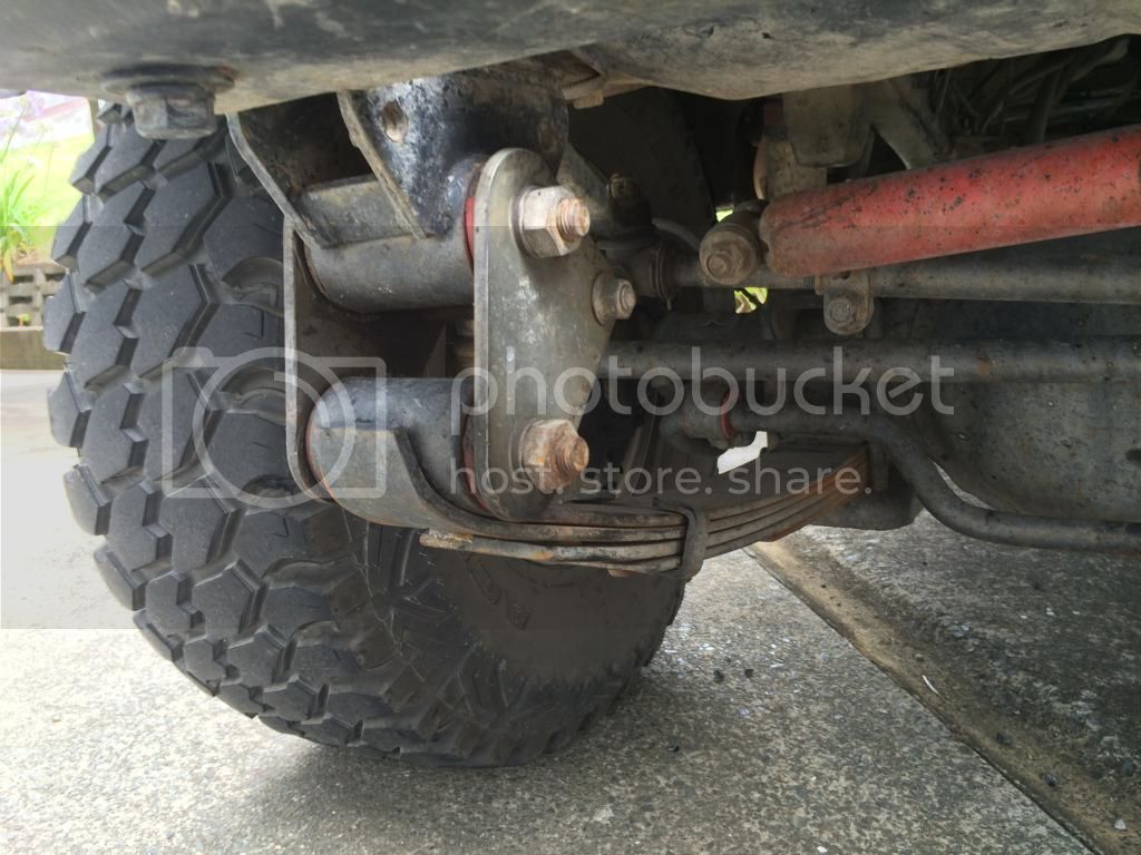

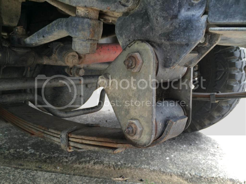

Looking at running 15w40 engine oil (the truck will range from 20-25 degrees down to 4-5 degrees in winter), Redline MT-90 gearbox oil (great stuff! I have used it before in other vehicles), both diff oils are being done, can anyone recommend oil to use in the rear diff with the ARB air locker???

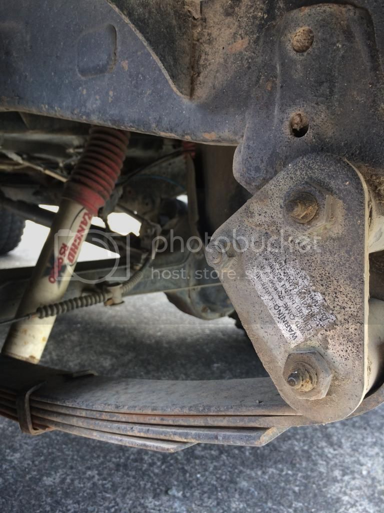

Finally I am redoing my suspension bushes as they are a bit shagged. I had a good look under the truck and see it is using an OME lifted springs and Rancho 9000 shocks. I am not positive on the lift (2 inch vs 2.5 inch) the guard to center of the hub is 535mm. Would be good to know so I can determine what degree castor wedges to use....? o_O
Can anyone confirm that the bush kit im after is OMESB1, or has anyone had better results with another brand?

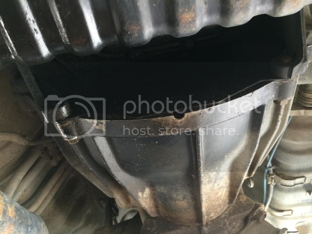

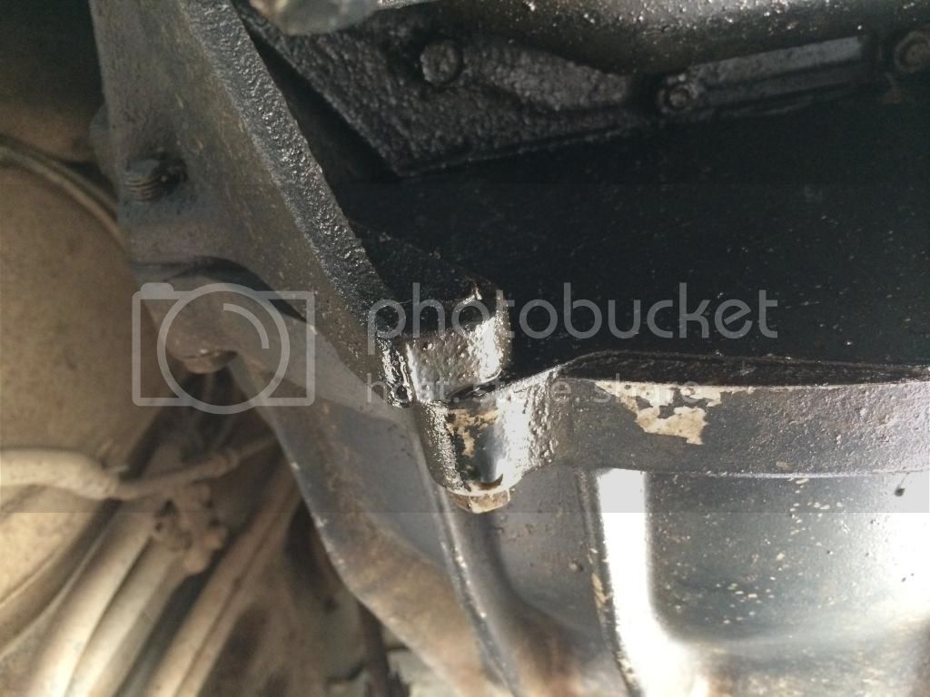

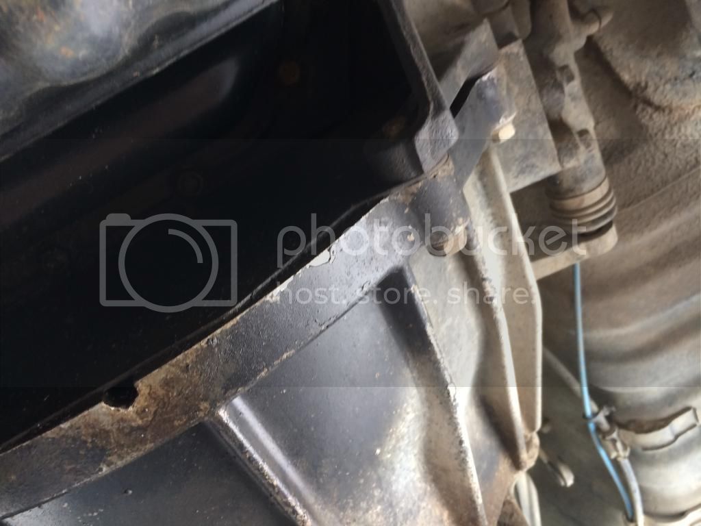

I also found i have an oil leak when under the truck today. It is located on the front of the bell housing on the right hand side. There is oil residue on the back of the sump but looks old, thick and dried from the drive shaft..... :(
Cheers
Andrew
Looks like you've got classic rear main seal leak. So common it aint funny. Next time you get your clutch done etc make sure you get it replaced.
