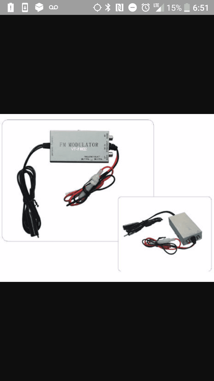

You guys need this. It's called a FM modulator. You have to gain access the back of your radio. Pull out your antenna wire & plug this in between. Run the rca jacks from the output audio of whatever device you using into the modulator. Tune your radio to 89.3 & you got sound.
Thanks @silverbullit, but the RES has the FM modulator built in. Works fine if you read the owner's manual, so no need for aftermarket.
Mine is stock all around as far as I know and I get the sound on 89.something.
What if we have an aftermarket double din headunit? Would the modulator still work?
Yes, you simply unplug your antenna and plug this in between & plug your antenna back up. Give it power from your cigarette lighter. You good to go
