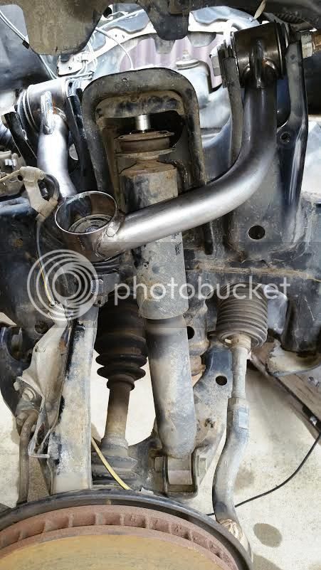

We have had many issues with many brands here with our heavy trucks and rough roads, and what we found with TC is when you go more droop the hi mis spacers hit the cups, so when accelerating hard and the front lifts makes for bad noises. The uniballs last about as long as the SPC ones, which isnt really an option here as 1 trip can be more than the life of the parts.
TC also tend to offer only around 2 degree correction.
The other problem is not enough clearance for extra droop, we run up to 475mm [18.7"] long front set up for extra droop and a 3" lift, with a 2.5" shock, none of the other arms work.
And the other problem they all have is tyres hitting the front of the arm on the lock.
We have been making these for FJ and 200 for some time, and just finished prototyping the 100 ones yesterday with reprofiled front for bigger tyres, more clearance, and a true 3 degree caster change straight up when bolted in, and they take your factory ball joint, with the cup angle changed to allow extra droop without binding, but keep the Toyota longevity.
Making our own was the only way to overcome all the short falls of the others for us. [raw beta set for pre production]
We have a cap to cover where the ball joint goes in once installed as well.
