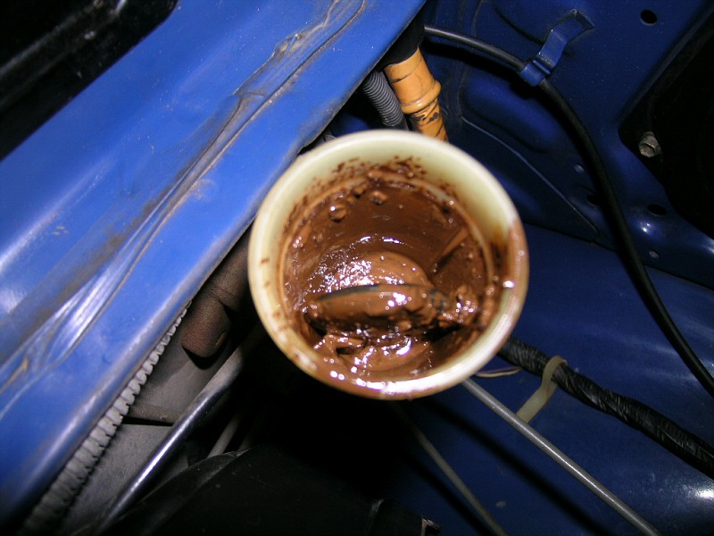

So, bet ya didnt know that if you don't flush you clutch fluid regularly it turns into almost a jello-y consistency goop full of dirt and moisture, did ya?
Did you also consider that it will make the clutch slave cylinder piston not return fully, causing your clutch release fork to drag on your throwout bearing and sounds a lot like a pilot or input shaft bearing getting ready to fail?

Wristy, thanks for fielding the stupid question I knew the answer to but needed to be sure of. LOL's that it might not have been as bad as I thought. I'll give it a week to see if it was indeed the fix, either way, after all my trips in and out of the desert and over the border, you'd think I'd have realized a lot sooner that even old(er) Toyota's still have clear fluid reservoirs.
