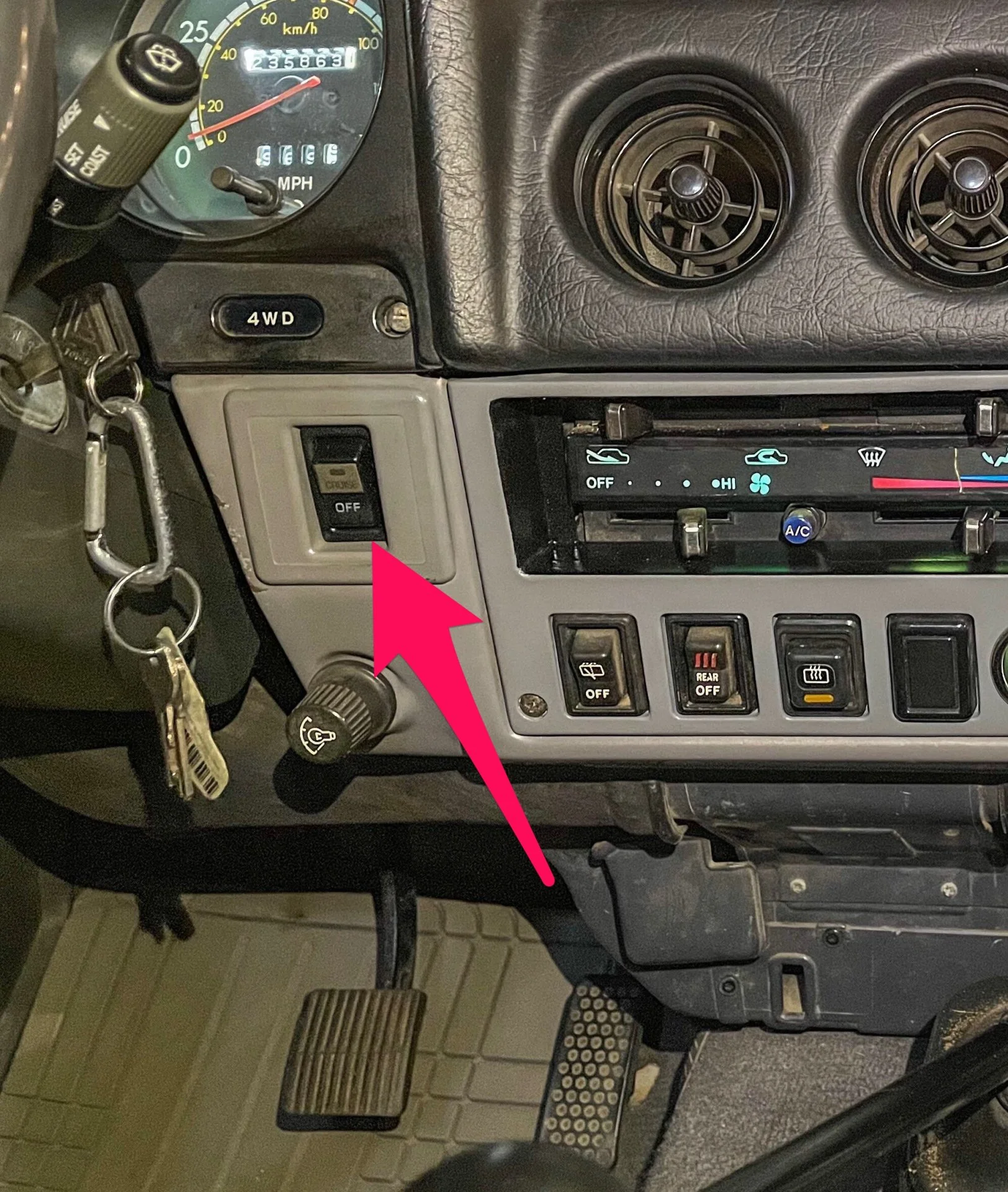

My 1985 was pre-wired. But '82 is probably a little early for that. I used the OEM switch. The wiring for that is below. You just need power and ground to the switch and two wires running from the switch to the antenna motor. The polarity is reversed for up vs. down.

i have a few FJ62 power antenna Up and down switches , but a FJ6O on is a UNICORN in a hay stack for sure !
The 62 power antenna switch is a perfect fit in the spot shown.

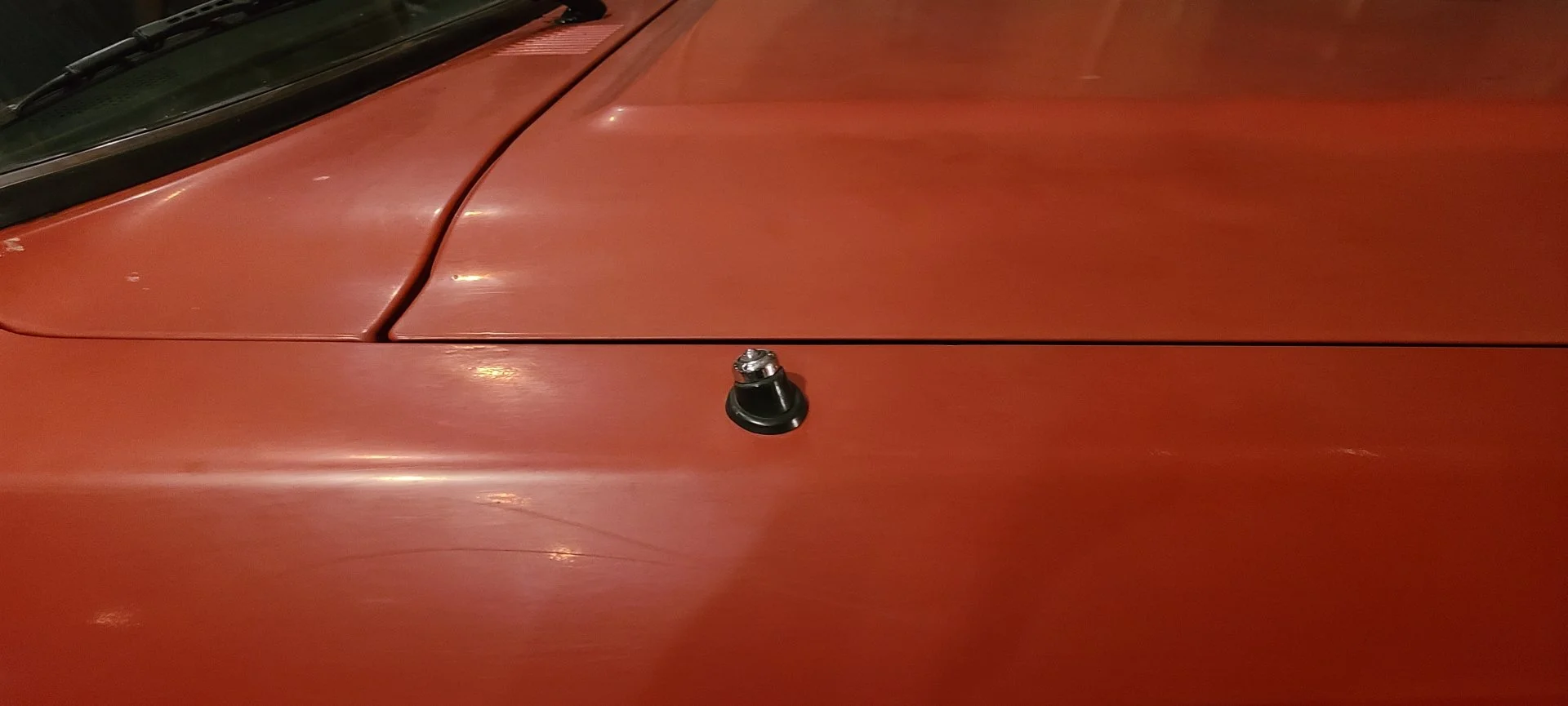

Did mine many years ago - with a 87' FJ60, everything was just a plug-in to the existing harness so pretty straight forward.
Looks and works very well -- whenever I am on the trail, I put it down.
