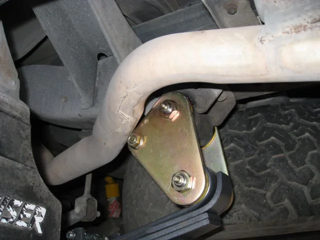

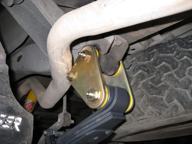

We managed to get most of the OME suspension kit in (only thing left is the steering stabilizer). I was curious if any other 62 owners encountered an issue with the muffler tail pipe. If you look at the pics, the shackle is touching the tail pipe. I'm pretty certain we have the shackle pointing the right way. Just curious if anyone else had this issue. :doh:

The spring will settle a bit and you will get some of you steering wheel alignment back.

The same goes for the rear. It will settle a bit and quit hitting your exhaust. Is the factory bracket that hold the end of the tail pipe on it or is it aftermarket?
That's good news...i hope it corrects itself somewhat cuz it's driving me nuts! I wasnt sure if the steering wheel could be fixed with messing with the TREs (which i'm dreading because they are old/worn and i know they need replacing but dont feel like messing with them after wasting 5 hours pounding the crap out of those old pins/bushings from the install!
As for the rear, it's the factory bracket holding the exhaust in place.

I just looked at the shackle on my 62. I have the same deal. I have a little more clearance between the pipe and shackle. Never had an issue with the shackle reversing and hitting the exhaust pipe. My exhaust may be a little beat up more than yours though. You could bend it out of the way a little yourself or let stumps, rocks, ect.. move yours like what happened to mine.

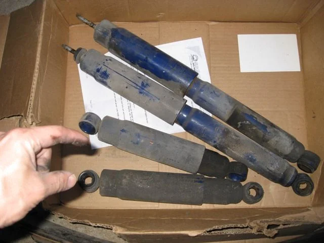

Sorry if this is a newb question, but what do you mean by "pop the wheel"? Also, thought you guys might find this quite funny but here is a pic of my old toyota shocks...Check out the rears! :D

On the exhaust/shackle interference...an exhaust shop should be able to fix that pretty easily.

My stock shocks were about the same. They didn't even return they just sat there compressed, in the box.
