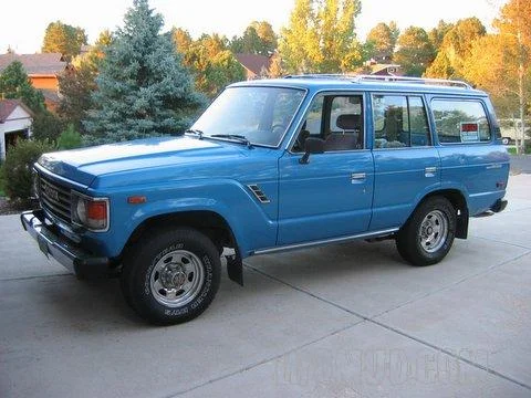

Here is a pic of the 60 I found for my brother in 2005 in Denver. It had (and still has) the OEM rack.

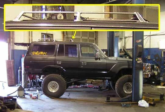

Is it me or do your OEM racks look lower profile than mine?
Your rack looks like it is higher profile and shorter than mine. It also looks sturdier. Mine looks like the other two. There doesn't appear to be a center support tower on the lower profile racks
