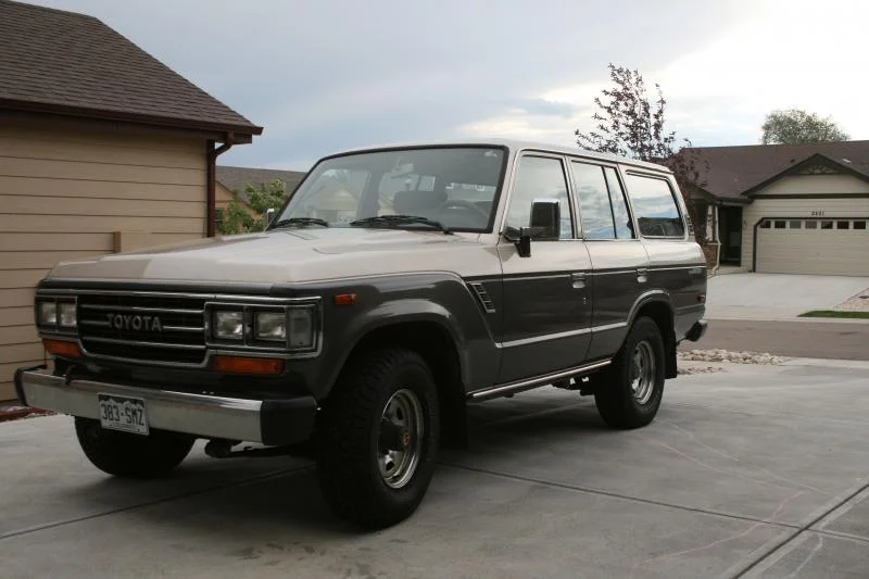

New Shaggin' Wagon
Here she is....
1990, 163K, Dealership maintained by PO - inside clean, no cracks on dash - few small dings on ext., no rust!
