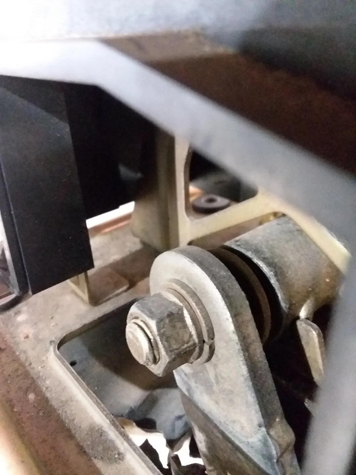

Have you opened up the neutral safety switch to clean it and make sure all of the connections are good? I wasn't getting rear reverse lights when I shifted into reverse and I found a thread describing how to fix that. Just make sure that if you open it up you don't lose any of the springs or nodes that are inside it.
Are your shifter bushing non existent? Along witj the grommets in the shifter linkage dryrooted? I would start in these area's first.

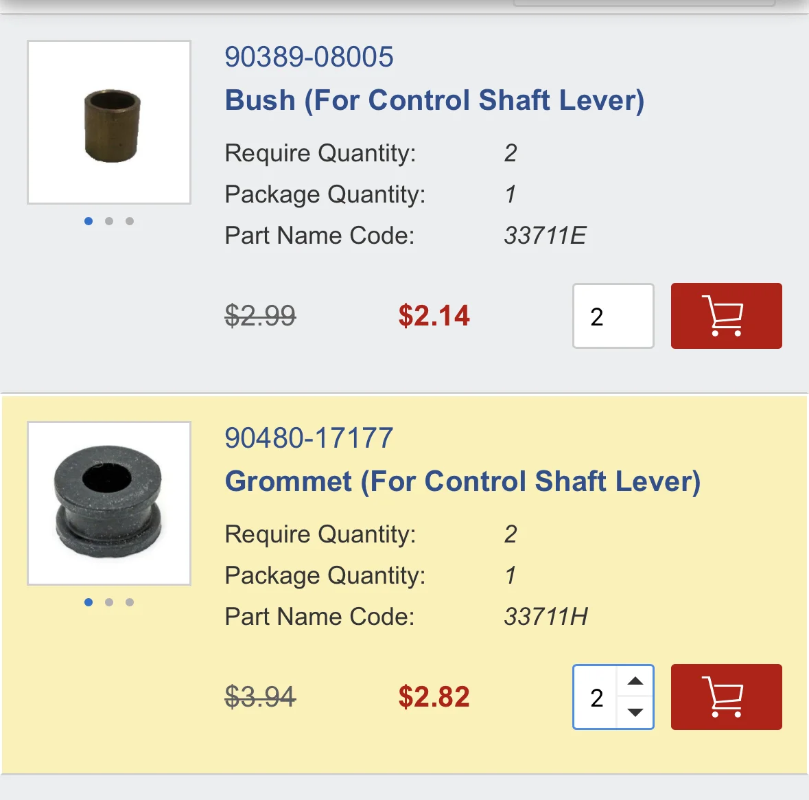

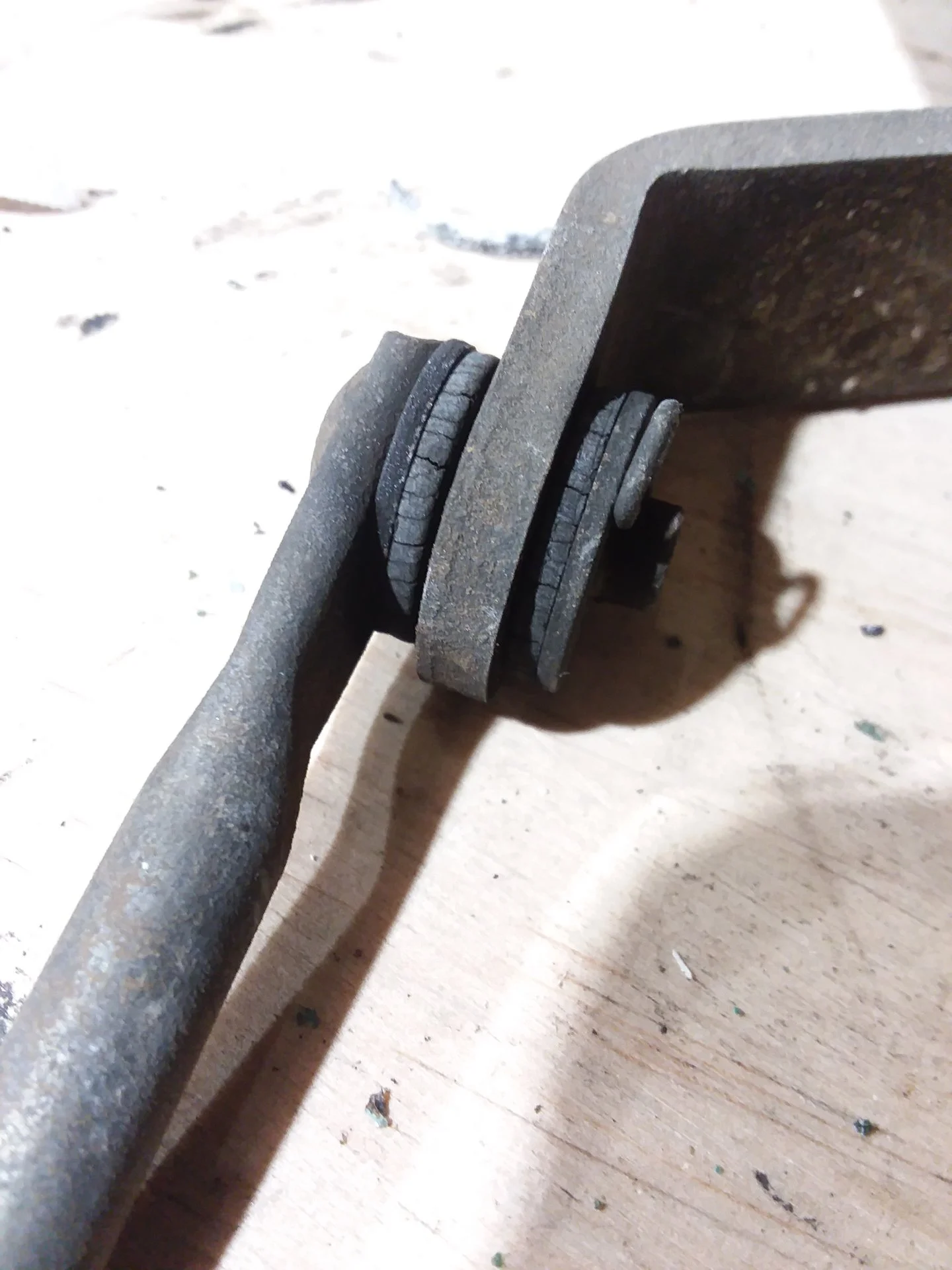

Can anyone confirm the part numbers and quantities for the bushings? I’ve already done the blue one but need to do the rest of them down the line. It looks like 2 each for these two parts. Is there a cotter pin that helps hold things together? Any change of that snapping and needing replacement too?

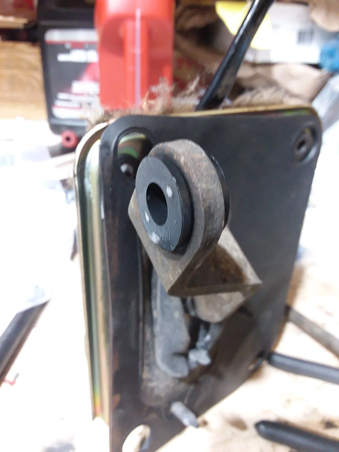

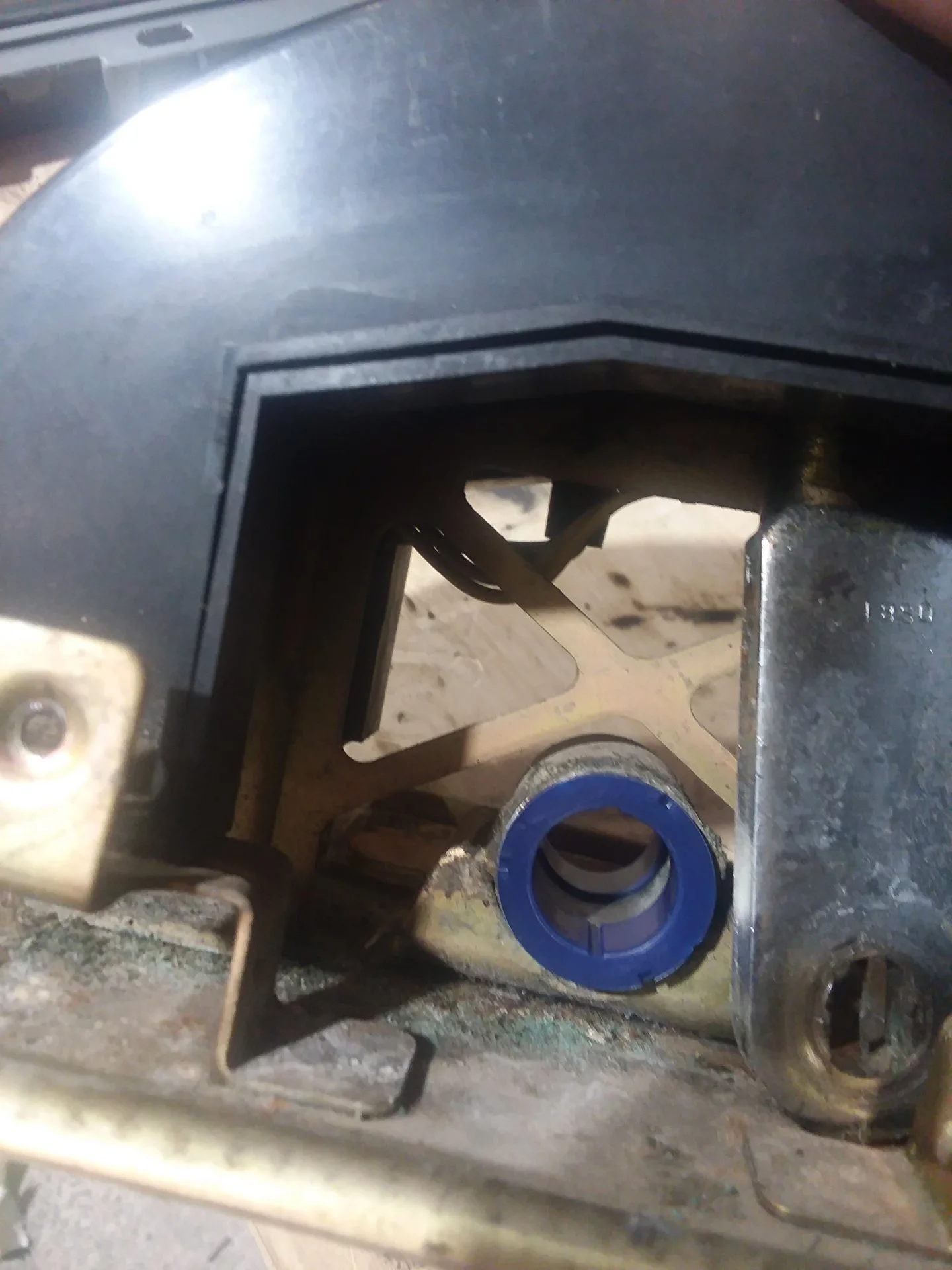

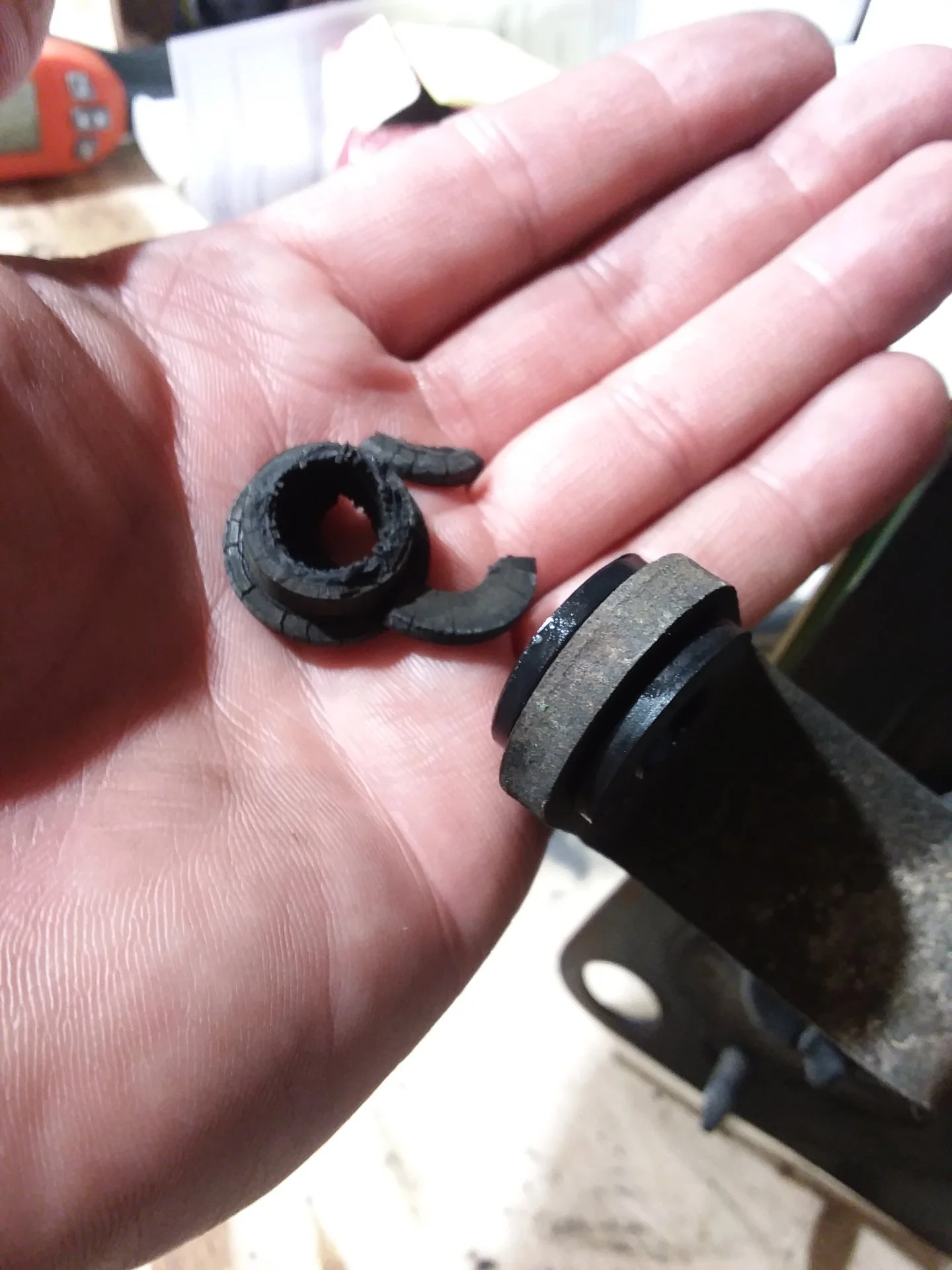

I have a similar wiggly shifter issue. We have replaced the bushings under the shift lever cover in the cab of the truck - how do I get to the other rubber grommets? from the cab under the shift trim or from below?
i think this is a better pic of that area?

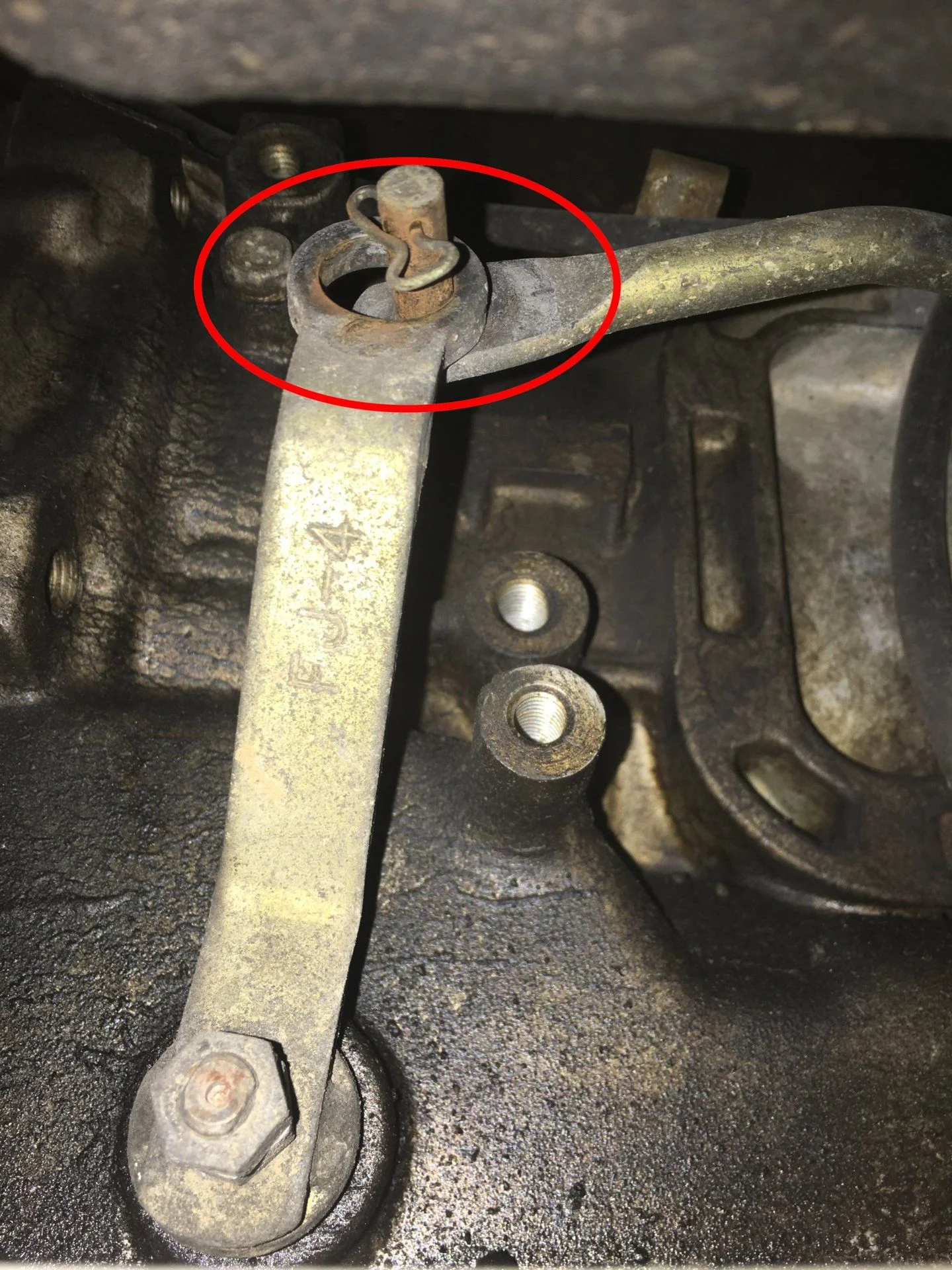

I have a similar wiggly shifter issue. We have replaced the bushings under the cover in the cab of the truck - how do I get to the other rubber grommets? from the cab under the shift trim or from below?
ok. went home and answered my own question. there are two of these grommets - one on either end of the linkage, along the driver's side of the transmission.
