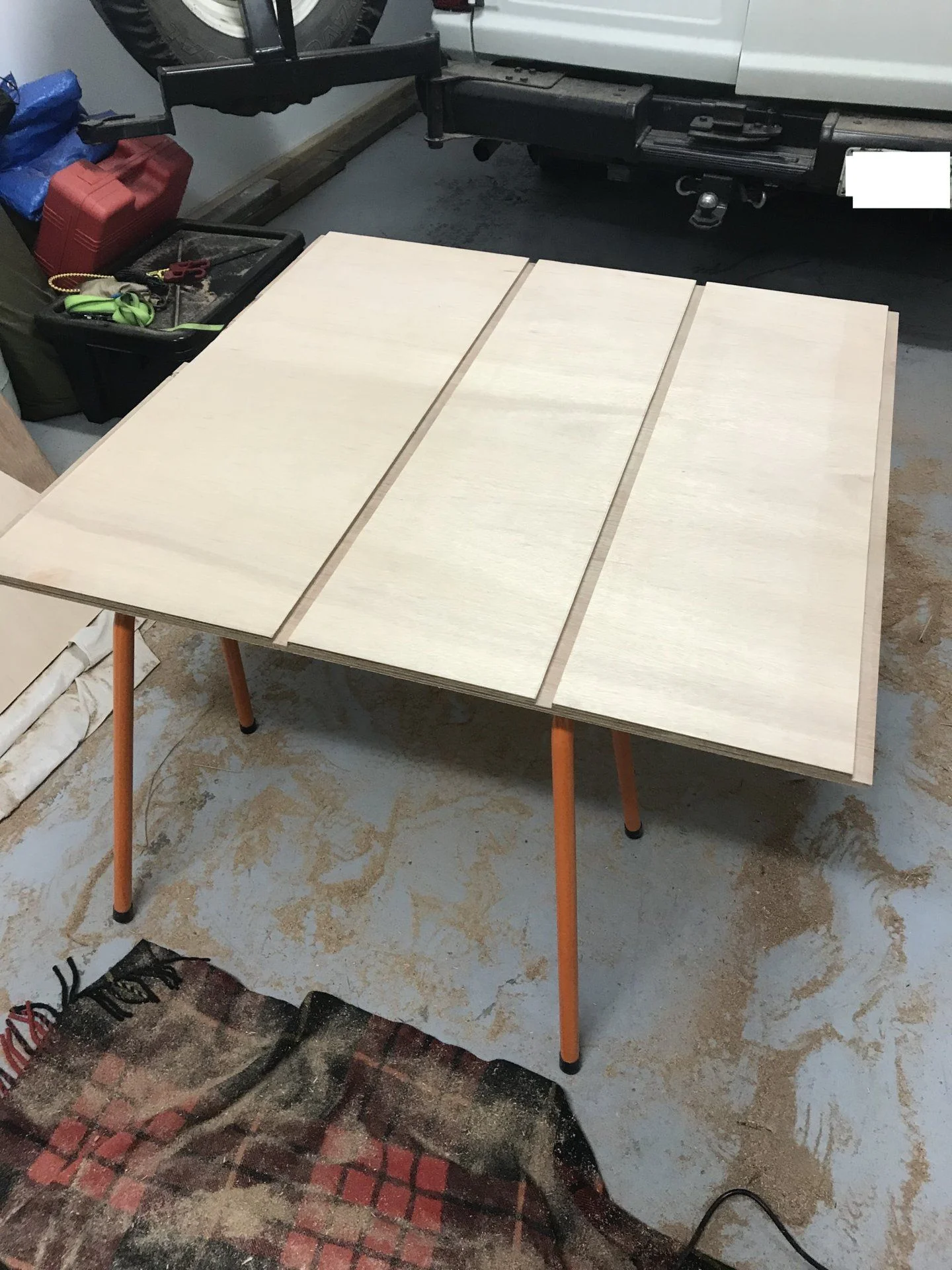

Decided to spend a little more and get marine ply all round, 1 sheet of 18mm for the base and main load bearing walls, then 2 sheets of 12mm for the drawers/everything else.

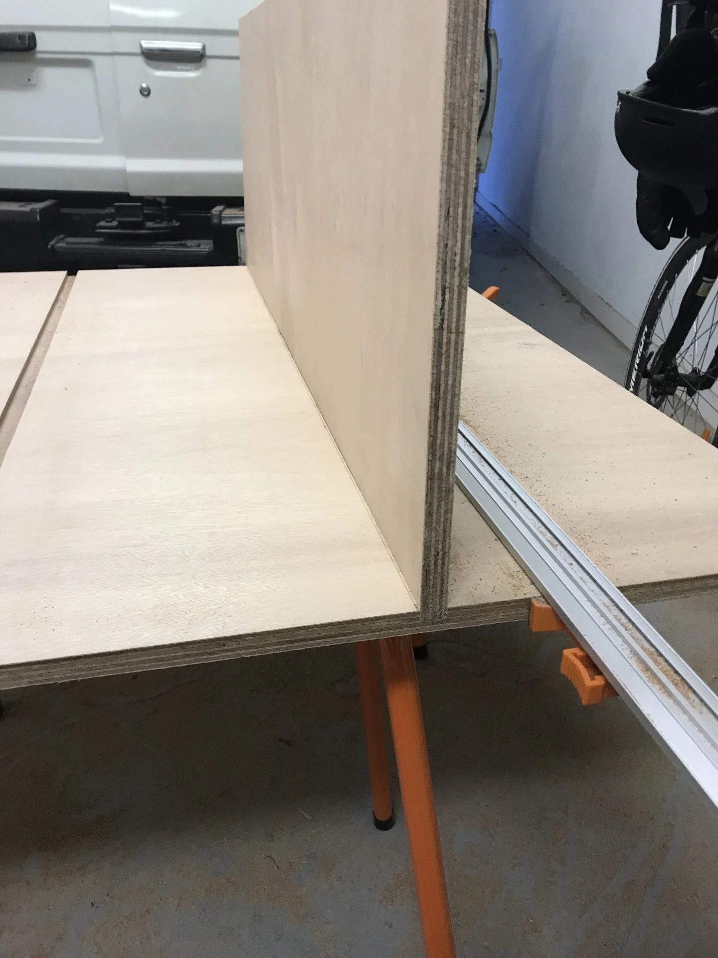

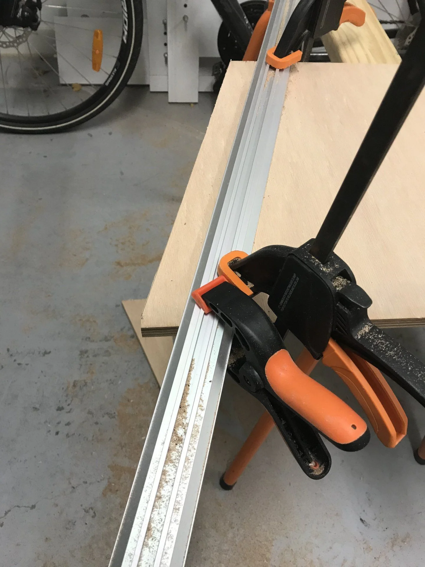

Day one was a bit short after getting everything, but got the base cut to size and routed for the 4 walls. All four walls cut as well and fitting snug. I cut the back parts of the walls on a slight angle to account for angle of the rear seat, doesn't line up perfect but should allow the drawer slides to fit in easily at the bottom later on.
