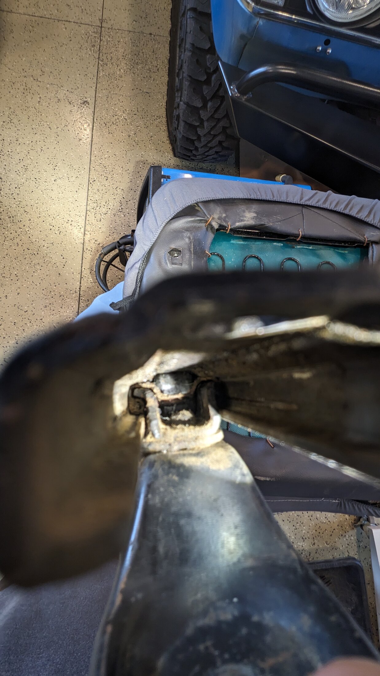

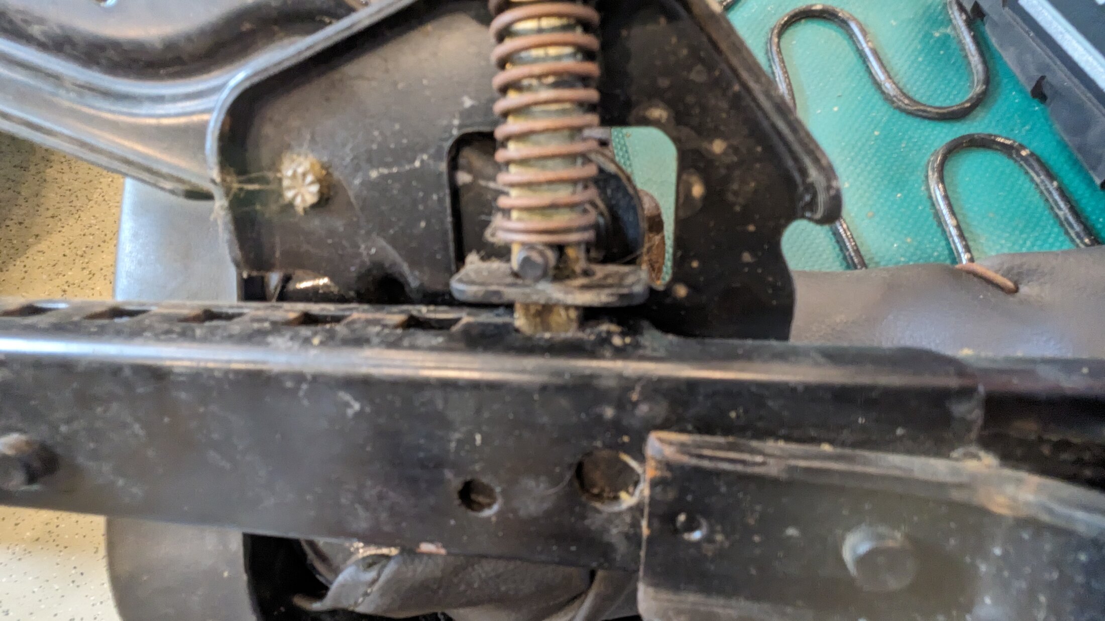

@dbbowen are you talking about the seat front to back adjuster? Finally getting eyes on mine, passenger seat rattles and moves when no one in it. There is lots of play in the furthest back position for the seat because It probably spent most of his life there. I think the rectangular lock hole is worn. If I move it one click forwards It's tight and closer towards the front it's really tight! So the pin is not worn but the hole is. Other than welding and trying to file it back out so everything is tight, I may just leave it one click forwards from full back at this point. Still thinking I might just tack weld the rails deleting the adjustment feature?
Other than that I took a pic of the rollers inside the two slides.
Other than that I took a pic of the rollers inside the two slides. View attachment 3715047View attachment 3715048
On mine there was this little pin. Like 1-2 mm that went up through a hole in the sliders thats what was causing the movement on mine
