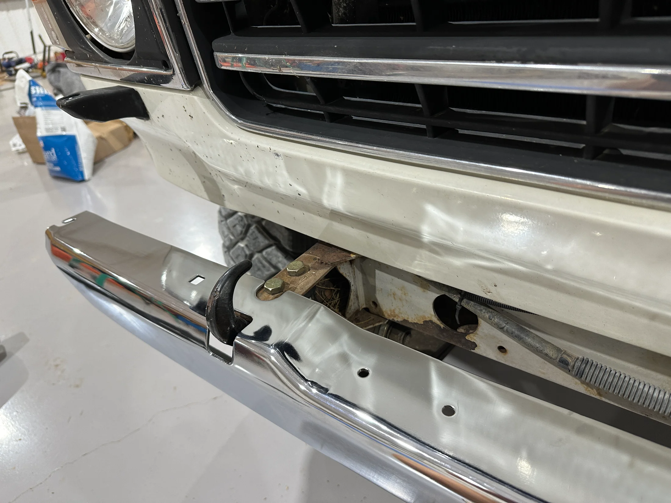

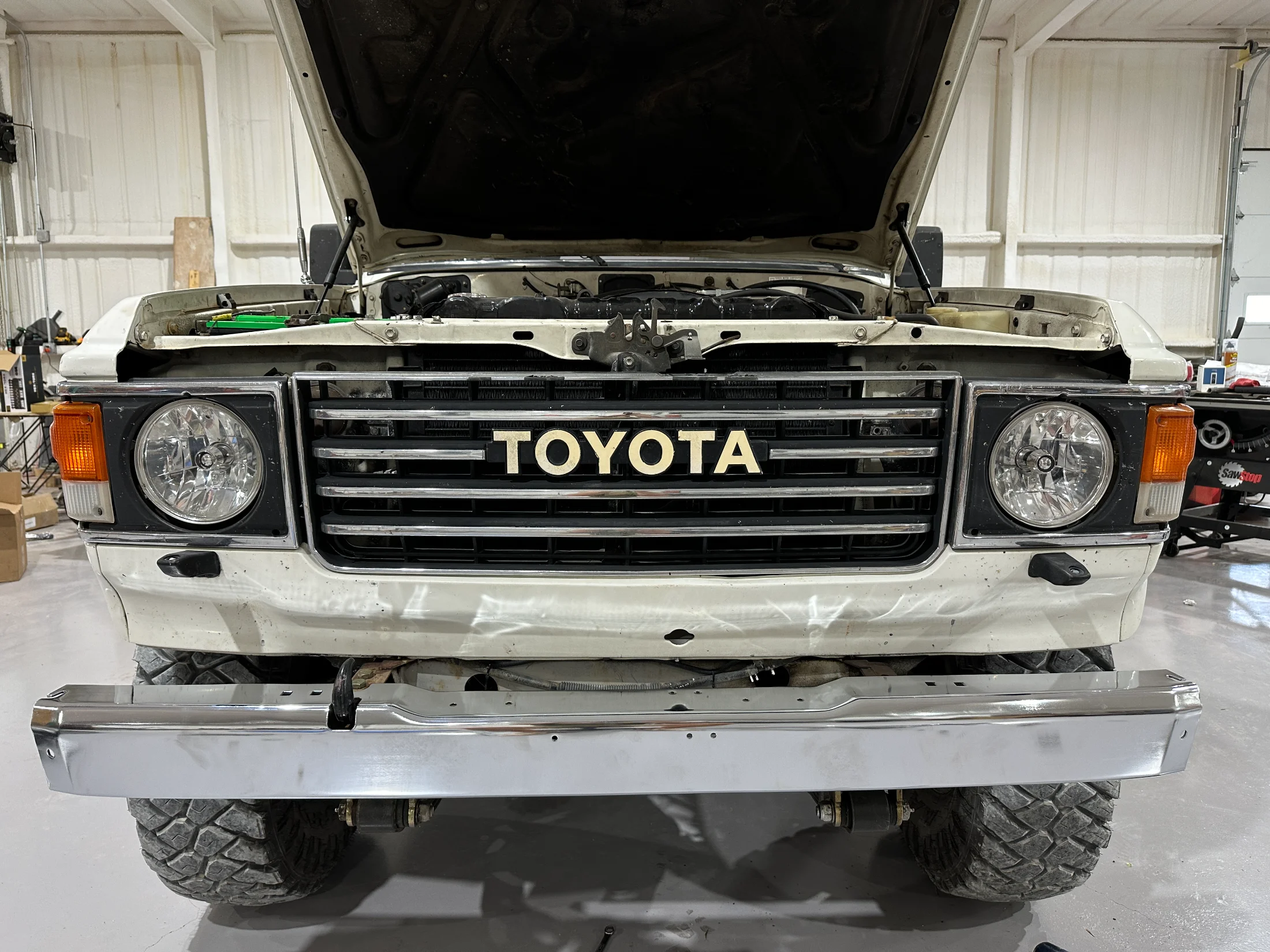

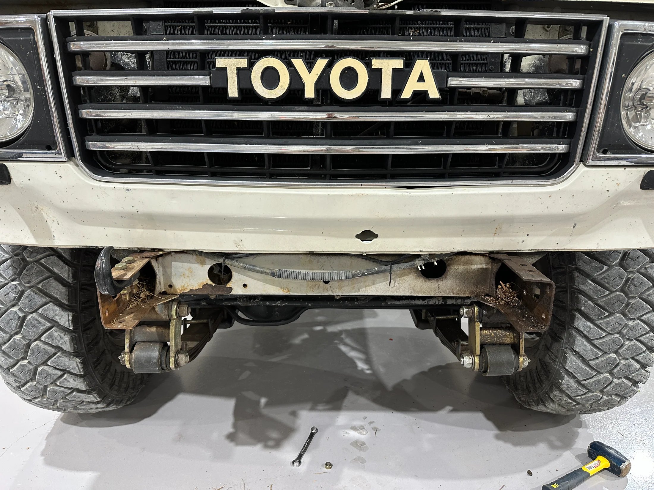

I'm in the process of removing the aftermarket bumper and installing the OEM one. I've ordered the face bar mount brackets, but even with those this bumper seems to be sticking out quite a bit and also seems low. I'm wondering if my FJ60 had the factory winch installed and I need the other bumper? How would I be able to tell that? Any ideas?
You are missing the factory bumper brackets that would have been riveted to the frame. See this thread below.
I ordered those and after seeing that thread, this may fix the issue. Thank You.
