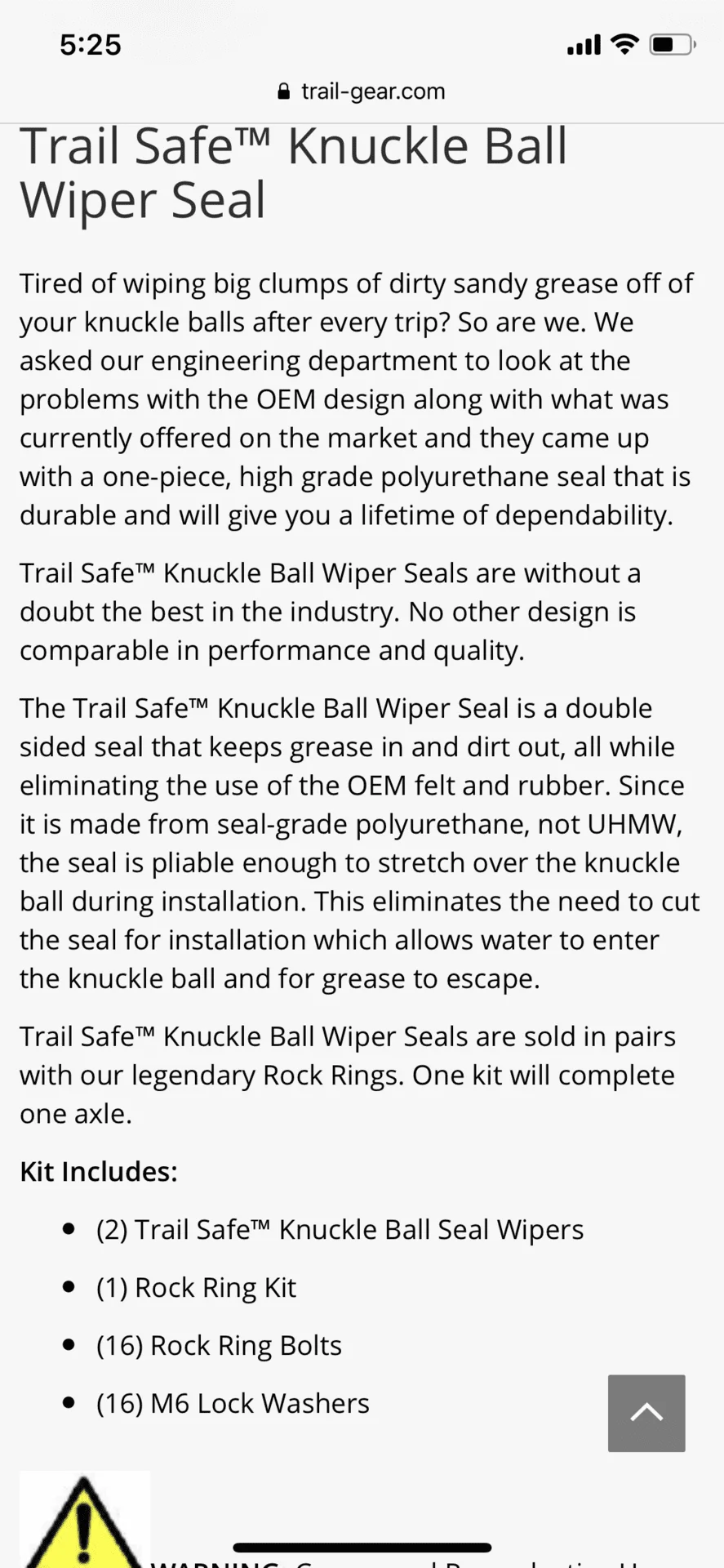

Trail Gear has a replacement for the felt seal that came with my kit. This came complete in my kit but here it is separate.

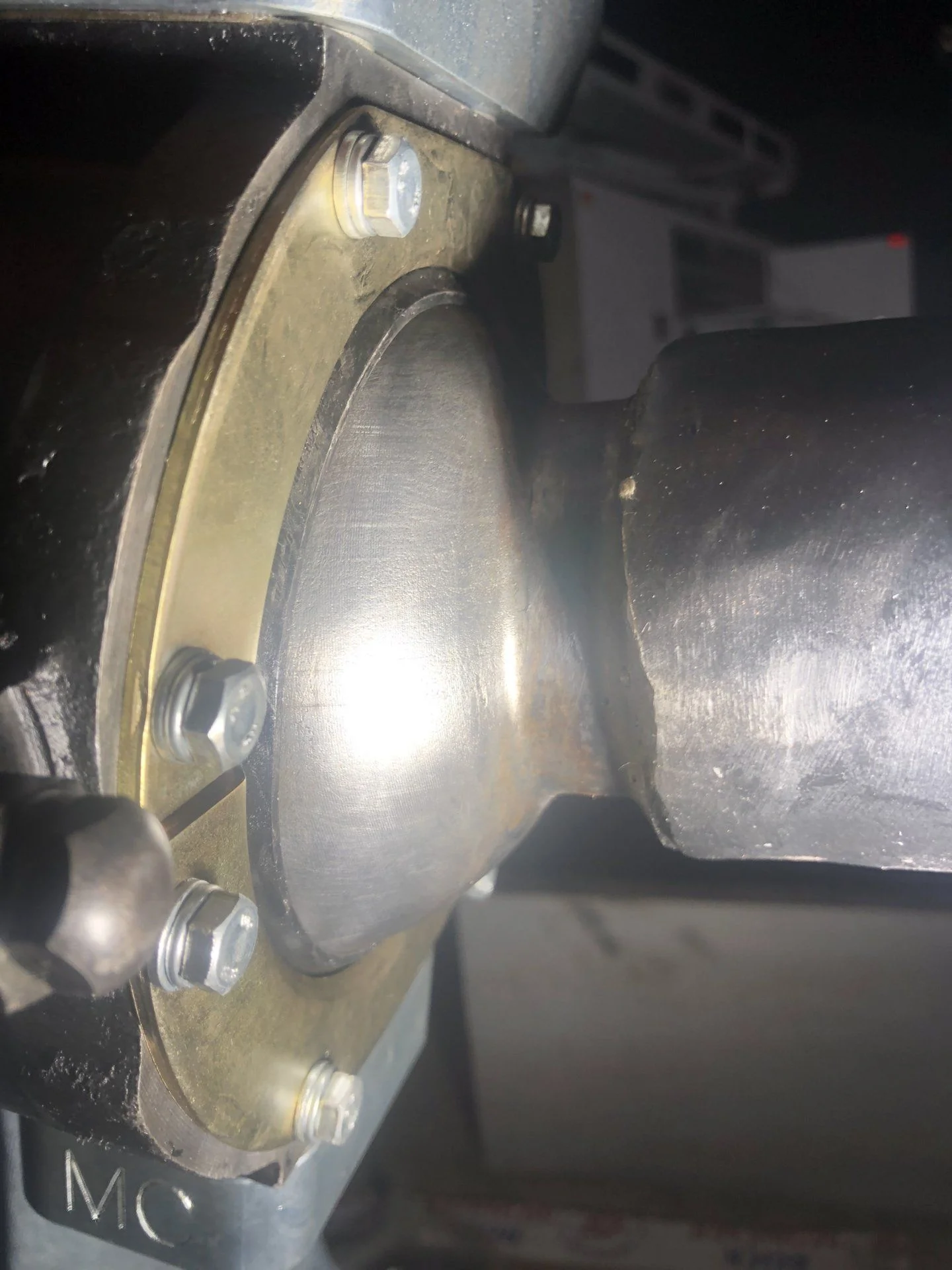

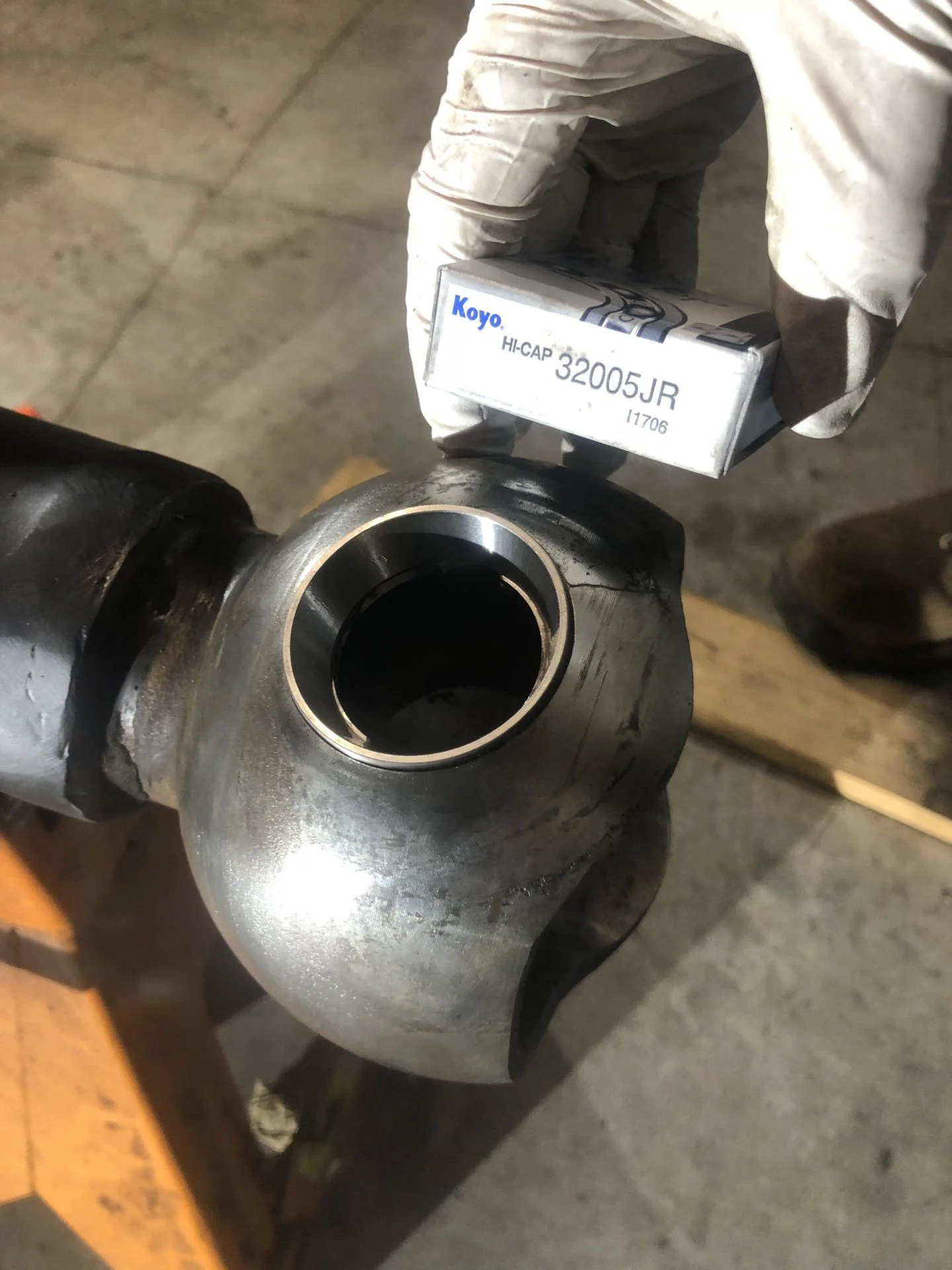

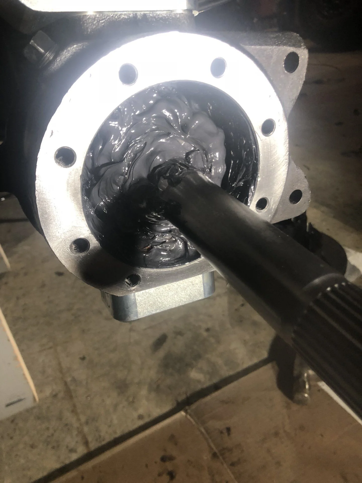

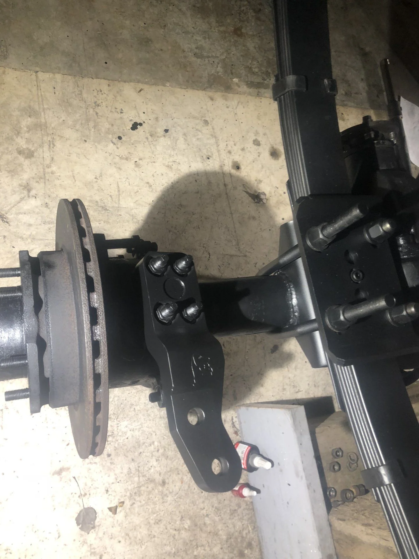

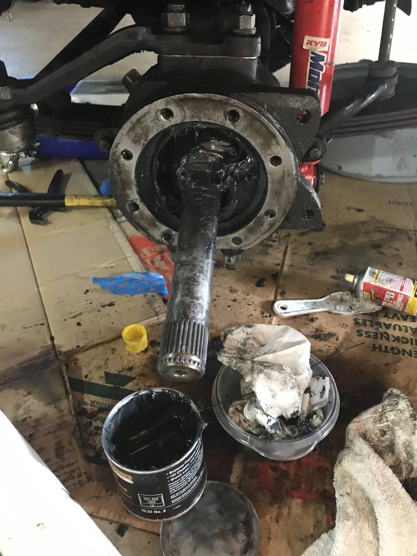

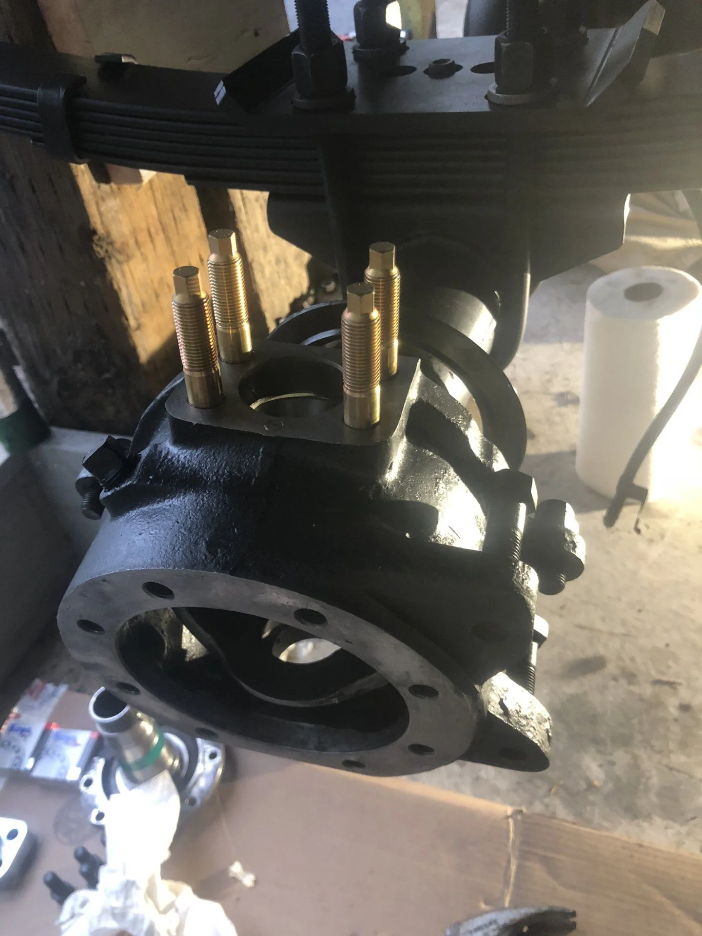

Here’s my knuckle rebuild pictures from my build thread.
ARP studs
Trail Gear knuckle rebuild kit,
Trail Gear chromoly birfield and axle shaft
Marlin Crawler High Steer Kit.
Also if you bend the circular metal seal... god I can’t remember the name, knuckle wiper something or other. I can find it tmrw, you can get it from Napa for $20 something each as opposed to $50 something from Toyota.

Also Napa has a chassis and bearing grease that comes in a huge tub. I took the advice of a well known mudder who uses it for all instead of buying separate types and went w/ it too.

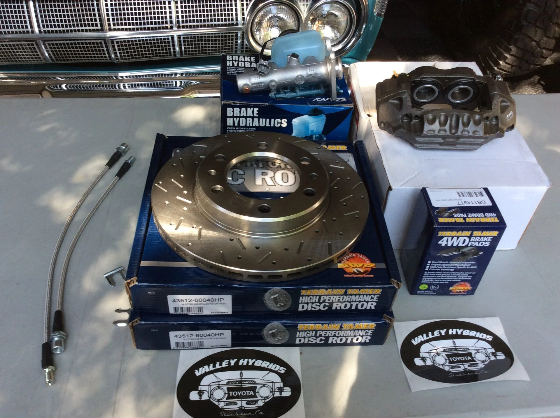

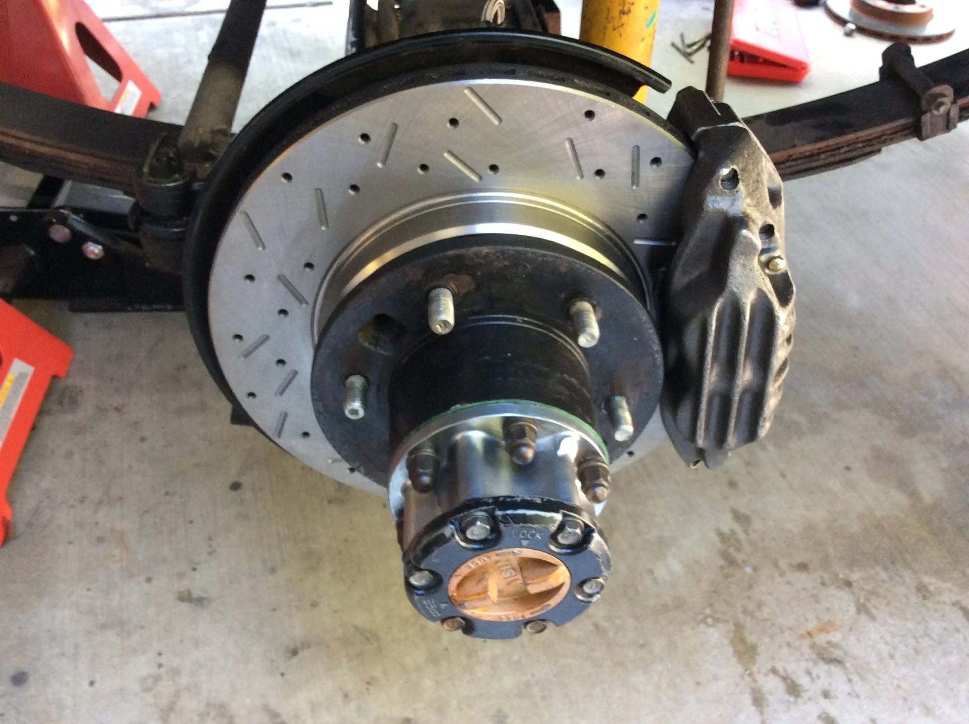

Give Georg from Valley Hybrids a call, he’s in Stockton Ca. He’ll have all you parts necessary good time to upgrade brakes while your at it.
