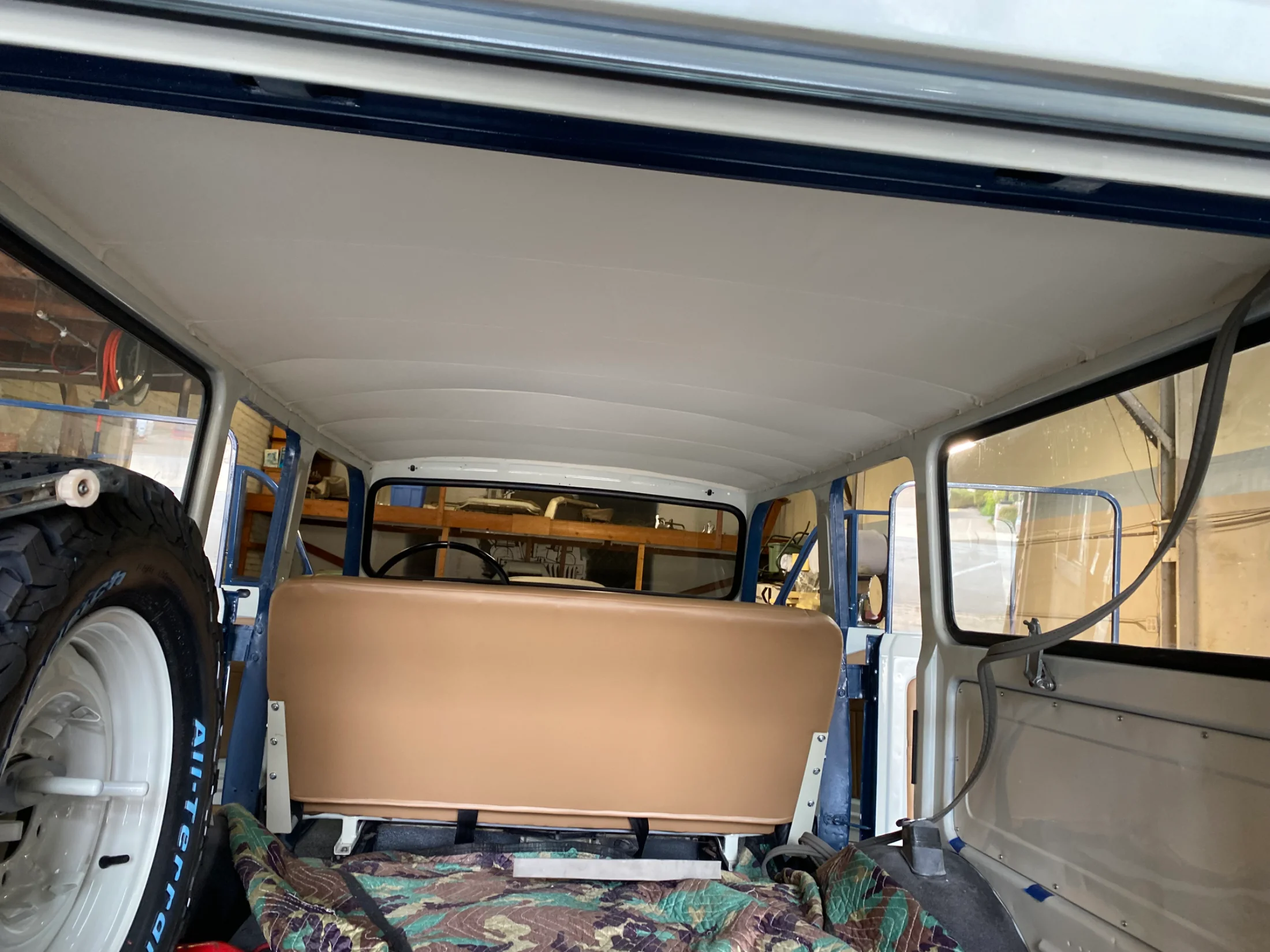

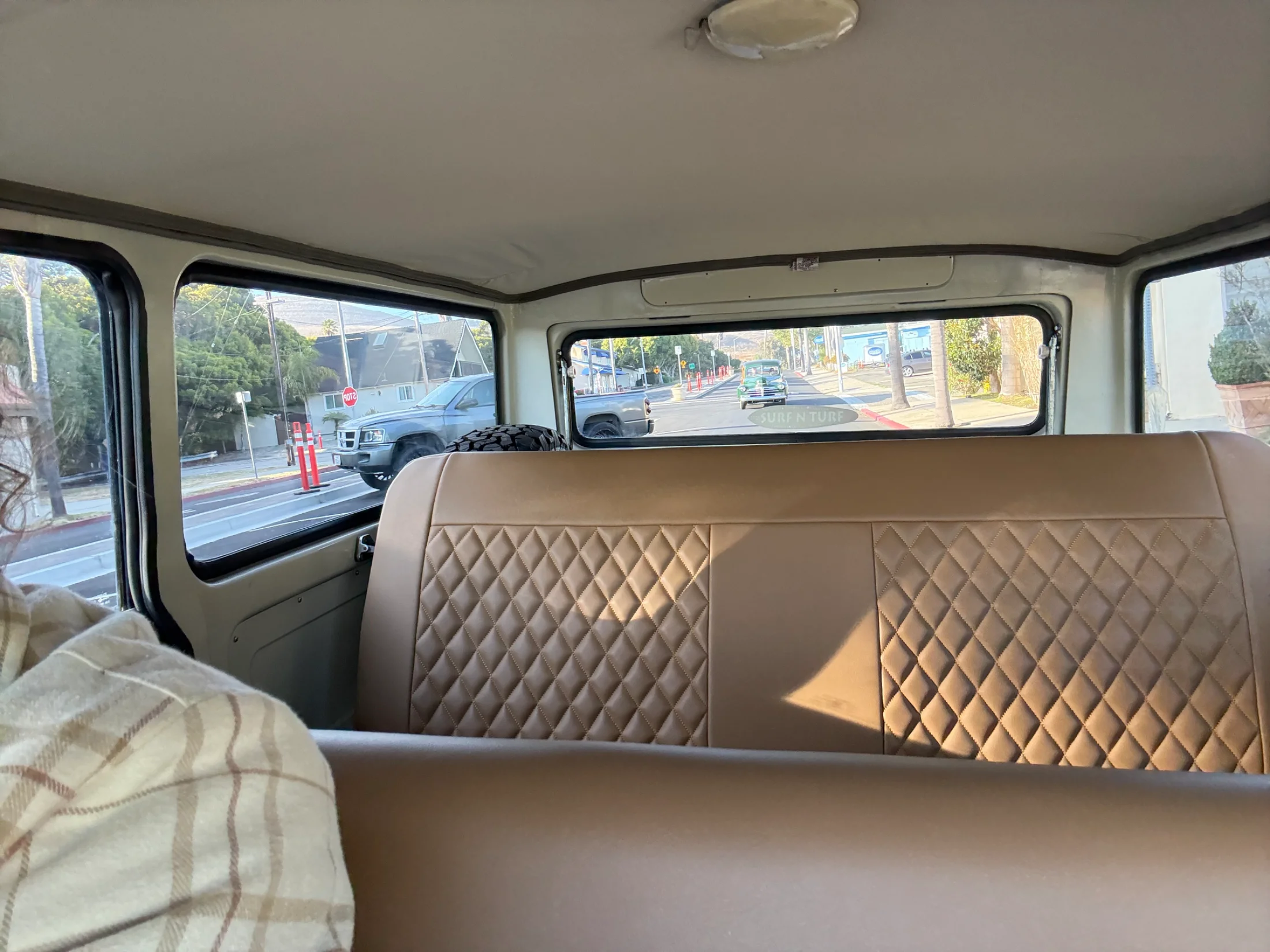

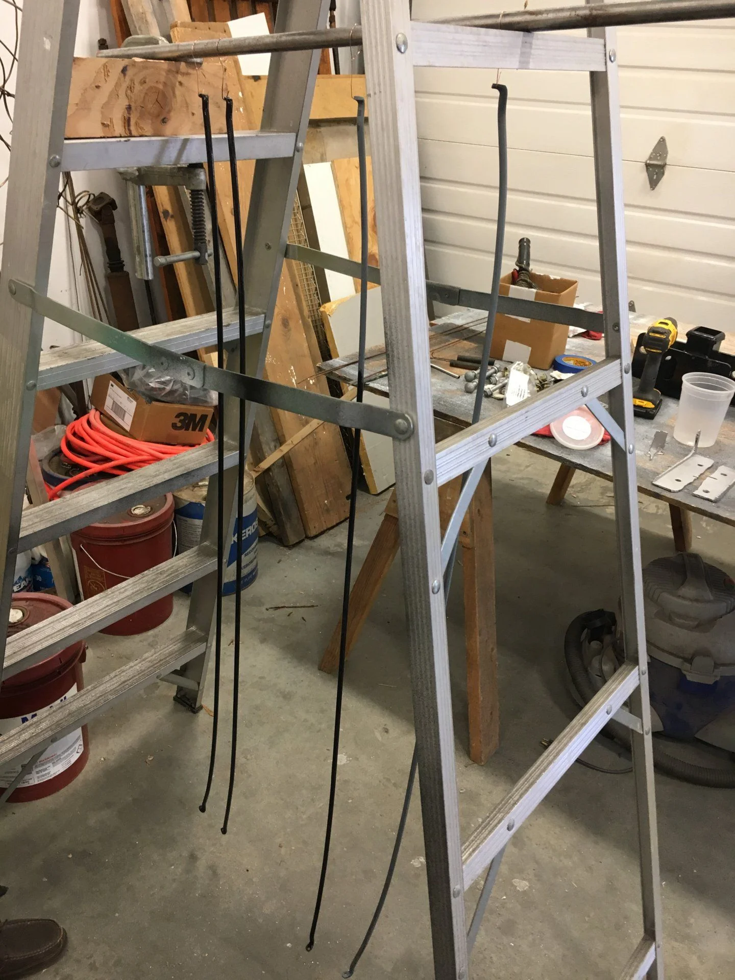

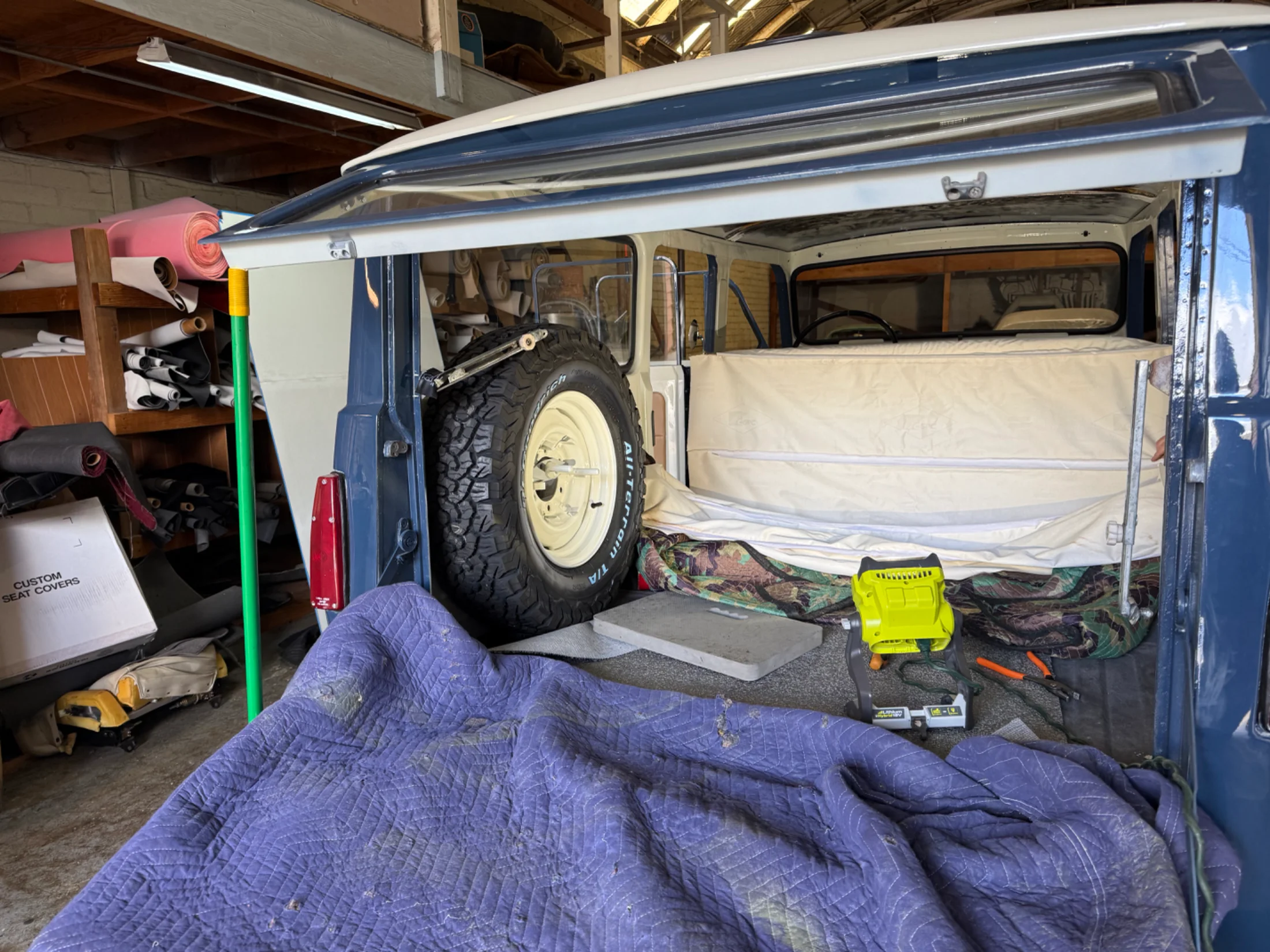

I used the sor one with their trim kit. It fit well ( my upholstery guy installed it. As for the bows they would be pretty simple for you to make. Just sone small diameter round stock with slight arc and just screws into the sides with one Philips screw per end. Some pics of mine I had.
