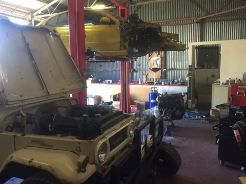

Engine is out, big lump of a thing! ......transmission and bell housing adaptor shouldn't be too far off. Got the brakes, remote booster is here as well and Herrods has just finished unlocking the ECU.....Then i get to start the real fun stuff!!
