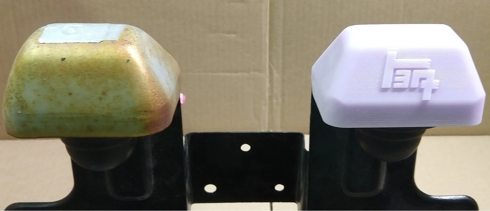

I made a thing. I own solid modeling software and a 3D printer. And I'm licensed to use them.

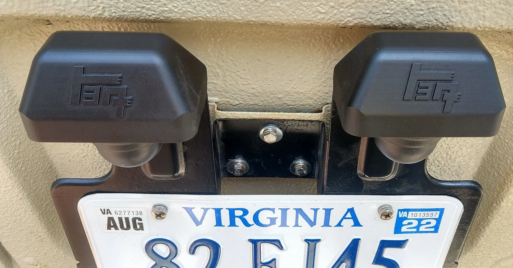

My old rear license plate bracket light covers were dead when I purchased the truck. And I wasn't going to spend $$$ on "new" ones. They're rain covers for Pete's sake.
So, I modeled and printed them up. I used a resin printer, as I don't own a filament type. YMMV

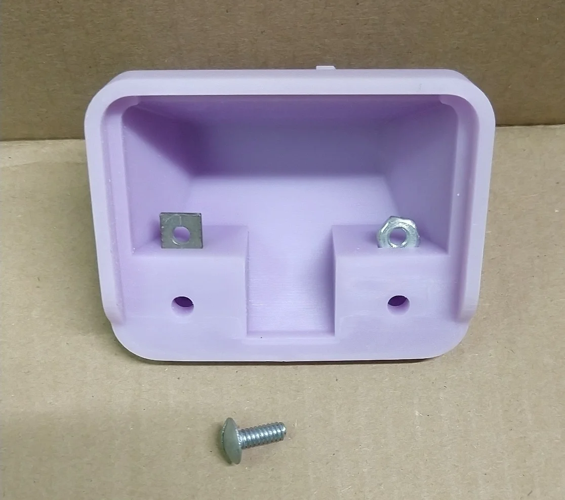

Instructions: I used #10-24 x 3/4" machine screws. A standard #10-24 nut (square or hex) will fit into the slot to hold it to the plate bracket. Pics and .STL file below.
-Argyfoe
