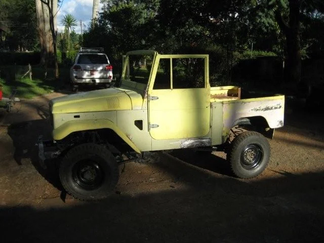

Not sure if anyone is interested but am well into a 72 Fj40 being converted to surf/4runner engine tranny and axles and suspension. I have learnt huge amounts from this site. Thanks to you all for you information.

They are second hand imports from Japan , this one is the non intercooled solid axle front and rear but coil sprung , the engine is about 1997. Ill post the engine number later

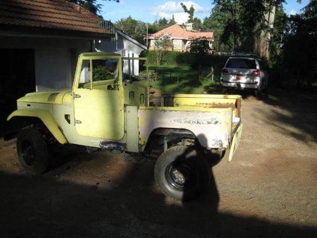

Why the 70 series style body mounts on the front frame horns? And is the bib going to clear the rad where it is currently mounted?
Edit: I see you grafted in a section of the frame.

I t should move pretty quick, I extended a few inches on the graft and then set the rear axles a couple of inches so have a 6 inch extension , which appeared ok , now I will have to extend the body behind the door which means a standard bestop top wont fit , tomorrow hopefullymore pics

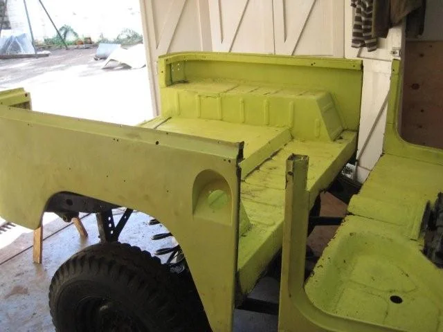

I Have now pretty well finished the chasis and before stripping to have the chassis galvanised I have fitted the tub and panels. I then cut the tub as pictured to accomodate the new length of the axle( +6"). I will begin fabricating a small frame and body panels to fill the gap.
This extension should help with leg room and comort.
I will hopefully have the frame/ chasis galvanised by next weekend and can start final assembly . Plan to have this on the road by end April 2010.
