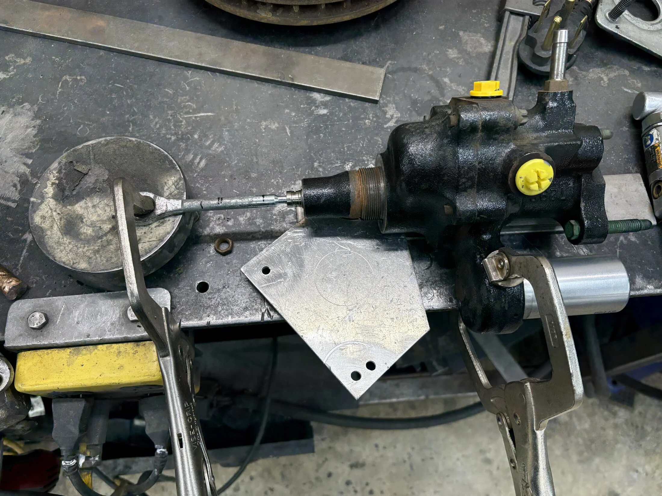

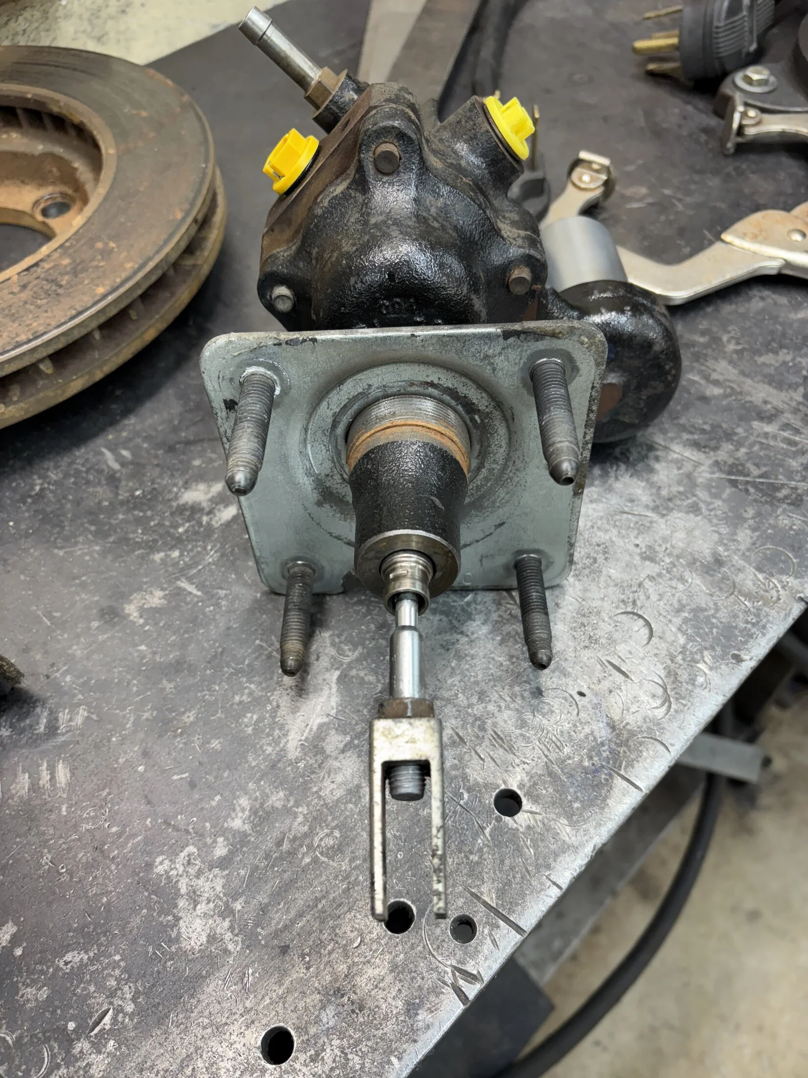

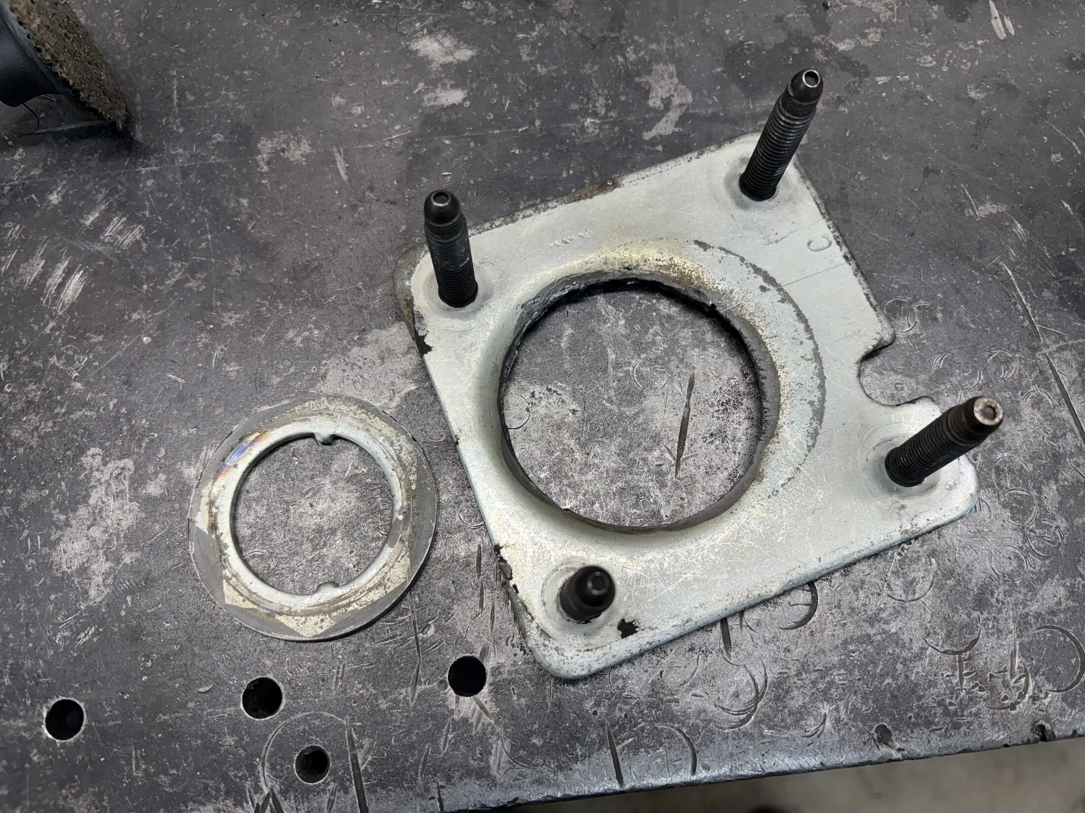

$10 junkyard hydroboost from an ‘06 GM van with a 4.8 LS. I’ve already removed the large threaded nut which holds the mounting plate and hydroboost to the firewall. The nut is a BUGGER to get off
The hydroboost plate is keyed off center to keep the unit flat and level when mounted. Going to use the keys, not the GM plate

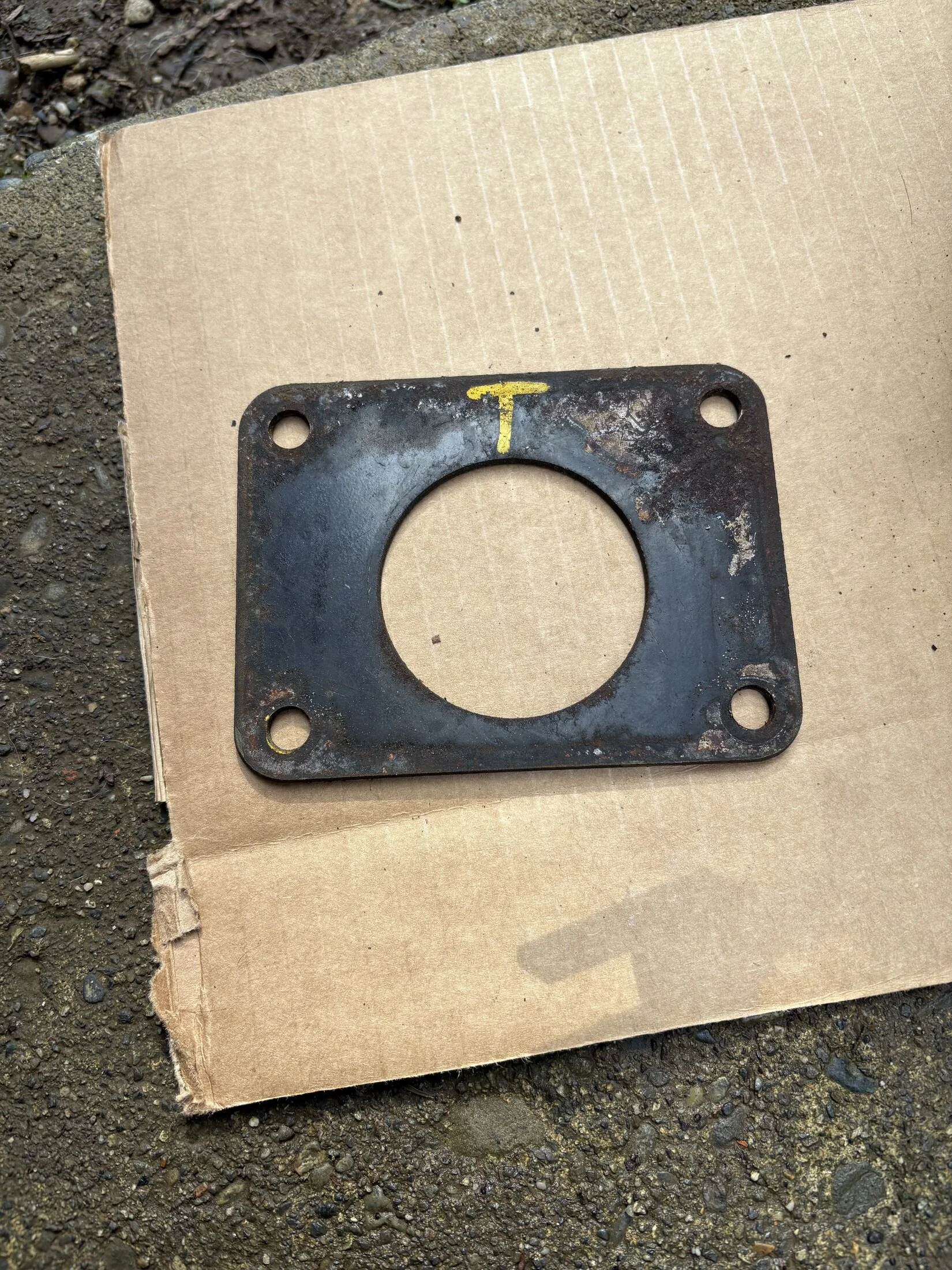

This is “one” of the firewall plates behind the Toyota booster. It’s a perfect template since that’s the bolt pattern that needs to be matched to the FJ40 firewall
At rest, the Toyota pushrod from the booster to the pedal was about 5.25” and the hydroboost is about 7”

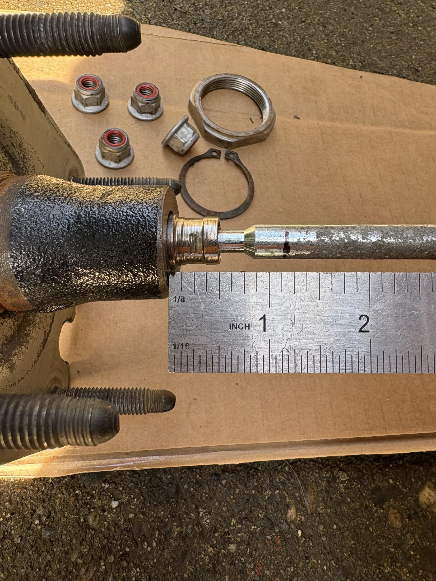

Need to shorten the hydroboost rod appropriately and then thread it M10x1.25 for the Toyota clevis
Overall stroke on the hydroboost is roughly 1.1” which matches the Wilwood 1.12 bore master I have for it. According to Wilwood these are considered “short stroke” components
The GM rod is quite close to the correct diameter to tap the M10 threads onto it. I just had to taper the shaft a bit at the end to get the die onto it

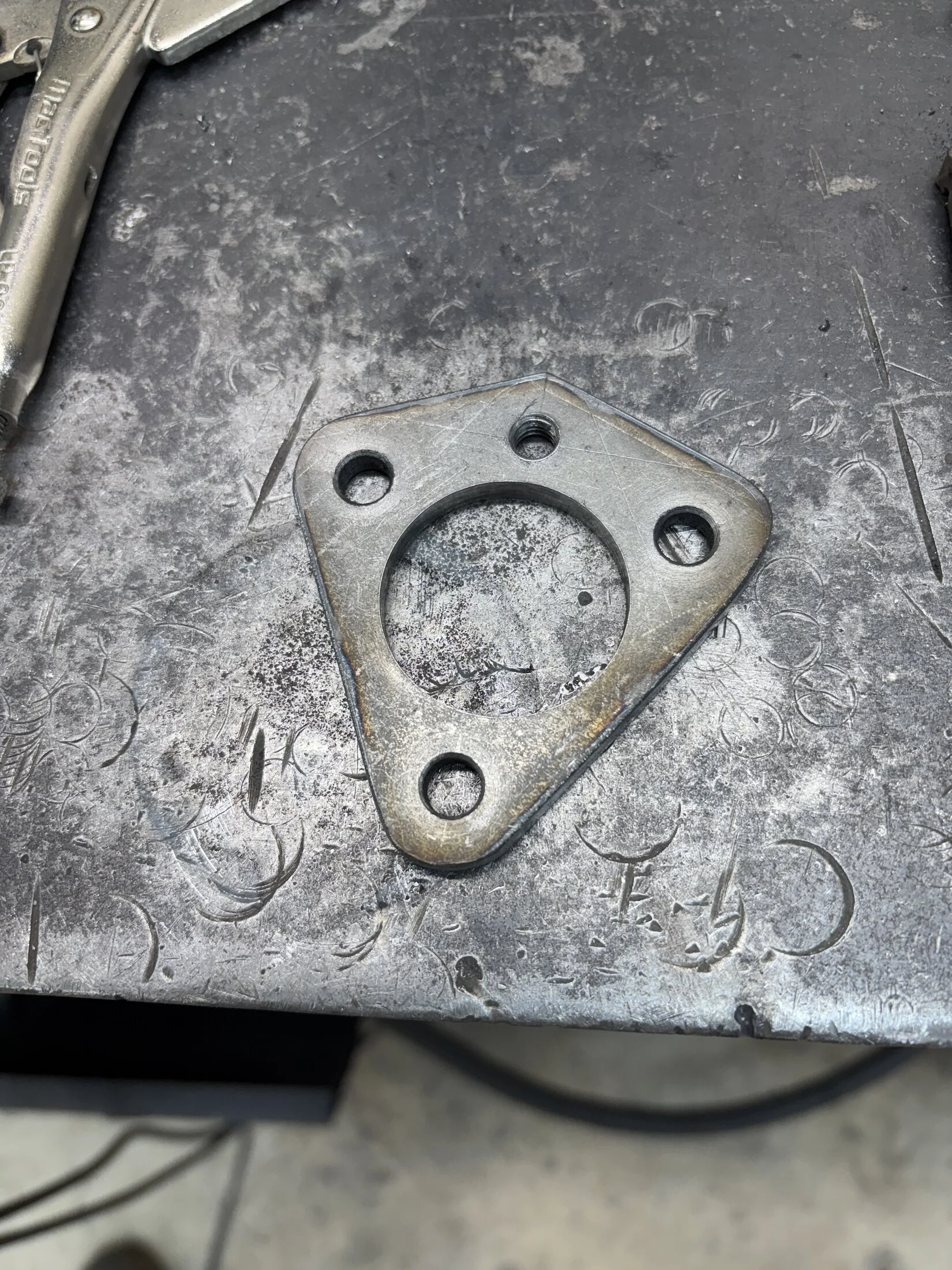

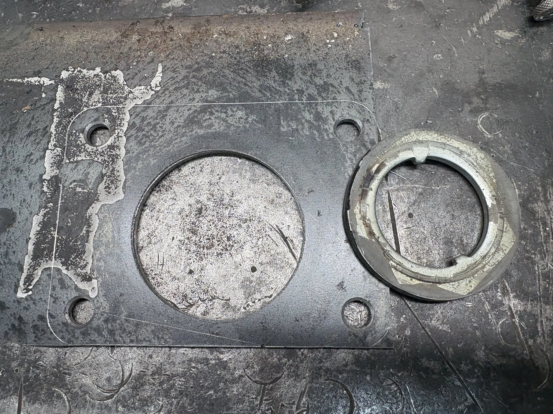

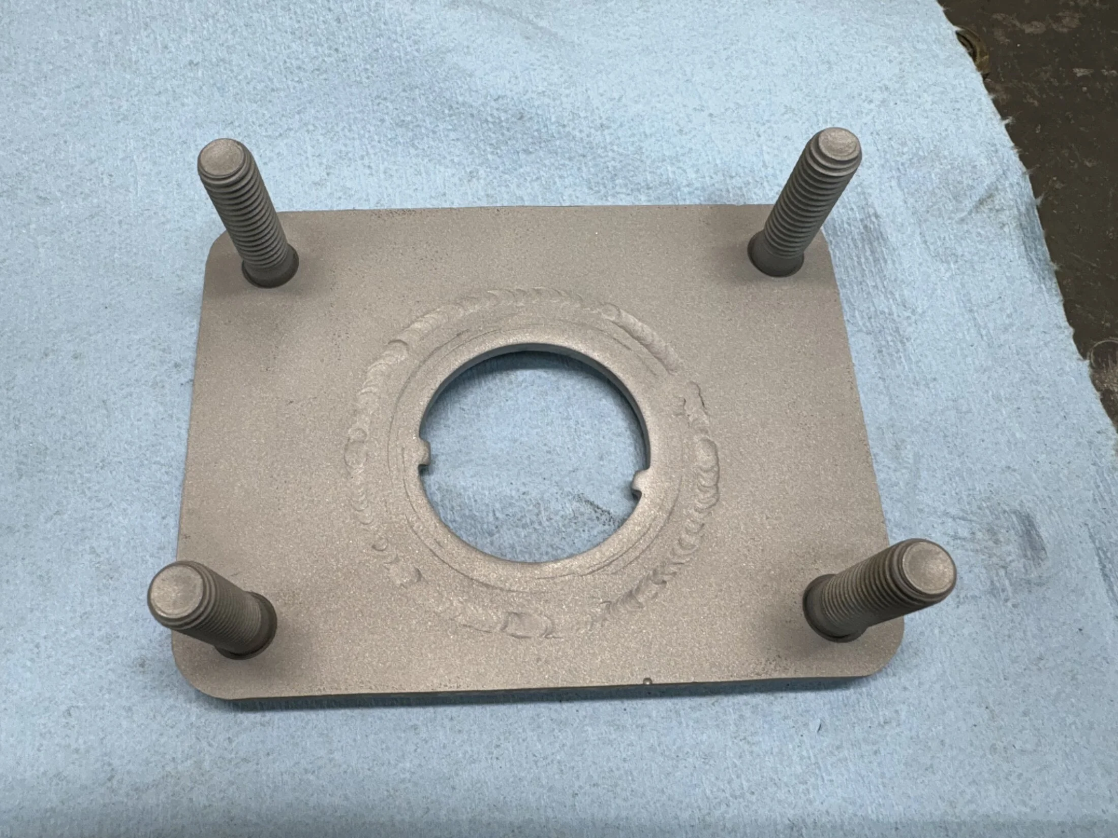

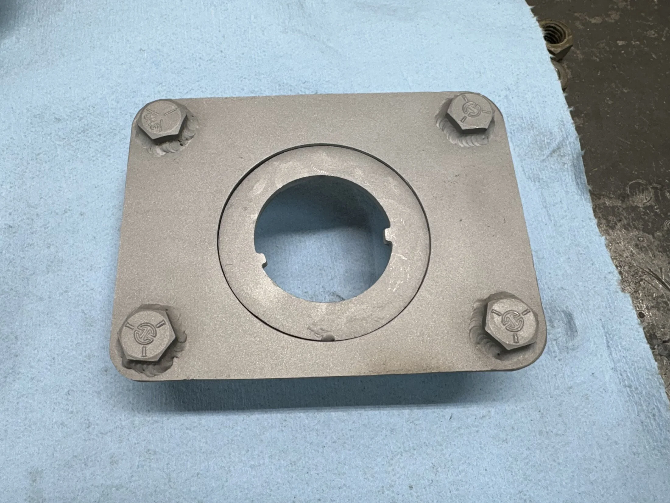

Firewall plate mount. I used the plasma to cut the center ring out, sanded it down to a 2.5” OD. Threw the GM plate out at this point

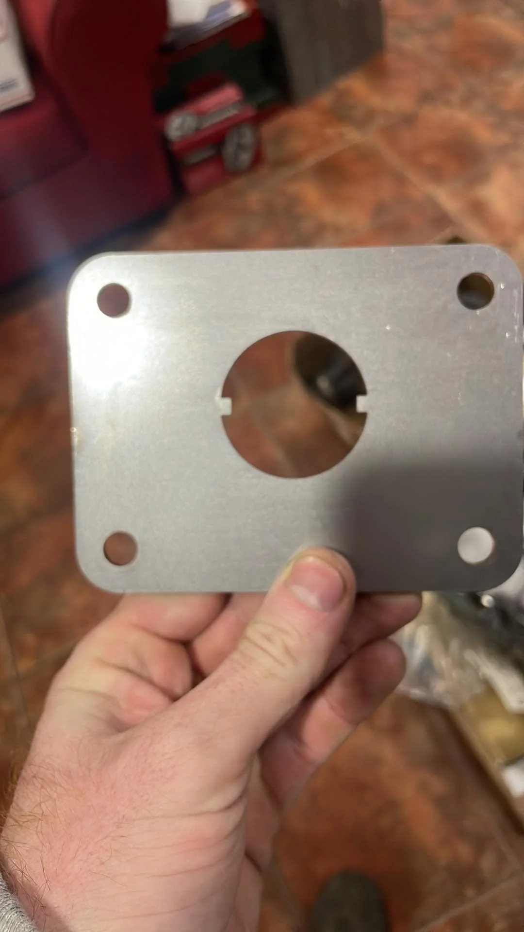

Found a scrap piece of 3/16” steel. Used the Toyota plate from above as a template to drill the mounting holes. 2.5” hole saw cut the plate next
I had centering lines to keep the alignment right between the hydroboost and firewall. Everything is tacked in place here
Plate is done. Welded in all the mounting studs, verified it fit in the firewall, shot it with Steel-It

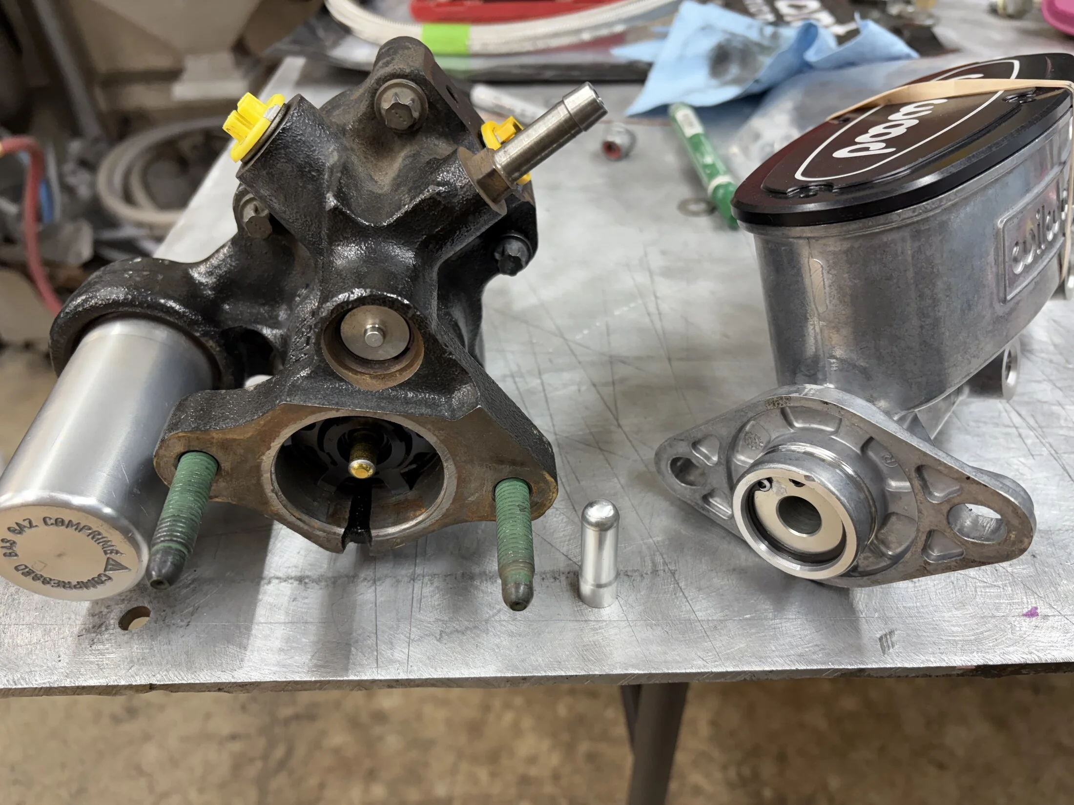

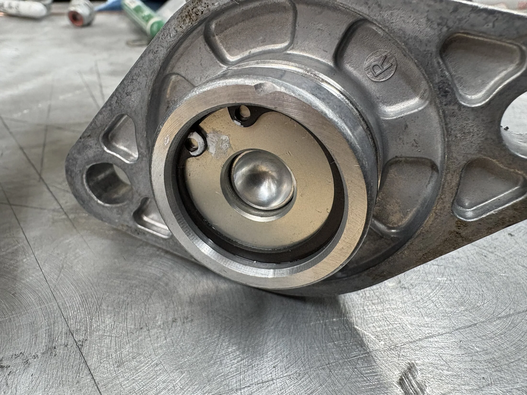

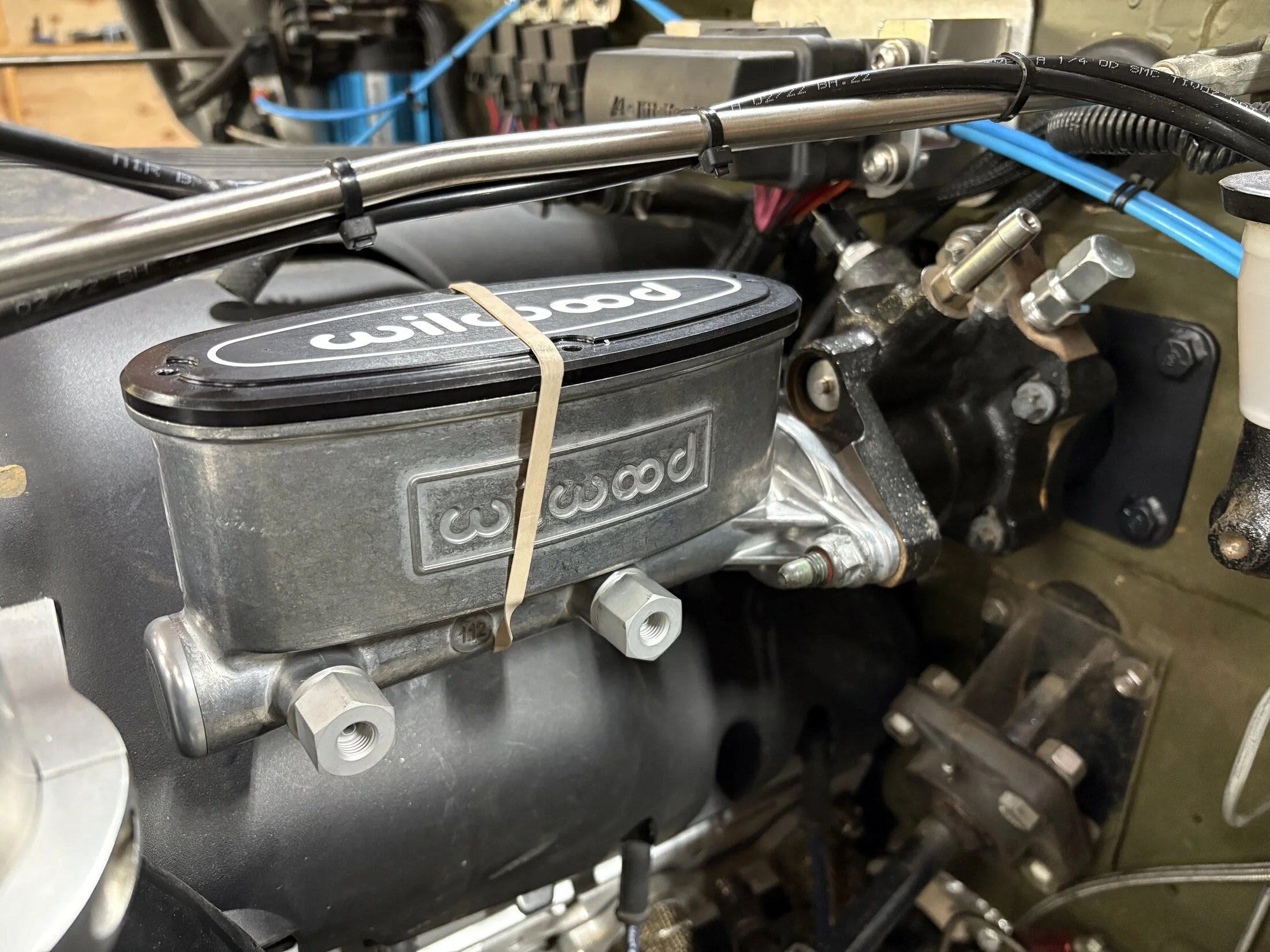

Wilwood master and the hydroboost. Wilwood supplied the small aluminum “pill” which fits up inside the master cylinder. I needed to shorten the pill by about .125” as it was a tad long. It would have prevented the master from fully returning.
Pill is shortened and installed in its bore

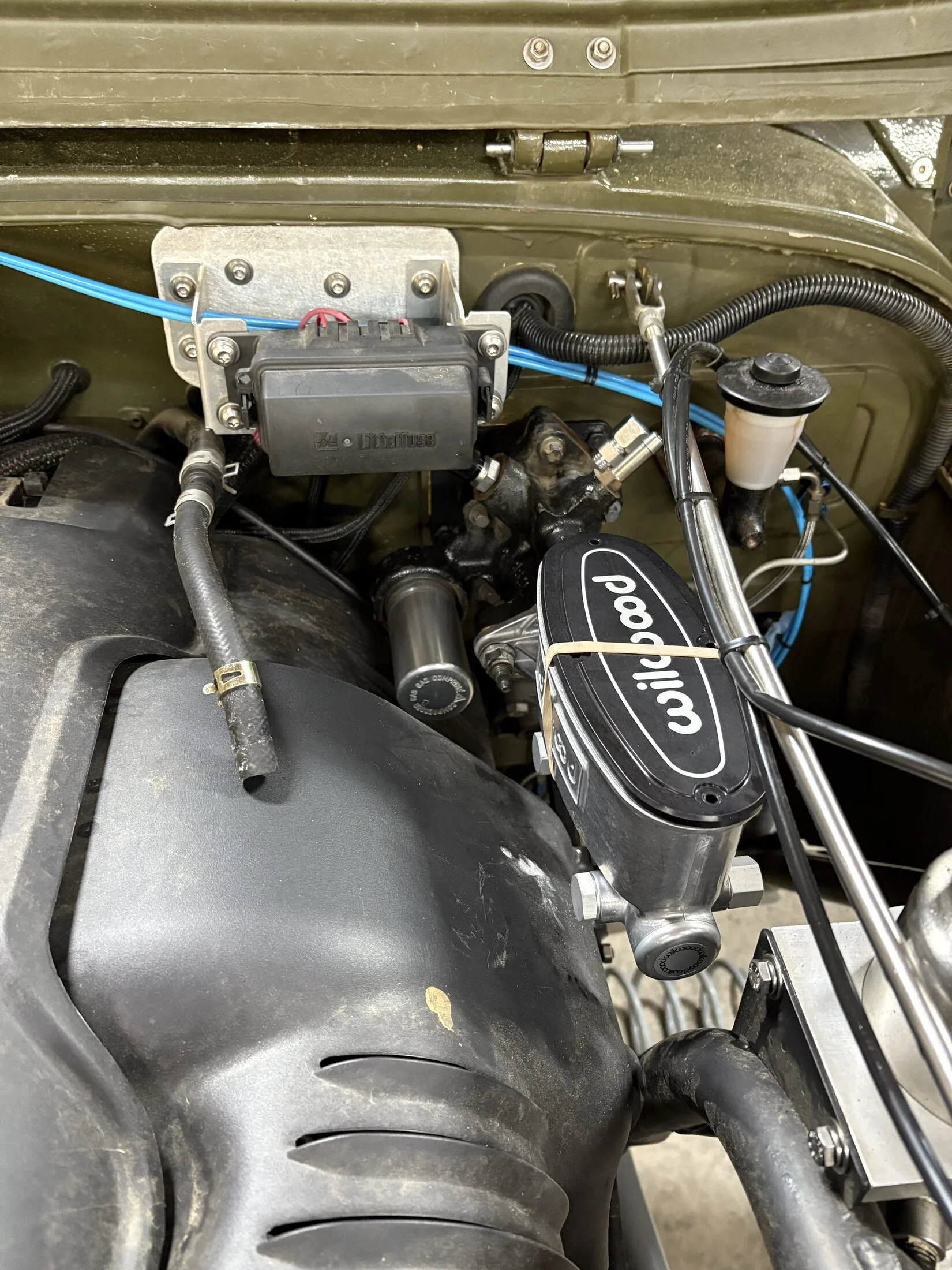

And it’s in, fits DARN good. Waiting on some fittings to make high pressure lines and a stainless bung to weld into my reservoir for the low pressure return. Have about 6 hours into this which frankly is lightning fast with how my projects normally go

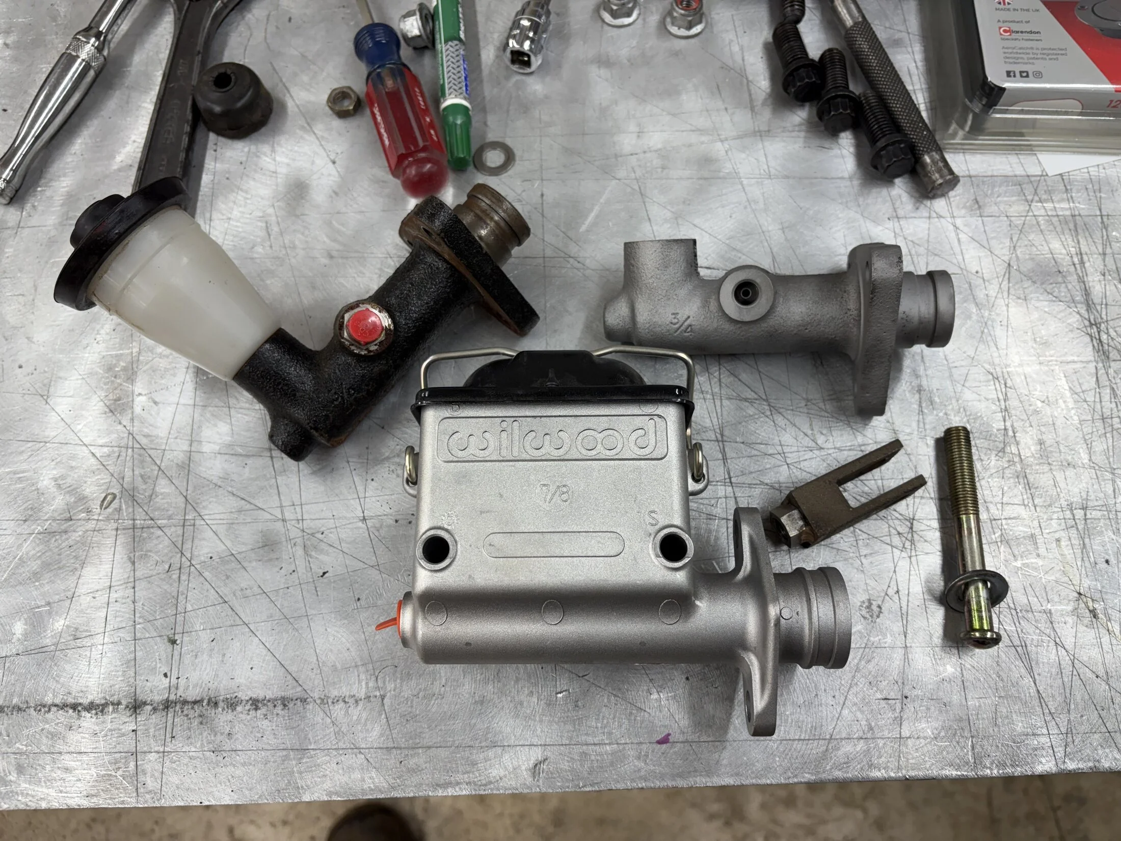

Going the exact same “cut nothing up route” with the clutch master. After the LS swap, I’ve never been able to get the clutch to quite fully release. I believe there is just not quite enough fluid movement between the 3/4” bore FJ40 master and 13/16” bore FJ40 slave.
Picked up a 7/8” bore Wilwood master. The pedal will be heavier but it’ll certainly push enough fluid

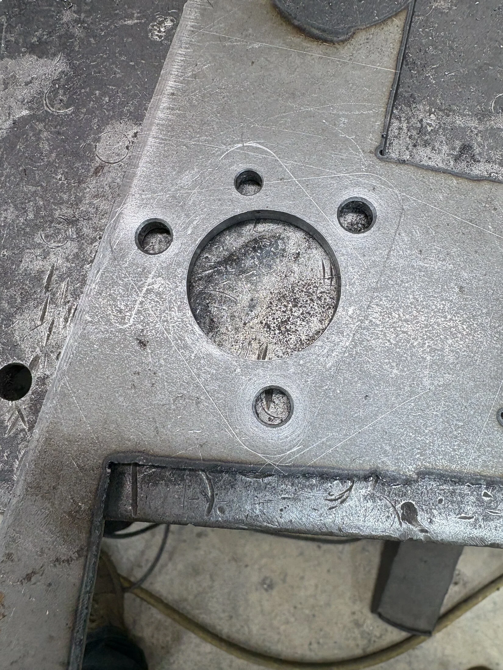

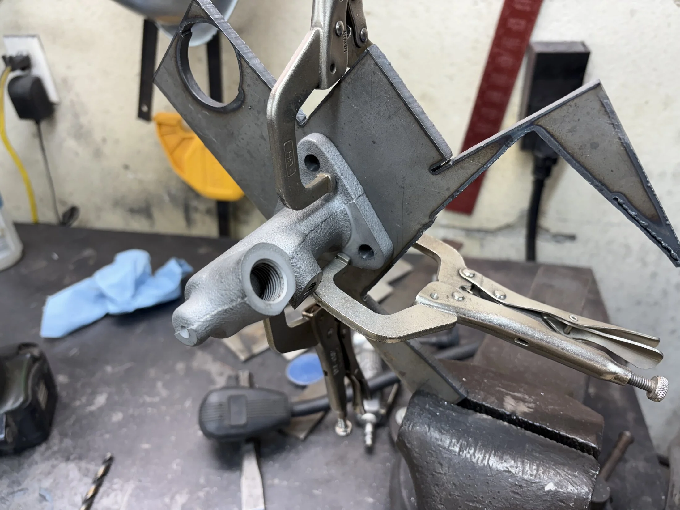

Grabbed a scrap piece of .25” cold roll plate, cut a 1.5” hole in it. Mocked up a junk (soon to go in the trash) FJ40 master. Clamped it to within an inch of its life, drilled centering marks for the mounting holes
The Wilwood master uses vertical mounting bolts, fortunately I can use the lower hole on the FJ40 pattern. Top Wilwood hole was drilled and tapped for a 5/16-18 stud
Done with the plasma and it’s sanded

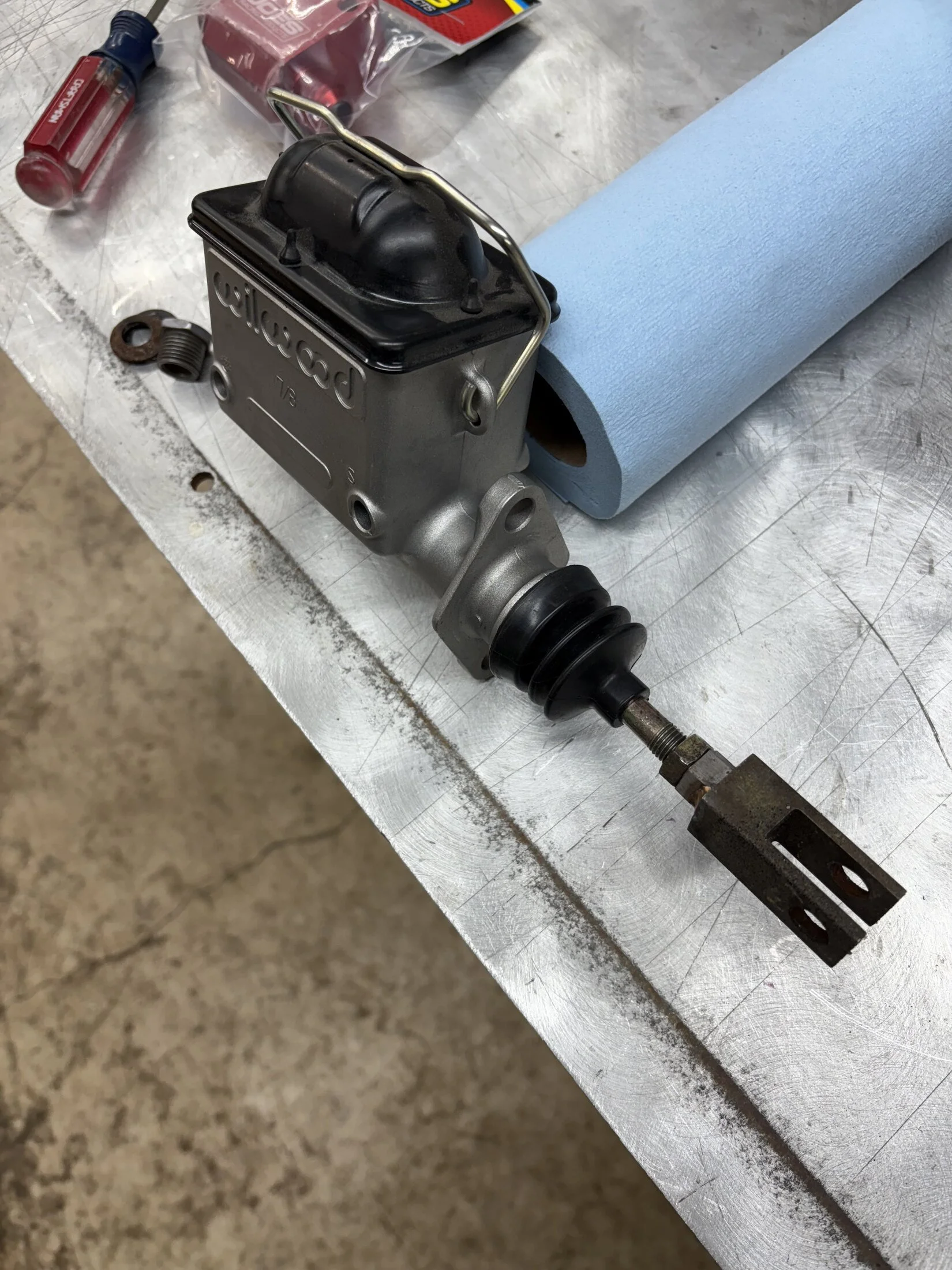

Adapting the FJ40 clevis to the Wilwood master is far more straightforward compared to the hydroboost.

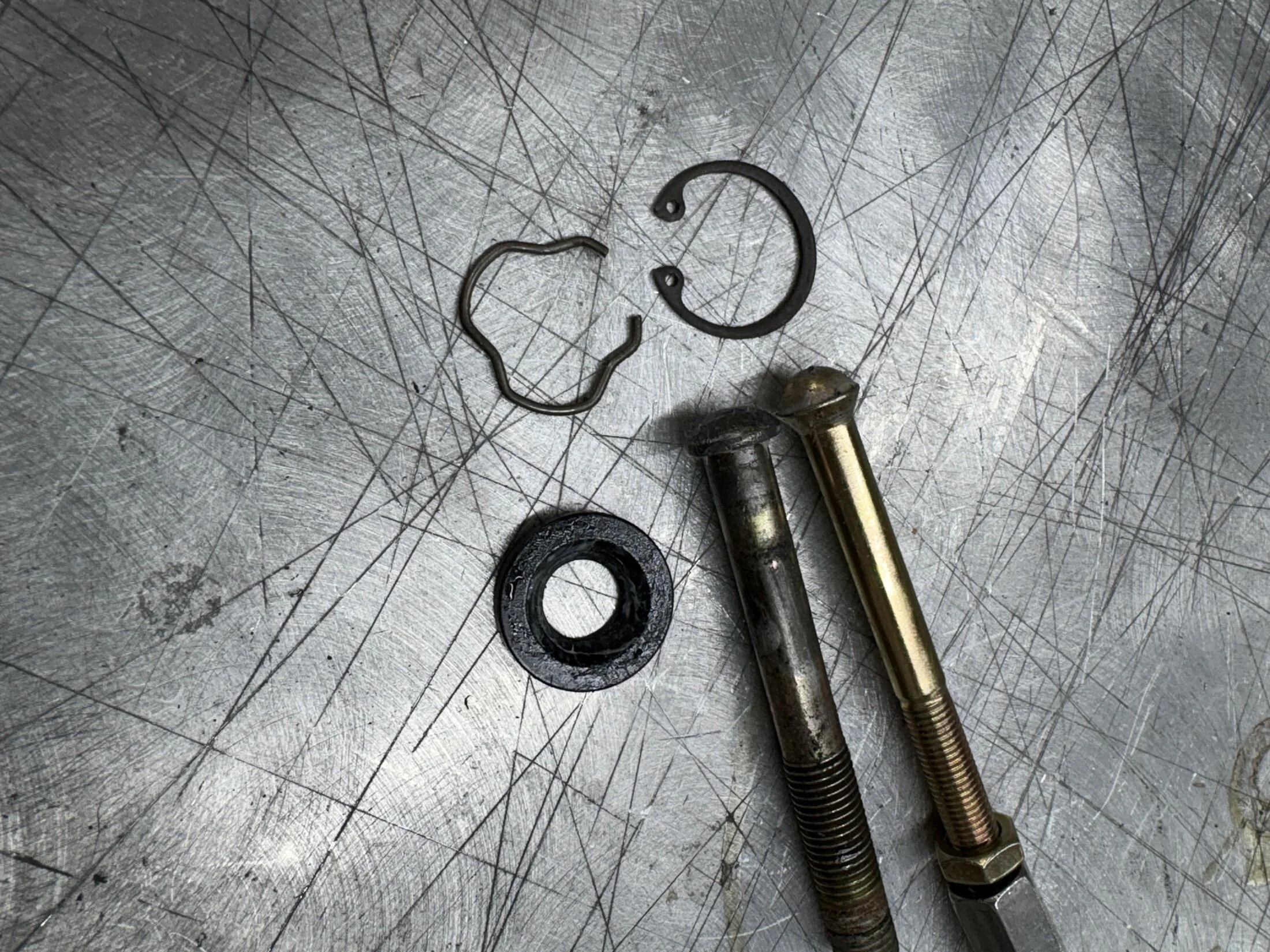

Undo the FJ40 wave clip, pull the pushrod and discard everything else
Remove the Wiwood circlip and swap the Toyota rod on, using all the Wilwood parts and circlip. The rounded portion of the pushrods is nearly identical.
DUN. It was harder to install the Wilwood boot 🤣 And the welded nut on my clevis was an attempt to get just a bit more throw out if the slave to release the clutch. Didn’t work
It’s in. Need some metric studs for the firewall but you get the idea. The Wilwood boot just fit through the factory FJ40 firewall hole

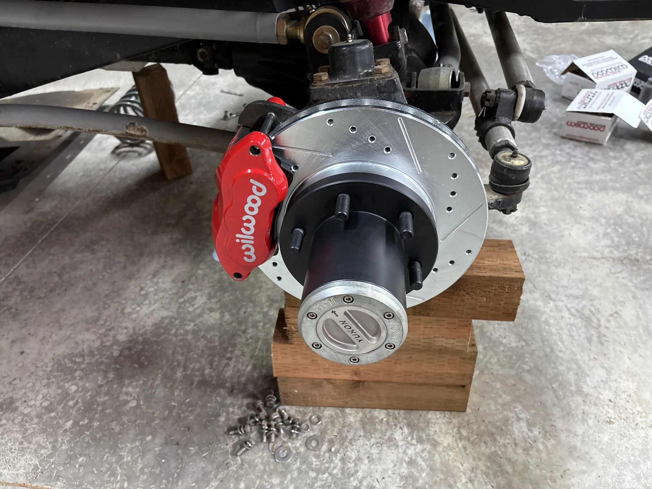

Little bit of a brake upgrade on the front Dynatrac D60…

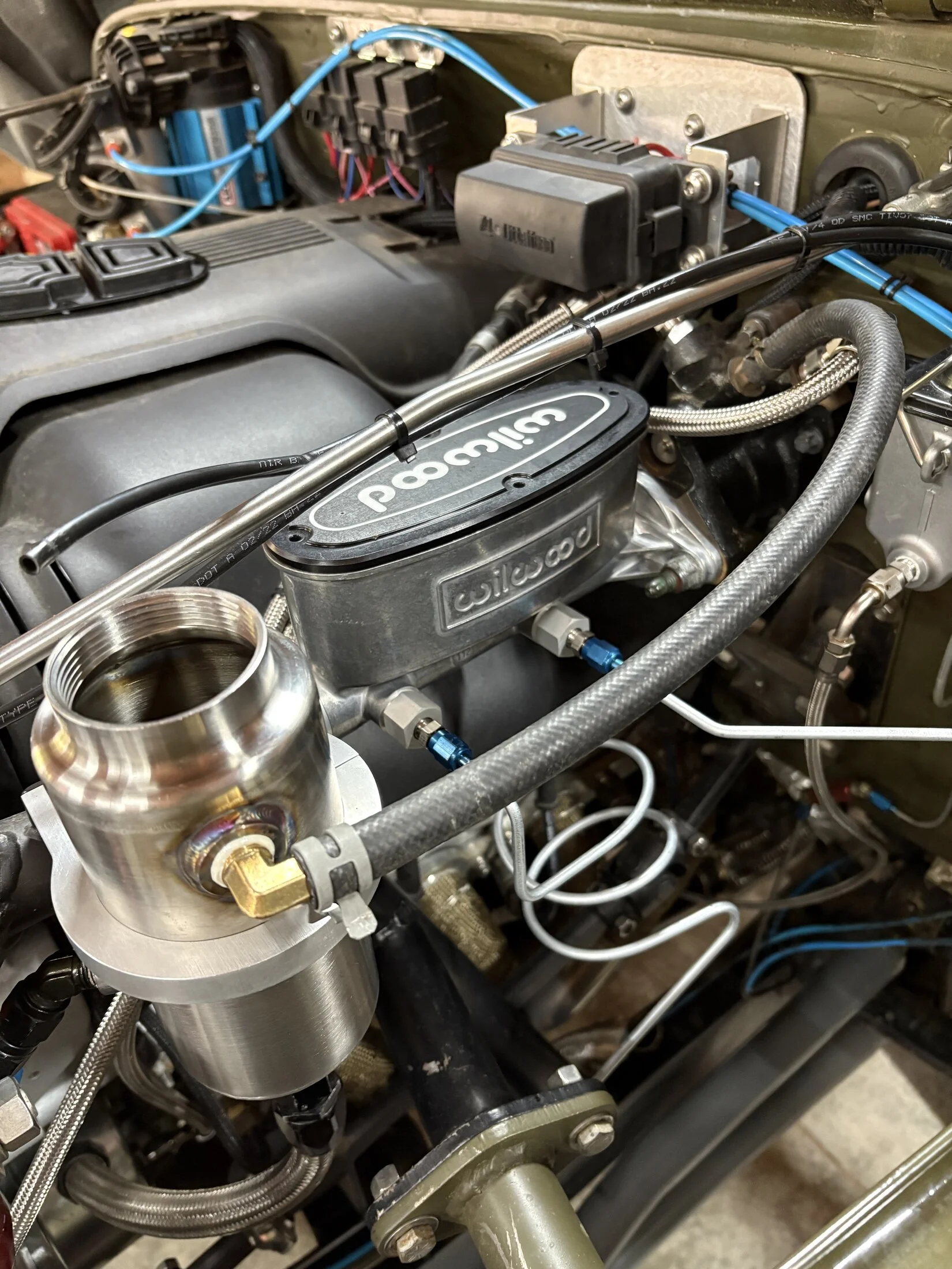

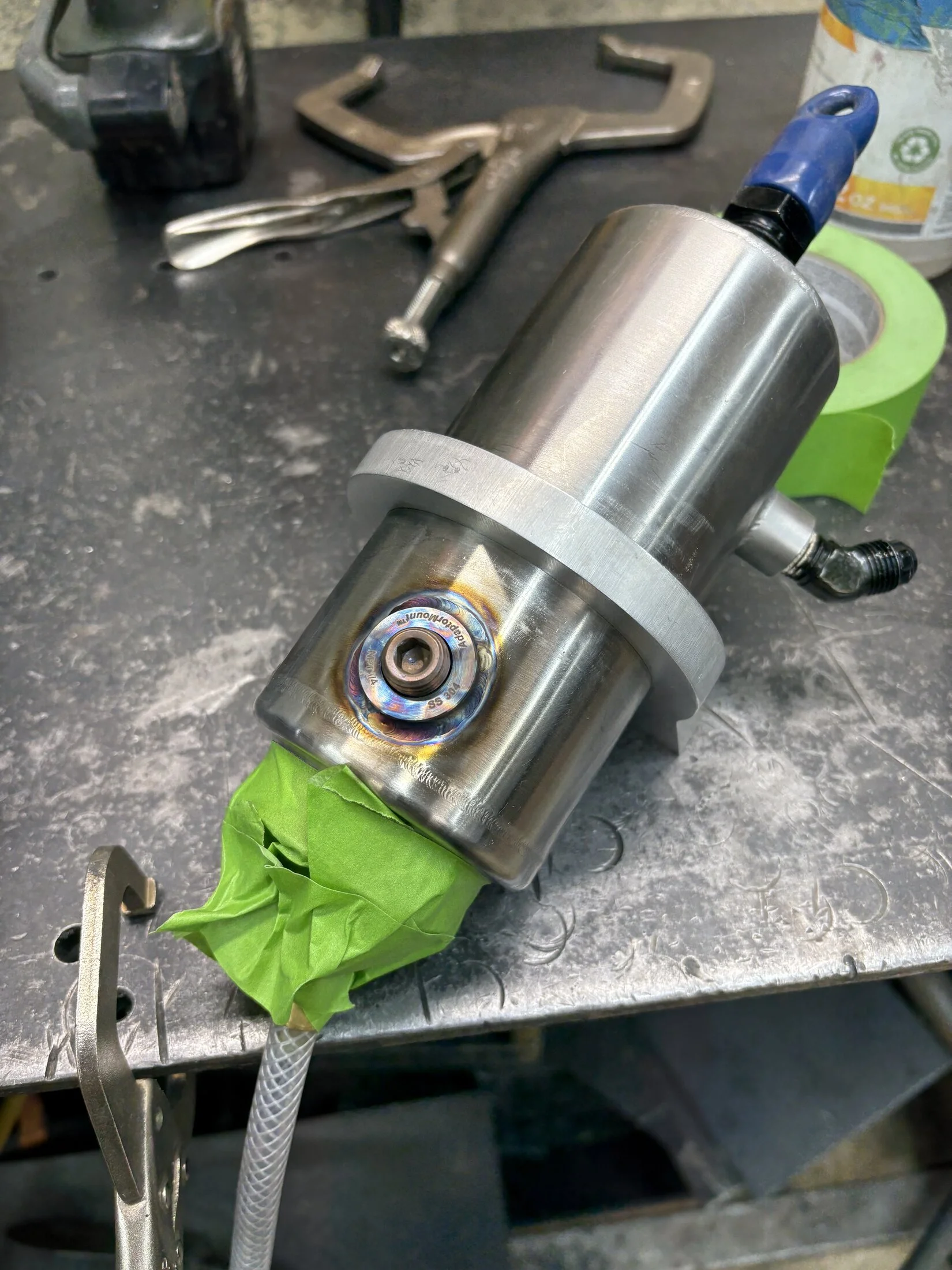

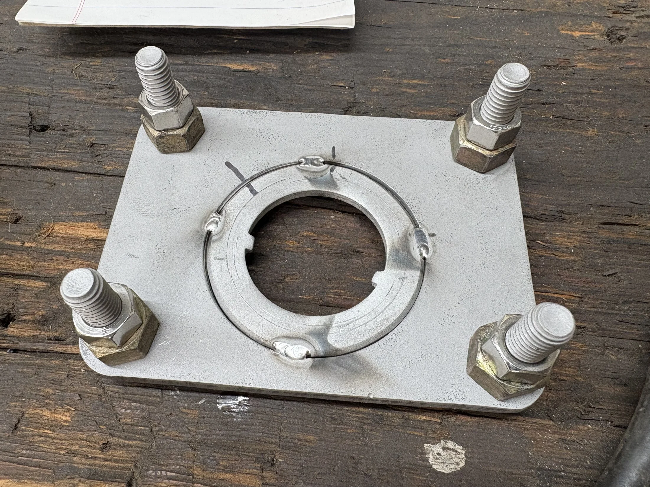

1/4” NPT stainless bung for the low pressure return…
I rigged up a booty fab back purge with argon while welding it, kept it REALLY clean
