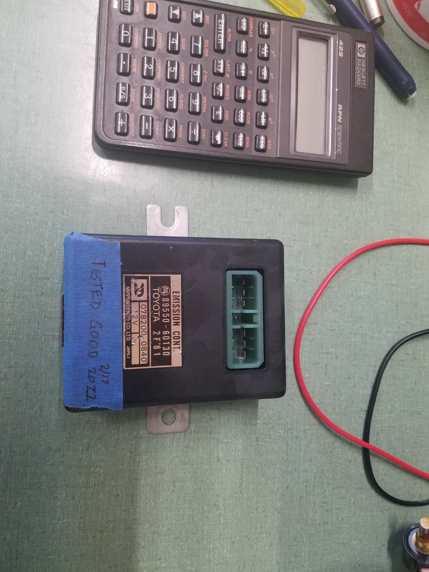

I think we'll proceed with another FCS and also an emissions computer since ours has the low voltage issue to the FCS.

An update: We finally had some time to devote to the FJ and our idle issue. The good news: The replacement Emissions Computer arrived from Engineer8000, it looks really good and did solve the low voltage going to the FCS. A really great job with communication and the quality of the unit, plus fast shipping.
