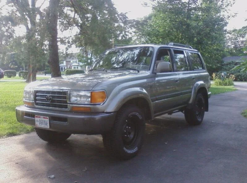

I am running a set on my 97 and they bolt right up. Just be sure and have the appropriate lug nuts as the alloy lugs don't work.
The tires are Michelin LTX AT2 265/70/17 and the lugs are an aftermarket lug from a local auto parts place that the tire shop ordered. For me this combination works great since most of my miles are city and highway. They are great in the snow to!
Hi. 94srunner, in the above photo does your truck have wheel spacers? Also, is it lifted? It looks great.
Kevin
Is their any weight advantage to the steel wheels? Or disadvantage for that matter?
They sure look sweet.
Thanks,
Ah...I run no wheel spacers and the truck does not have a lift. It is a fairly stock rig.
As far as weight advantange or disadvantage I am not sure. I bought them more because I like the look they give.
