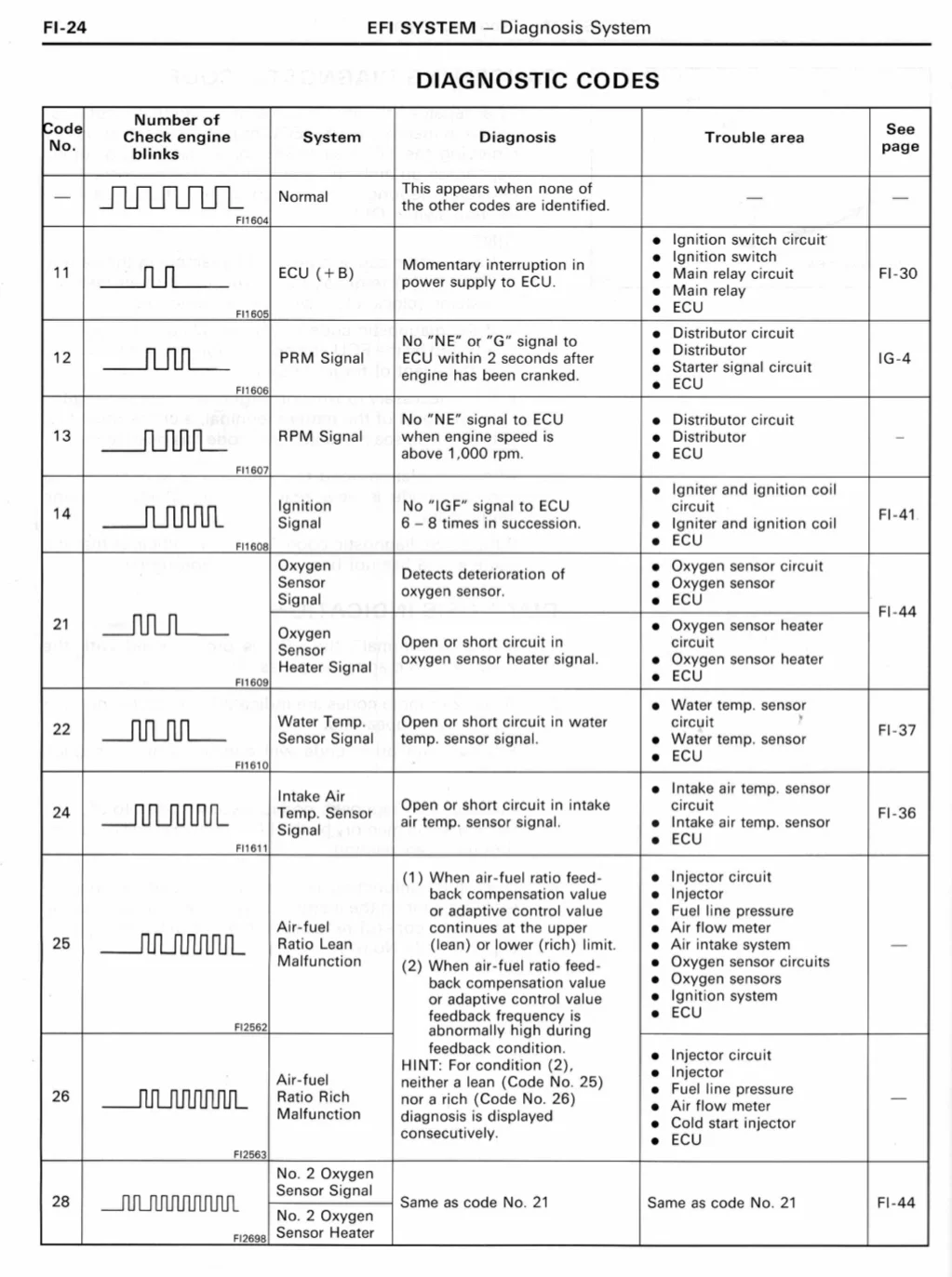

Since I’m on here, I checked my CEL with a paper clip and it gave me number 23. Anyone know what that pertains too?

What does that mean? There nothing for that code
It means you read the code wrong.
