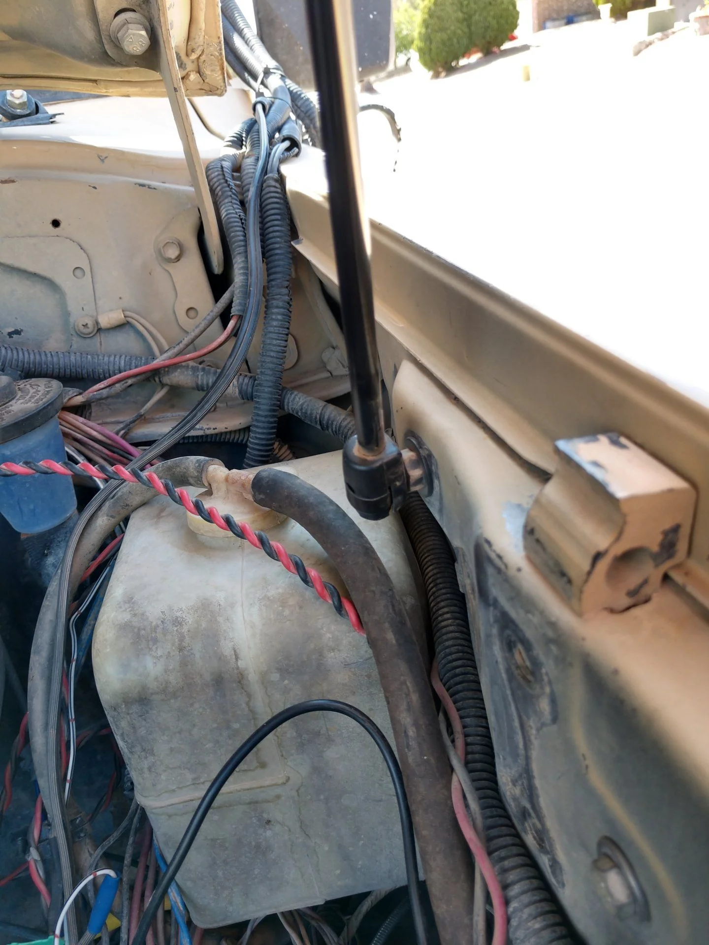

I purchased a hood strut conversion kit from Amazonia 4x4 - Parts & Acc. for Sale

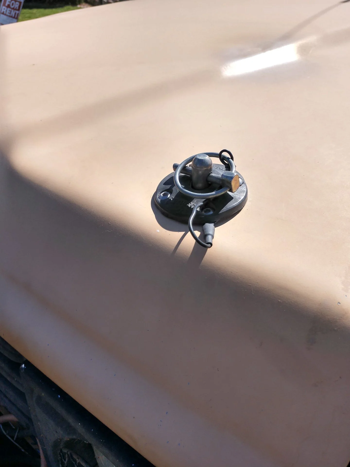

My hood latch broke years ago and I use hood pins to hold down the hood. Now there is no fighting lifting the hood. I attached a pull strap on the hood latch so I just pull the hood down from the center.

I don't mind having to lift the hood....I think the bigger advantage here is you can remove the original hood springs which clean up that area of the engine bay just a little more.

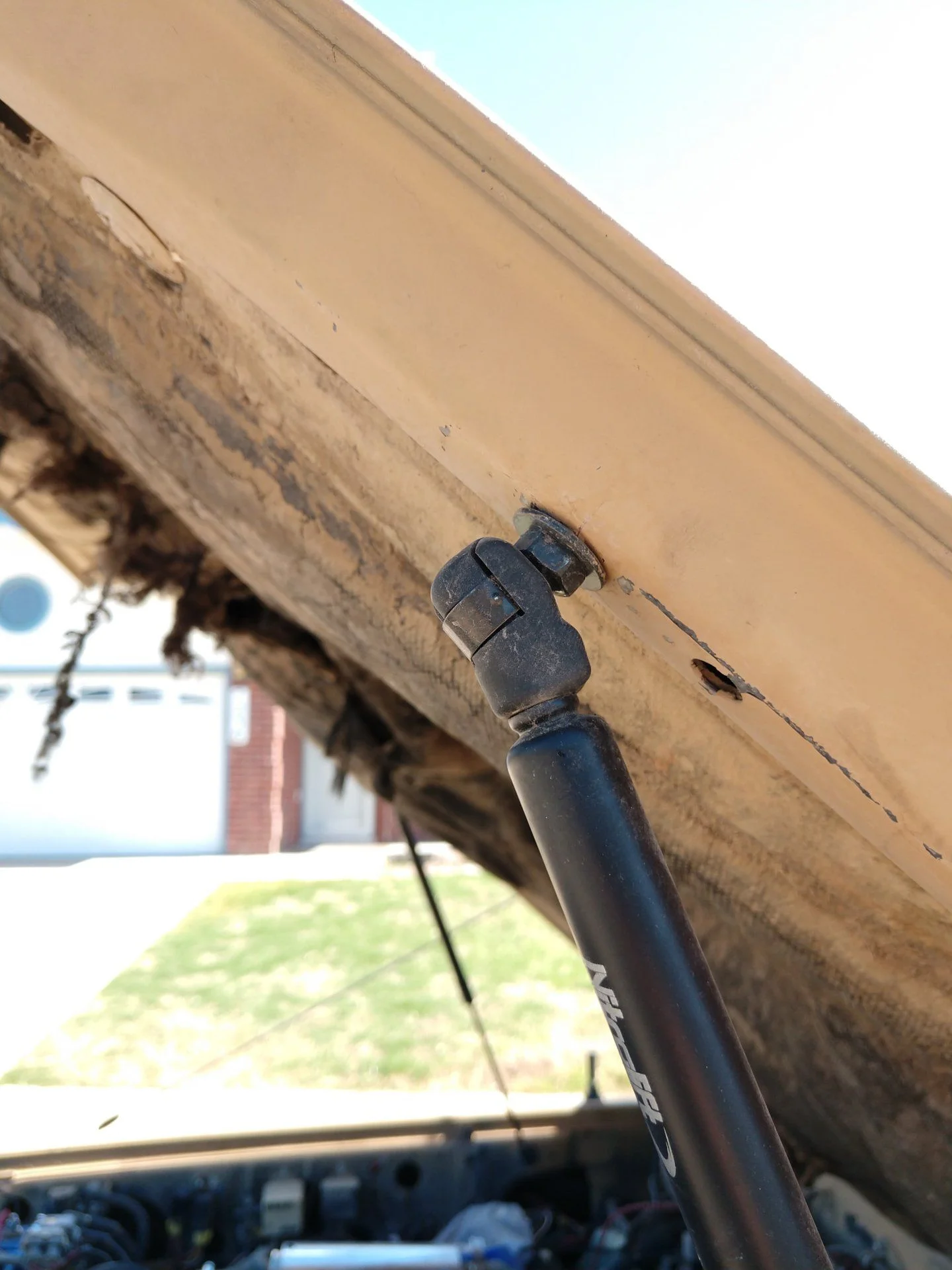

I saved this from another thread from a month or so ago. My sincere apologies to the member who wrote it up. I do not recall who it was, but all the credit goes to him. I've attached the file with pictures as well.
Hood Strut installation
Remove both hinges. 5 bolts each. 12mm, M8-1.25. I put the two back in the hood and the two forward bolts as well. Leave the rear most hole open.
Purchase (I used Amazon):
4 Pack 10MM Ball Studs - 3/8" Thread x 1/2" Long Shank Dark Bronze for Gas Lift Support Strut Fitting Hatchlift Gas Springs - 20" Length x 90 lb Force with 10 mm Ends. (508mm x 0396N)
M8 x 1.25 tap and bit set from home Depot. Install one ball stud in the rear most hinge bolt hole.
Push the other end of the strut up to the hood. It will hit the hood about 3⁄4” above a factory hole. This is where you will drill and tap a new hole. Be VERY careful not to push too hard and dent the hood. Use a bit collar or a bunch of tape.
Install the other ball stud and attach the strut.
It will feel stiff at first, but once you are used to it, it is awesome.

I welcome others to weigh in after looking at the two methods, but in comparing the two sets of instructions, it looks like each method uses different mounting points. The instructions I furnished has the top of the springs angled up and to the front while the ones Seth S provided has the struts angled to the rear, when the hood is up. Clearly, both methods work.

Yes, depending on which holes you use you might want washers. Depends on whether you are able to use a thicker preexisting threaded hole or if its going into a sheet metal hole.
I was looking under my hood yesterday and looking at the various mounting holes available. I think the better way to do this is as a kit is to make up some brackets that attach too the hood and to the body and mount in a couple of holes so as to distribute any load. I look forward to seeing your results and maybe I'll have some of my own by then.
