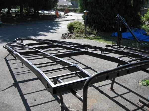

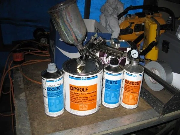

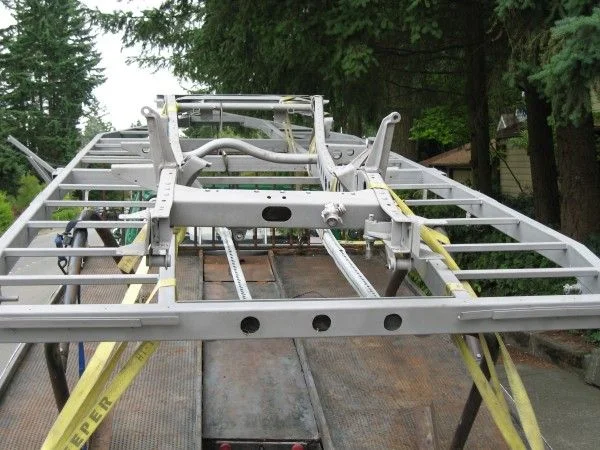

As soon as the sprinkling stops, I will be painting up my 2 frames with DP90LF.
Its a first try so I have my fingers crossed. I will just spray down the driveway, crank up the engine hoist and shoot it. I'll post pictures.

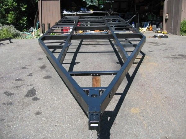

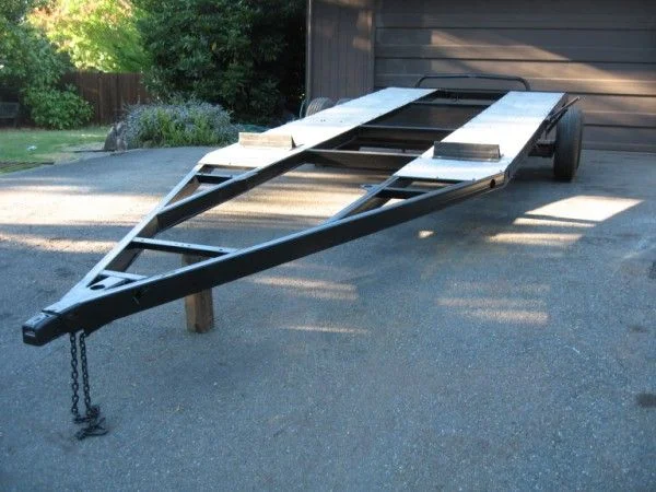

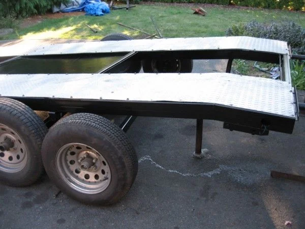

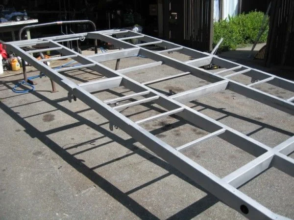

Well, by 2 I had painted 1 coat of primer on the frame. It looks pretty good for my first time. It took some time to figure out the air/paint mixture screws on my gun.
Here is a couple picks. I'll post some more when coat #2 gets applied.

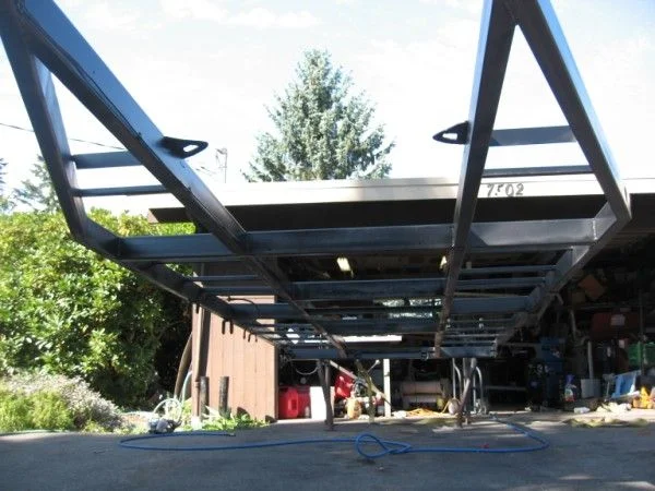

couple more

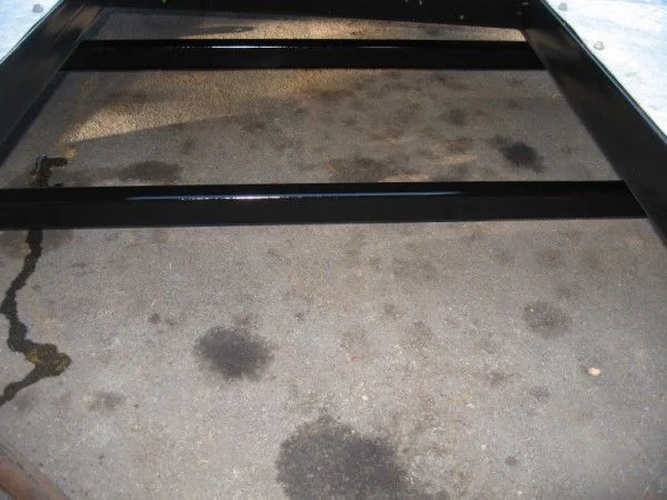

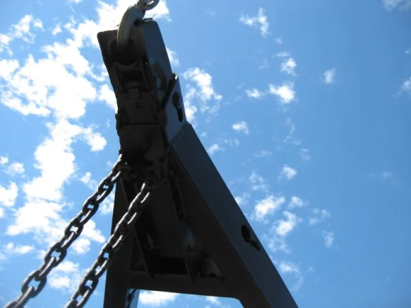

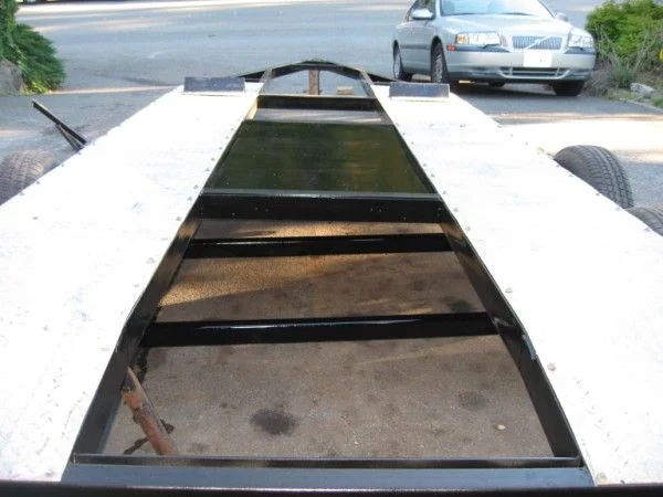

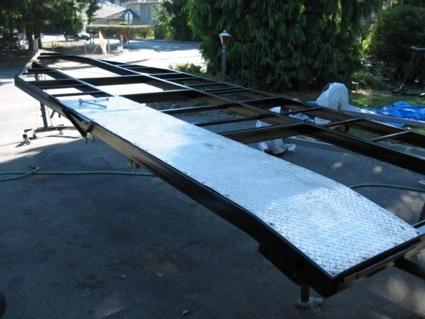

It was good to practice painting on the trailer. 2 coats on this trailer took 1/4 gallon of DP90. I still need to touch up a few areas I missed due to the sun being in my face. I think it turned out pretty good. I may paint the LV frame tomorrow if the weather holds. Then I'll spray both frames with some clear next week or the week after (before It gets cold)

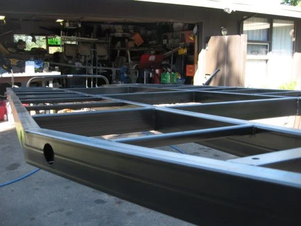

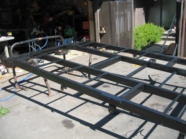

I like the dp90lf.
Looks great! Any problems with bugs or dirt when spraying outside? I am thinking of doing the same thing in the driveway.

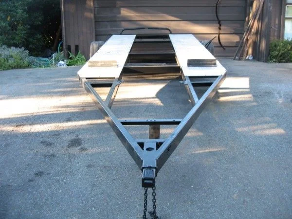

I put a total of 1/2 gallon on this frame or 3 coats. It looks very good. Before I sprayed the first coat, I sprayed the driveway down with water to wash the dirt and dust away from my painting area.
The wind was probably 2-3 miles per hour all day and only one side had about 20 small dirt spots that were painted over. I just took some 220 grit and sanded that side, then painted over it the next day and it looks very nice.
This is just a frame, a body would probably show more.
I've learned alot on this first paint. I put about 3 times too much primer on to get it complete. Then I adjusted the gun and it sprayed it perfect on the axles the first time. "shrug". I'm mocking this up as education. You have to pay to learn... this mistake = $60.
Then it was back to hemmin and hawin about just spraying clear over or doing paint. The clear was $200 for a gallon, but I went with a pint of the OMNI line. That stuff sprayed on very nice with the gun adjustments.

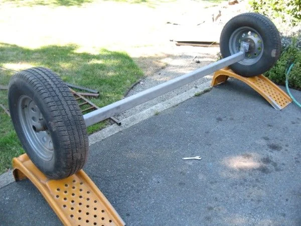

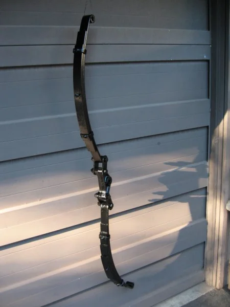

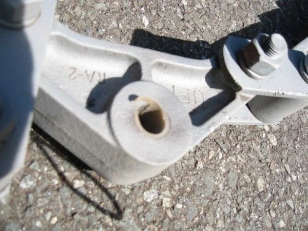

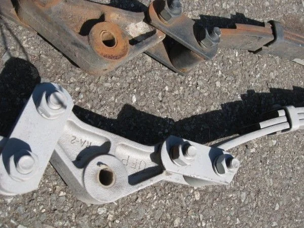

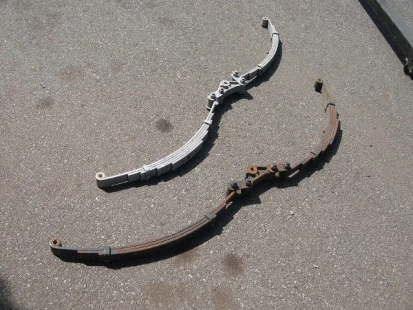

I haven't posted pictures for a while so I'll post up the progress. Yesterday I sandblasted the axles and a spring, then ran out of time. Had enought light to put some DP90 on the parts and painted them with the OMNI line tonight.
Need to order spring pins and U-bolts and do a little more sandblasting / painting ... then The trailer will be back to new.
My 150lb drop blaster cleans junk 3 times quicker than the cabinet.
few more. Painting axles on ramps like these makes it pretty easy.
Thats it. Paint is almost done, Trailer is looking good as it gets pieced back together.
