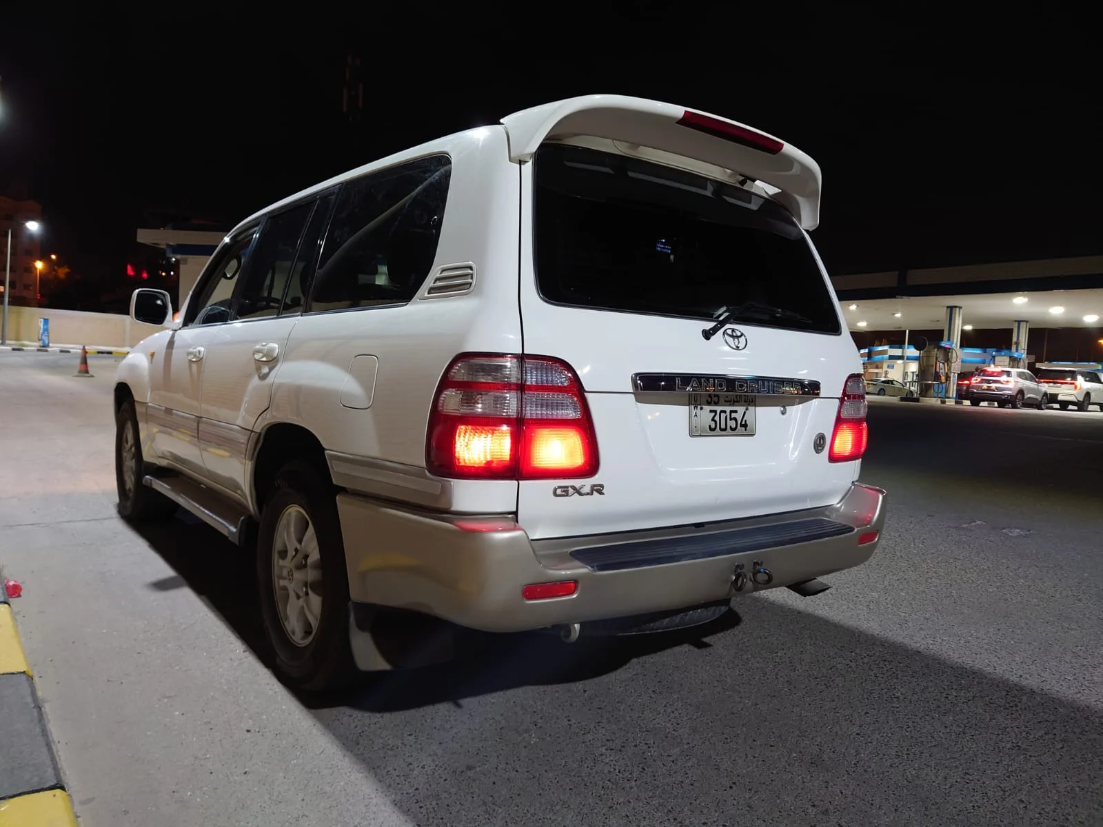

Hello everyone,
I am new to this forum and excited to be here. I recently acquired a beautiful Land Cruiser, my first one. Previously, I owned a Toyota Land Cruiser Prado J120, which I enjoyed, but I have always wanted an LC100, so here I am.
I am seeking assistance with a few issues I’ve encountered:
The vehicle is a 2003 model year with GCC specifications, featuring a 1FZ-FE engine and a 5-speed automatic transmission.
### Issues:
1. **Performance:** The car feels sluggish and requires significant pedal pressure to reach speed. I suspect it may need a tune-up or similar maintenance.
2. **Fuel Efficiency:** The mileage seems quite poor. It has two fuel tanks, with the main tank holding 90 liters. After filling up, I am only getting between 300 to 340 kilometers, which I find concerning. For context, my Prado with a 2GR-FE engine would achieve over 1200 kilometers with both tanks filled (150 liters combined). In this Land Cruiser, I struggle to reach 500 kilometers with both tanks.
3. **Heat Issue:** The center console becomes very hot, to the point where a water bottle placed there gets excessively warm, and the gear shifter is difficult to touch. I would appreciate any insights into what might be causing this issue.
Thank you for your time and any suggestions you may have. Additionally, if there are any other aspects of this vehicle that I should be aware of or check, please let me know.
Wishing everyone a great day!
