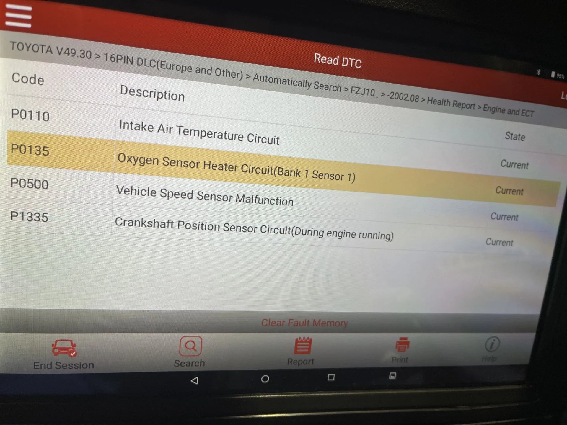

Image of the codes that appeared after scanning with an OBD scanner yesterday. Basically the same result of all the FJZ100Ls that I have scanned (in exception to the crankshaft position sensor). The MAF which is located in the intake manifold is the only component that is required(of course, otherwise the ECU would be completely blind). Unlike the 80 series which has a MAF attached to the air cleaner. The air temp sensor is an additional small sensor available in the FJZ100Ls which is never actually used here. Nobody runs it or so it seems from the hundred of cruisers I have seen.

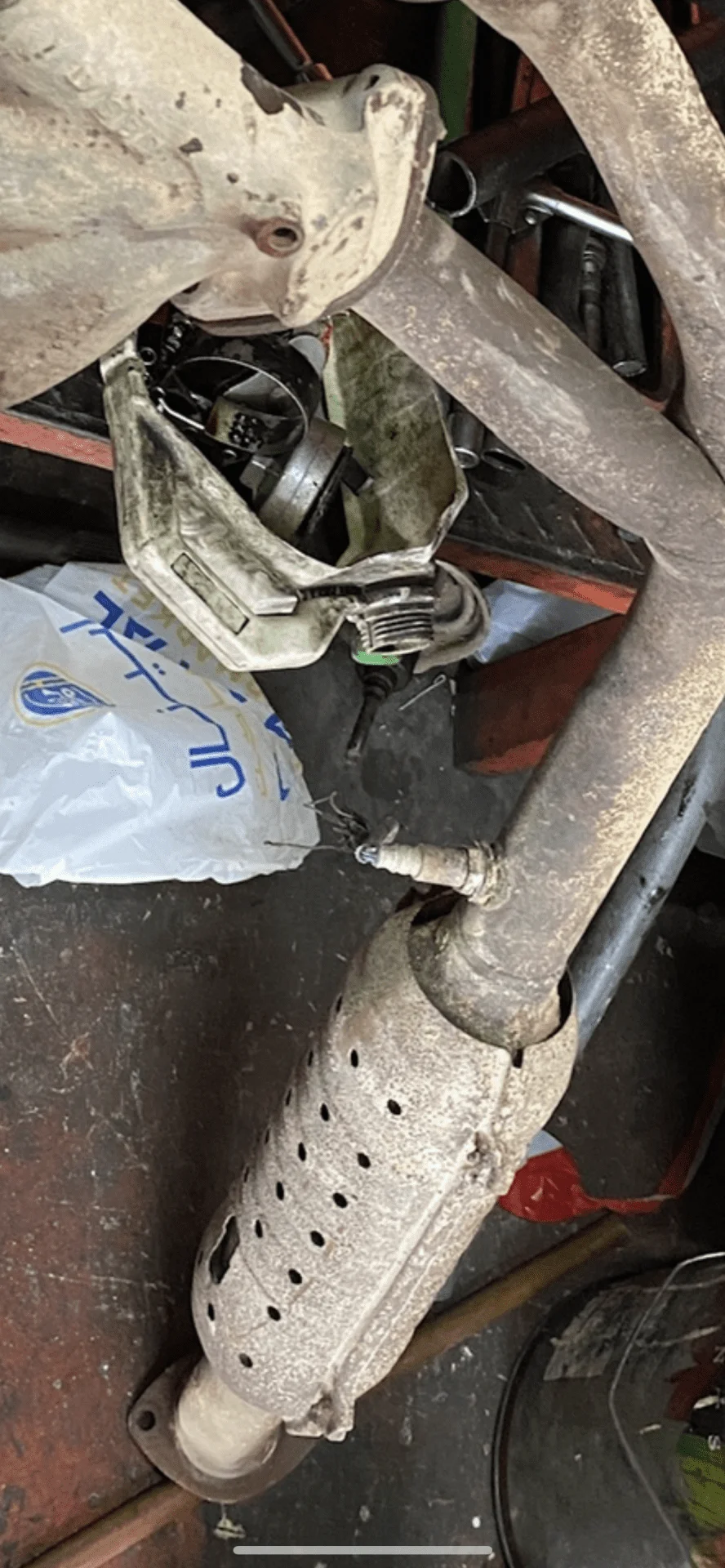

A picture of what most oxygen sensors look like on FJZ100s here, disconnected with the sensor acting as a plug.

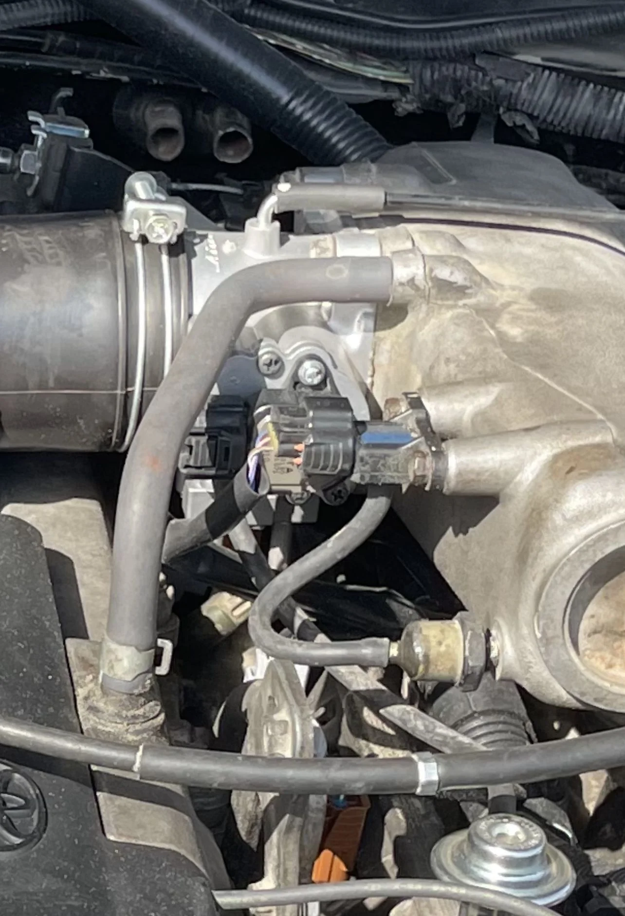

A picture of what most air temp sensors look like, also disconnected lol.

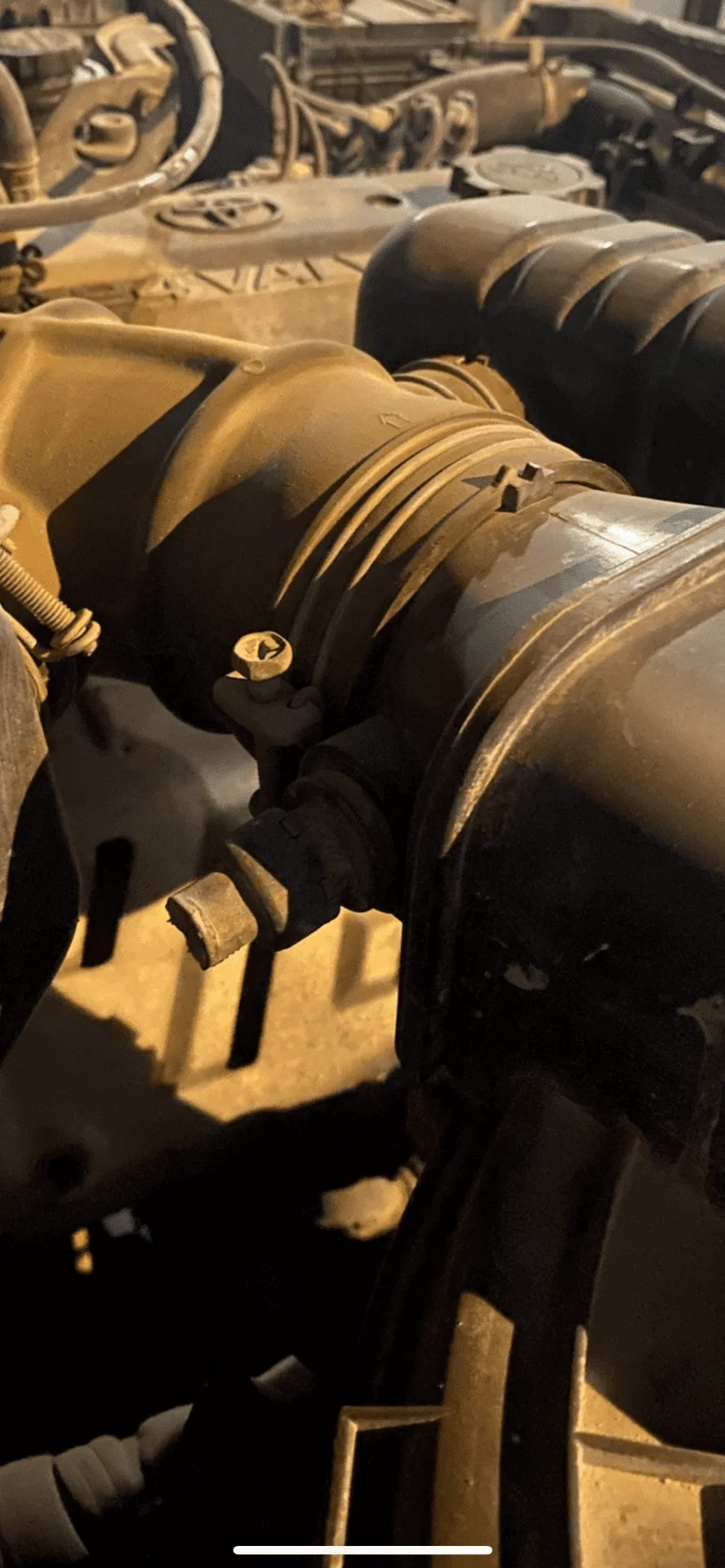

MAF Sensor (on intake manifold)
A picture of the air temp sensor that fits on the airbox.

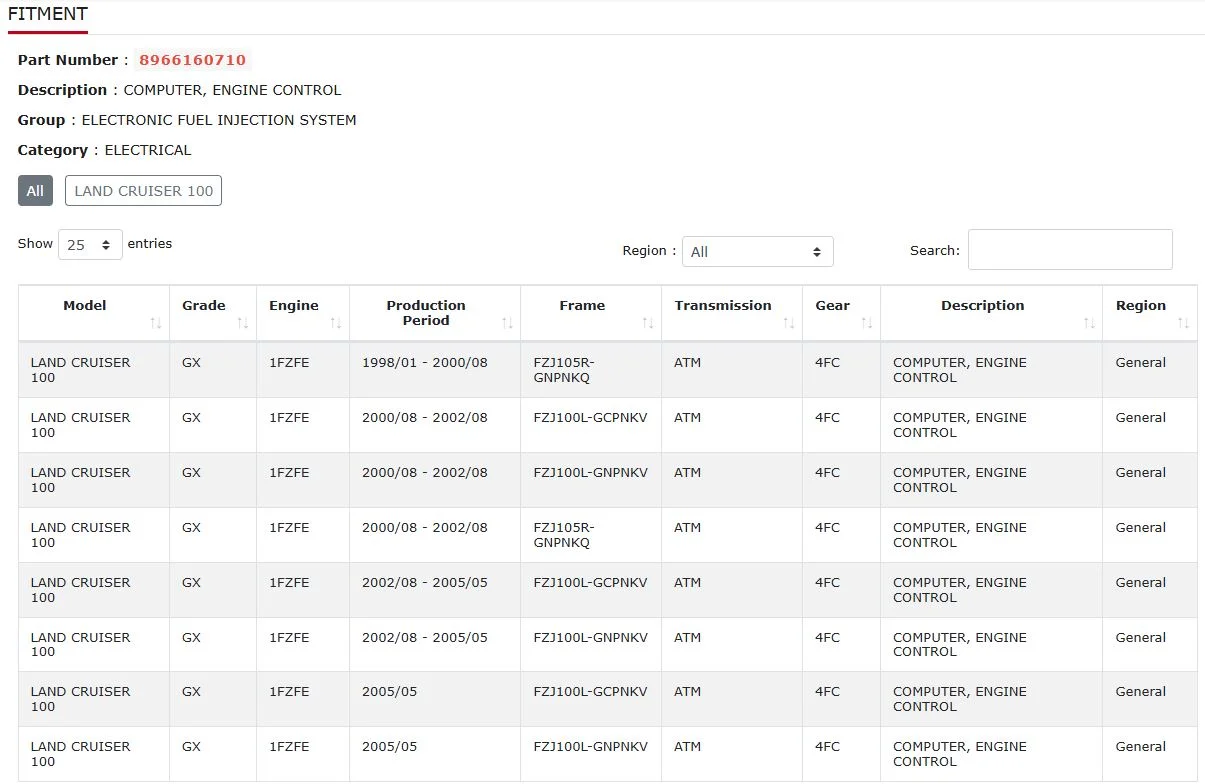

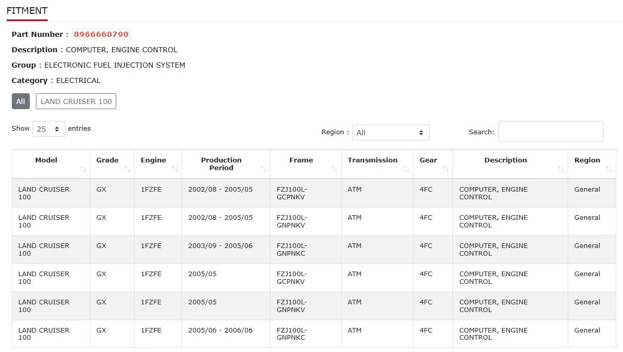

Additional info: managed to read the OBD. No fault codes, No O2 sensors. My ECU is 89661-60710 (Australia and GCC). For GCC (China, Peru, Saudi) after 2002 there was an other ECU with number 89666-60790.
Also in the attachments the NEW FEATURES that includes a Three-Way catalyst (TWC) for the J100 model with 1FZ-FE engine for Saudi, Peru and China after 2002-08.
Short conclusion: There where 2 models with same engine. One WITH and one WITHOUT O2 sensors. Pre 2002 (GCC and Australia) without and for some after 2002 (GCC) with sensors and TWC. Noticeable that the models after 2002 also have another ECU.
Resume:
* FZJ105 - GCC (general)/ Australia - NO O2 sensors. ECU #89661-60710
* FZJ100 - GCC (general) 1998-2005 - NO O2 sensors. ECU #89661-60710
* FZJ100 - GCC (Saudi, China, Peru) 2002-2006 - O2 sensors. ECU #89666-60790
This could explain why some models have O2 sensors and some don't.

If checking the wire diagram of the 2000-2002 J100 it seems Saudi and China had the same ECU (89661-60710) as GCC countries. But GCC is running with VAF and China/ Saudi is running via O2-sensor. The China/Saudi ports on the ECU are also different (marked with a colour).
There are 3 different ECU's for Automatic transmission:
- 1998-2000 = 89661-60680. Wire diagram shows no O2 sensor
- 2000-2002 = 89661-60710. Wire diagram shows with (china/ saudi) and without (gcc) O2 sensor
- 2002-2005 = 89661-60710 and 98666-60690. Wire diagram shows with (china/ saudi/ peru) and without (gcc) O2 sensor
It would be clear as 60680 and 60710 are running without O2 sensor and 60690 running with O2 sensor. i.e. in 2002-2005 there where cars delivered with and without and both ECU's (60710 and 60690) where installed in these cars. But that doesn't explain the series 2000-2002 in comparison with the wire diagram. Also these series where delivered with and without O2 sensor checking the diagram.
The other thing is. Toyota NEW FEATURES states that the TWC+O2 sensor where new features from 2002/08...And not 2000/08 - 2002/07.
Question remains. Is 89661-60710 compatible with O2 sensor?
