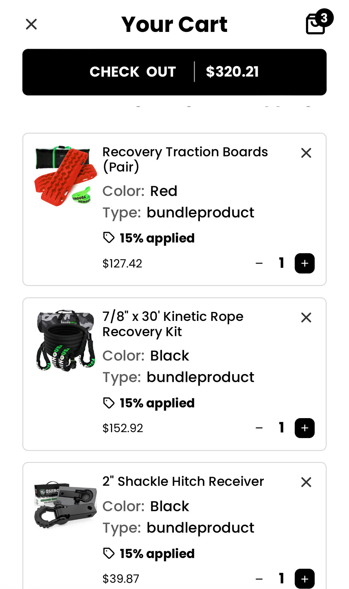

Hey guys!
Getting ready for my first summer in the cruiser and want to start putting together a recovery kit. I’m a broke college student so money is DEFINITELY a factor. However, I want to be safe and know that quality comes at a cost. All this being said I’ve got a shovel and a dream! I’ve been recommended a lot of different pieces of equipment to start and will attach some screenshots of carts I have on a few websites. Please let me know if you have opinions, better brands for value or recommendations on what you think best order to slowly start acquiring these items is!
Carts are from Ironman 4x4 and Rhino USA
Where / what kind of terrain do you anticipate wheeling in?
I see you're in Nevada; I have wheeled a fair amount in the desert west/southwest over the years - I have never owned or seen much of a need for those traction boards at the top of your list, but YMMV. I have used a High-lift jack to get off high-center a few times. If you have some points on your truck to use a high-lift, I would buy one of those before I bought anything else.
If you're going to be wheeling in a group with other folks then yeah, some tow and/or recovery straps would be useful for sure. Personally I prefer the non-kinetic tow straps to the stretchy kinetic ones.
If you're ever going to be on your own, then eventually you will want a winch.
All these seem useful to some degree. If you are really trying to keep the cost down, I would suggest that the tow hitch and towing points are somewhat redundant, and that the deflator is not really necessary, as you can deflate manually (preferably with a gauge, but the latter is less costly). So maybe you could start with the rest.
I would further differentiate items for when you are alone and not, favoring the former. Like the towing strap would only come into play if there is another vehicle involved, but if there is, they likely would have a strap themselves or could get one, so that one seems less critical. Being stranded alone is much worse, obviously, so I would put limited funds there. As to the traction boards, my gut feeling would be that they are more useful in mud than in sand, but I don't know that for a fact. Like 1911, I never felt the need for one in the desert, though, it seems to me that with a good vehicle, some care and a shovel you are unlikely to get really stuck. Yes, a Hi-lift would be useful, also as a come along of sorts and those are not too costly. Or you could get an actual come along inexpensively, I got a nice strong used Wyeth on Craigslist for less than $50. But for both you probably also need an extension cable of sorts. The compressor is really good to have I think, but I imagine there must be good ones less expensive than that. And look for all of that used on Craigslist or Facebook. I do put out Wanted items on Craigslist if I think I may need them in the future, there is always somebody not using something and needing $.
The good news is that the most important part of your recovery list is practically free: several gallons of water...! With that and some people knowing where you will be, you will likely be safe, if possibly inconvenienced for a while if stuck.
Front bumper and winch are definitely on the long term list. I am mostly driving around the desert. Lots of dirt and rolling hills, occasional mud when going up to the lakes but for the most part it will be dry and moderate terrain in the summer. Light snow wheeling in the winter in the desert. As a kid my grandpa and I would just ride around with a couple of shovels and a bottle jack. we always seemed to make it home!

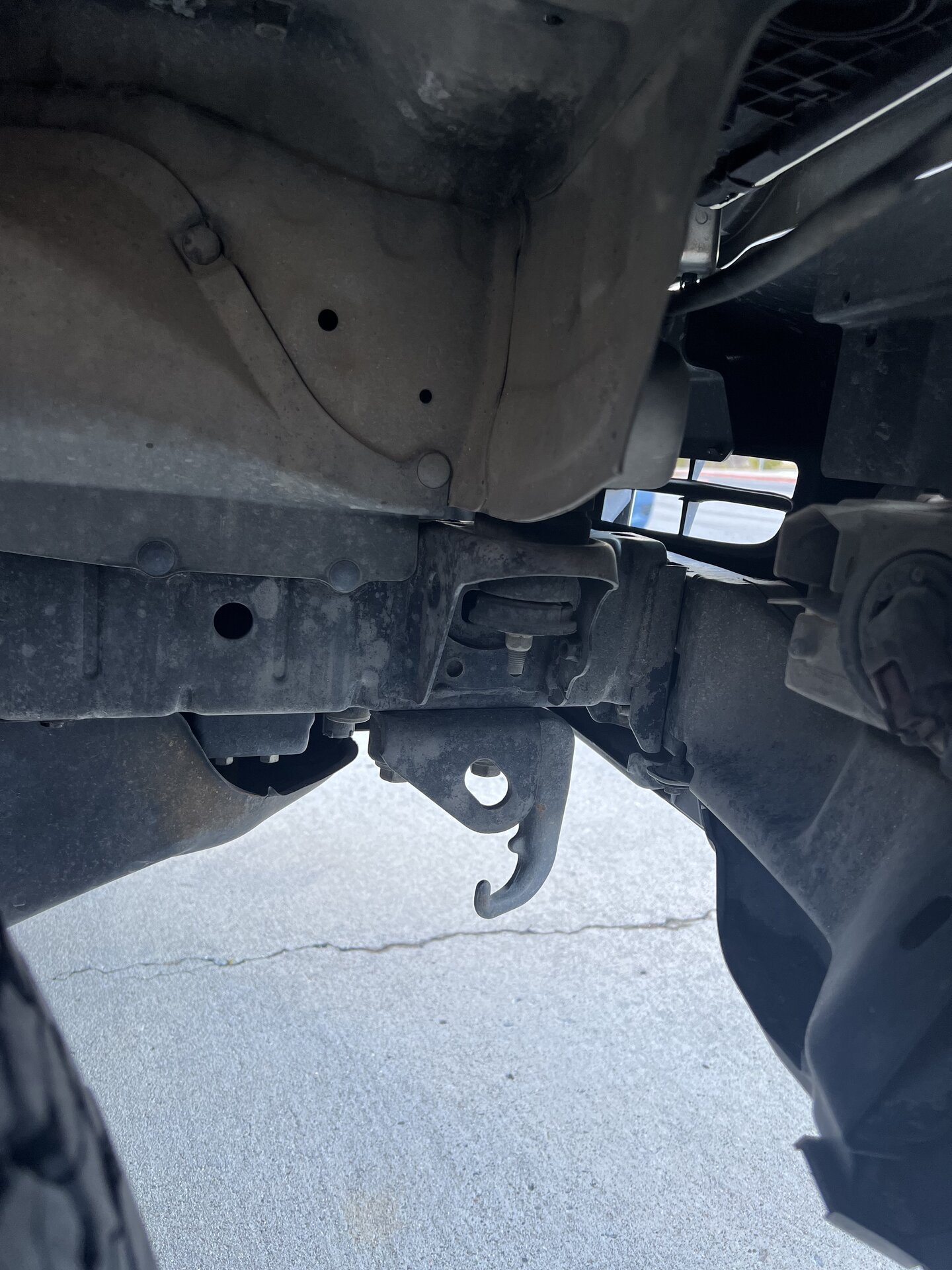

Agreed, after walking around my rig and checking it out more in depth I found that I have 4 recovery points plus two hooks that are all frame mounted. So recovery points are off the list. There are a ton of high lifts on Facebook, for cheap but I’m not sure about lifting points on my basically stock truck. Thoughts on a bottle jack vs the high lift? Always have an emergency kit with first aid, 5gallon water jug blankets, battery jumper, tools etc. just nothing specific to getting unstuck!
Check that those are actual recovery points. If you are talking about the stock thin plates with a hole type of thing, those are AFAIK only meant for tie down on the ships, not real recovery, and you may not want to pull hard on those. If you have a tow hitch though, that might be enough in a pinch.

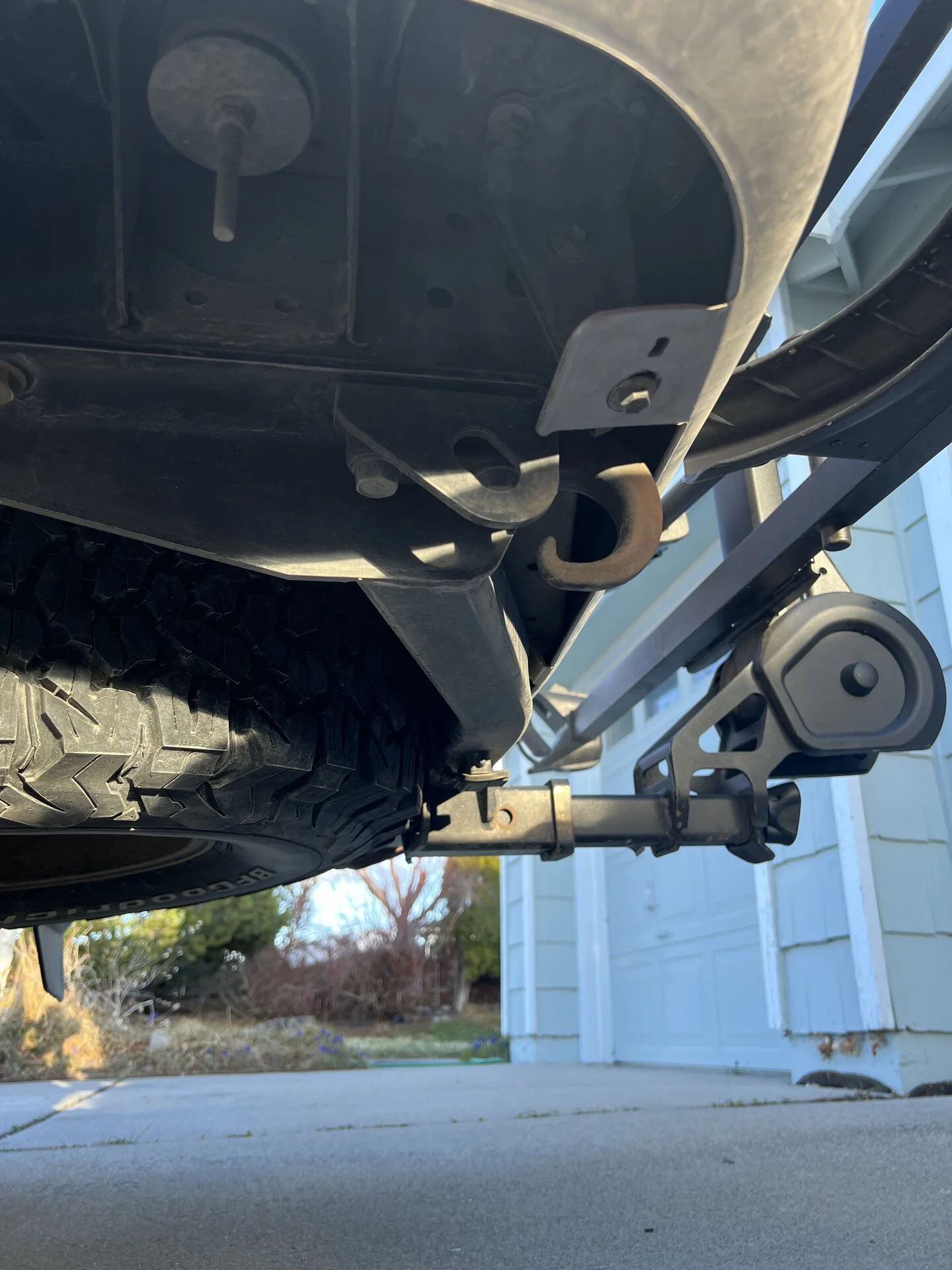

These are the recovery points I was referring to. Are these the afaik points or are these good for recovery? They were in the same frame mounted spot as the Ironman recovery points I had been looking at.
Looks like you’ve got both the recovery and the tie down points.
One thing to consider with a winch is if you’ll have access to anchor points to winch from where you generally wheel. Most of what I do is in the woods, there is generally a big tree within reach. If you’re out in the desert there might not be anything to hook to.
the hook is intended for recovery, but yes, the others appear to be the tie down points. Now, whether the latter are suitable for recovery is arguably a debatable point. It's a matter of how much of a pull, obviously. Clearly, companies selling heavier duty ones play up the notion that the OEMs are not strong enough, but that is subjective and possibly/likely just a marketing aid. Not that it all matters much if you have the hook anyway. As to your OP, you are probably fine with all that and the tow hitch in addition, so that's all good if the front has a recovery point too.
About the winch in the desert, yes, anchoring is a potential issue. However, you can sometimes find big rocks to pull from (if you have a long enough strap or cable) and you can possibly bury your spare as an anchor in a pinch (not that this would be a fun job under a blazing sun).

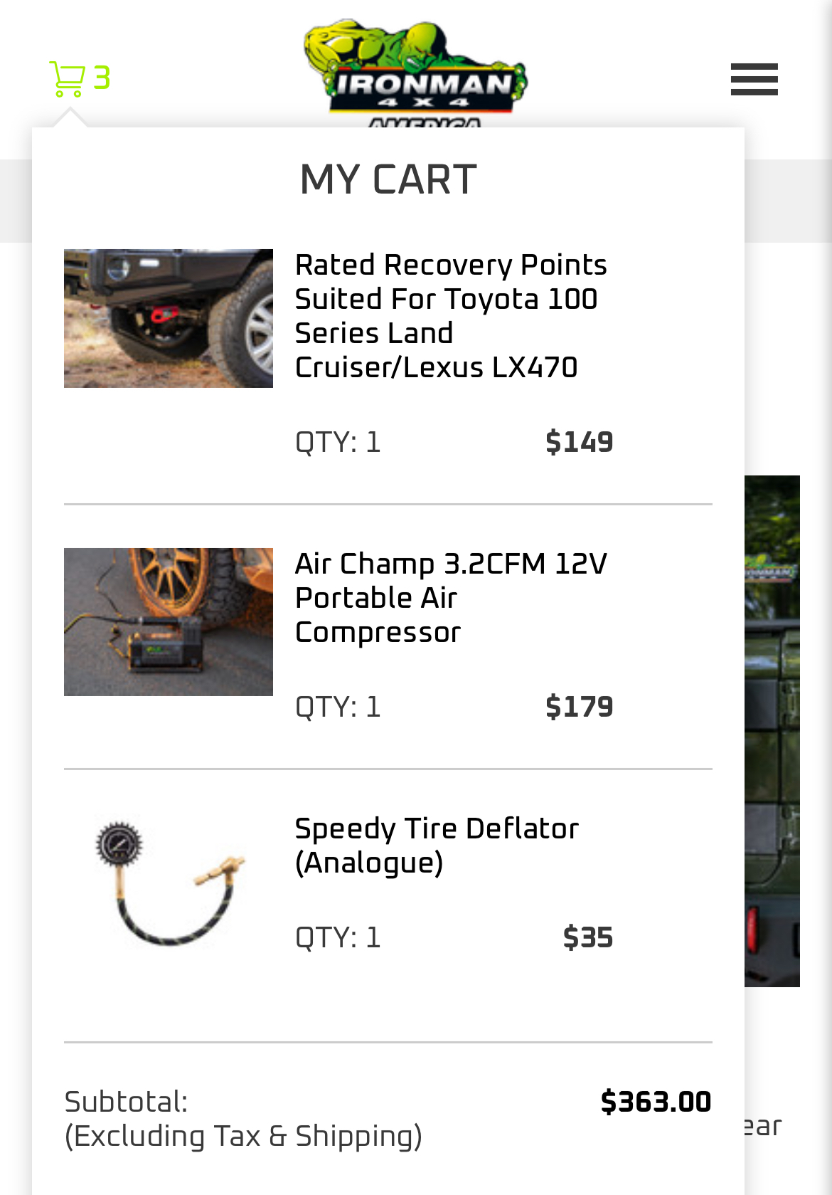

Out of all those items I'd put most of the money into the compressor, that's probably the one item you'll be using all the time vs. everything else that might never get used.
Traction boards - Never used them, for the price and amount of room they take up I can't justify bringing them unless there's a very high probability of using them. If you go solo then maybe there's more of a need for them, but if you have another vehicle it's probably not necessary.
Kinetic Rope- I have one, never used it. If you have another vehicle to pull you out, a tow strap work and I'm a lot more comfortable with a controlled pull than a snatch. In deep mud or sand I can see the usefulness but you'd have to use some strong recovery points
Shackle Receiver - I'd skip it. Even though some people don't recommend it, I've used the hitch pin for minor pulls and it works fine. for major pulls I'd not sure I'd use the receiver in the first place
Recovery points - the ones you have look fine unless you're going into deep mud
Compressor - for $179 I think you can either get a much faster compressor, or a better quality. I've gone through a lot of compressors, and for me speed and convenience is a high priority. The faster and easier I can air up, the more likely I am to air down in the first place. The though of spending an hour airing up has led me to go much farther than I should have gone on street pressures. You can get a Viaair 300P for about the same price, or something like a Napa Maxitrac, which admittedly has a questionable quality but it makes up for it with amazing speed.
Deflators - This is something I wish I had invested in sooner. Again, the faster and easier it is to air up and down, the more likely you're going to do it. I use Staun or Coyote's because they're automatic. I tried a few cheaper brands first but should've just gone with Stauns or Coyotes in the first place.
