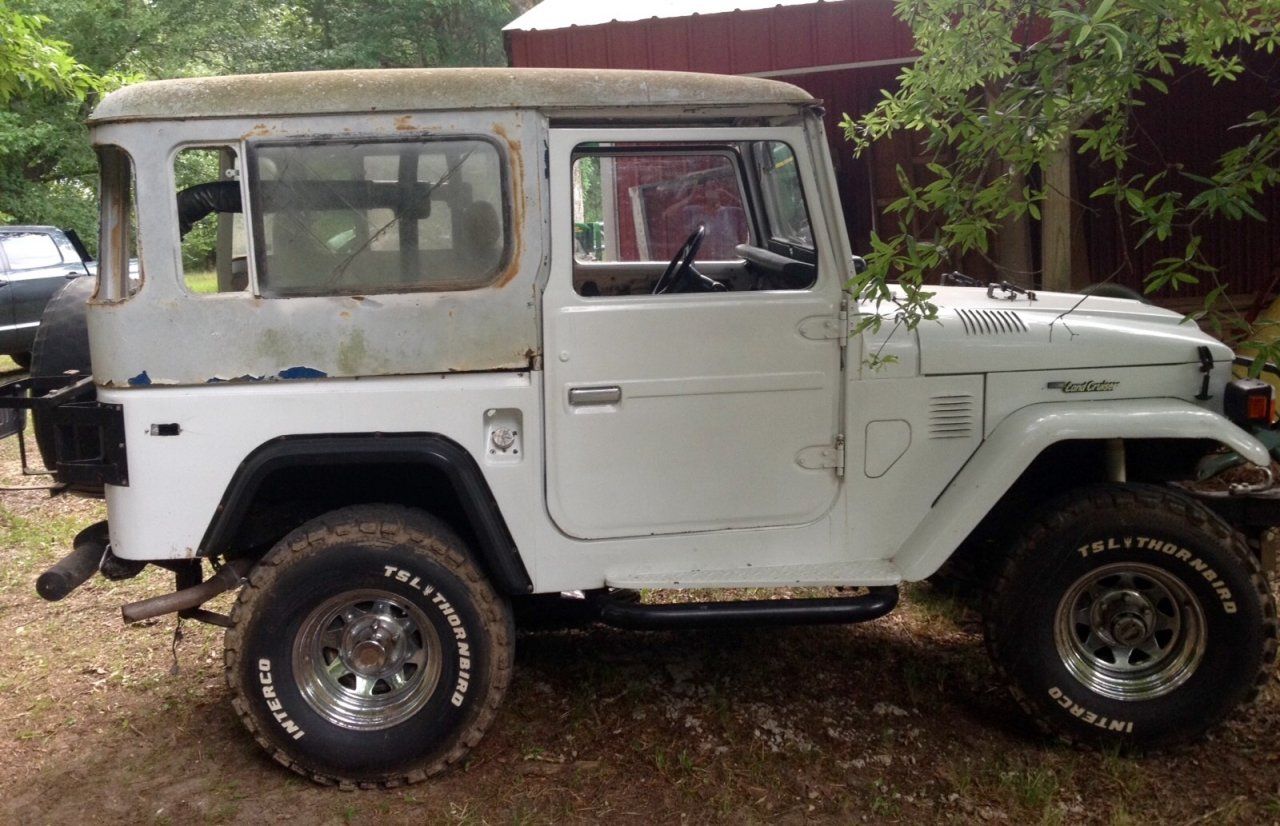

hey all. Newbie here. Been visiting and looking for an fj for some finally pulled the trigger on one last week. Some pics attached. 78. Mostly original. Decent shape. A little surface rust. Doesn't appear to have cancer.
Question. It dies when starting from a stop but just on a hill. In forward or reverse. if I get some speed it doesn't hesitate. Acceleration pump? Other possibilities?
