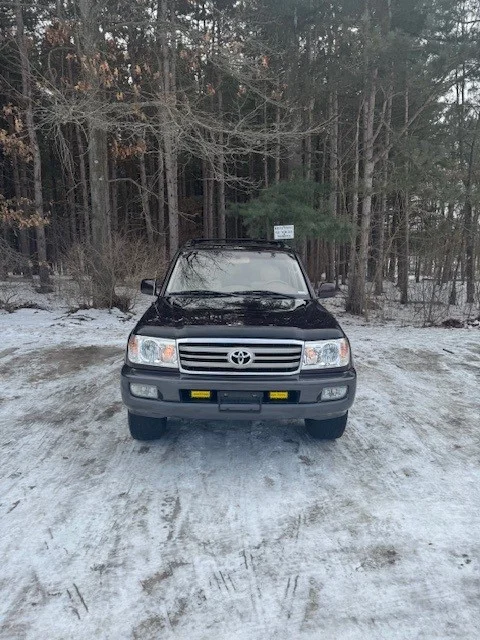

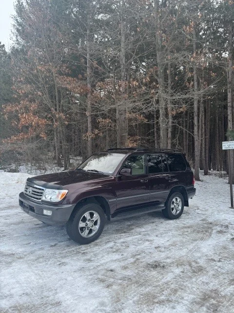

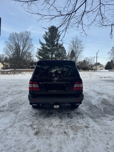

Thanks all, finally got some pics it was a dry day today!
Congrats on snagging the most sought after 100 Series - the '06/'07 Black Garnet Pearl! Okay, okay, I'm a little biased. But wow... your pics brought me back 15 years and 160,000 (ish) miles!
Love it! My favorite color. Looks super clean for the miles!
Great looking truck!

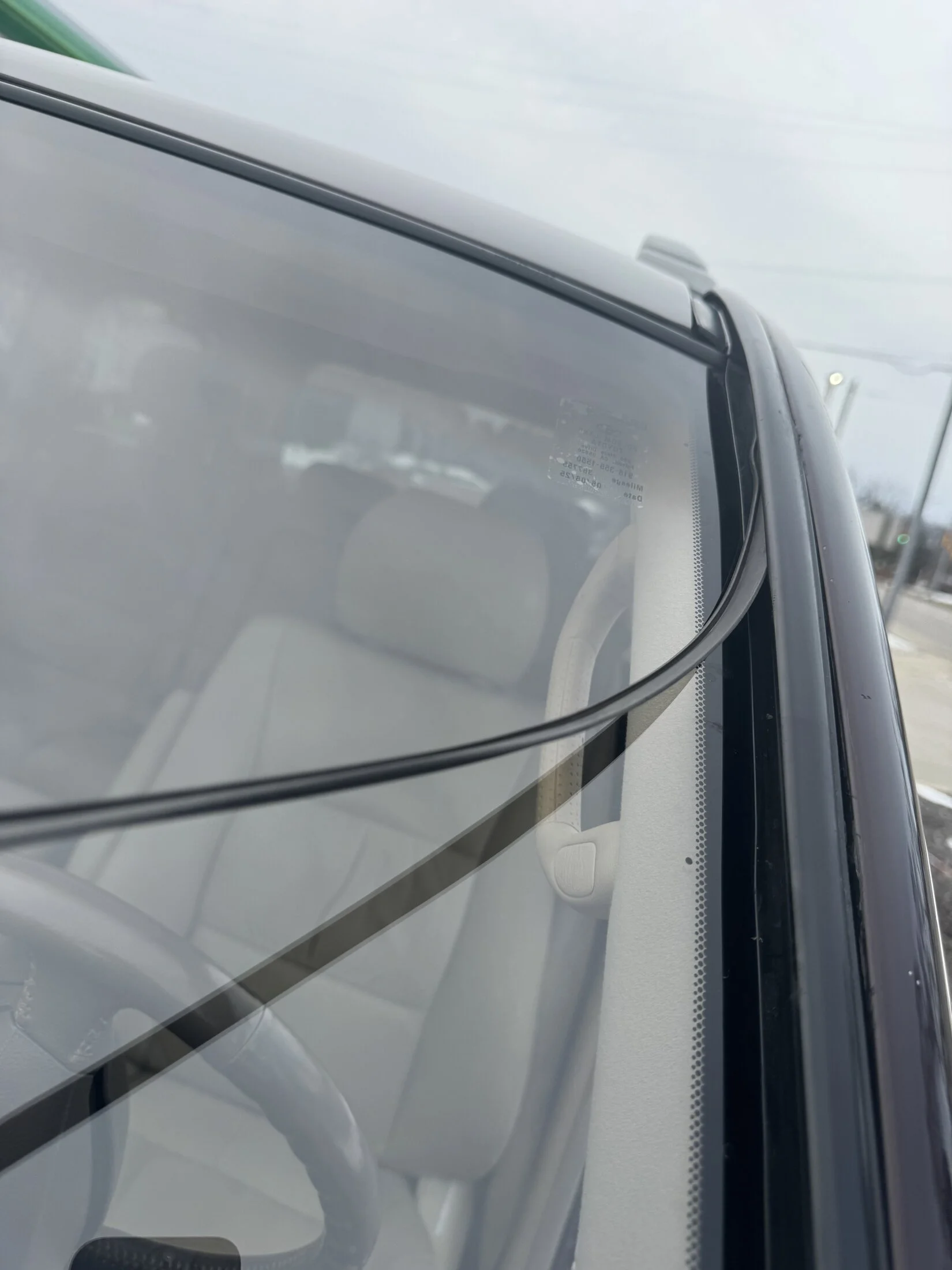

Thanks! Undercarriage is for sure. There are dings and scratches that need addressing, i did order some touch up paint. Overall it is quite clean for the miles, although little things like this will probably continue to pop up. This just happened today and it looks like there is plenty of info on here about windshield molding… not even sure where to start with this one

That trim piece just sits over the rivets and is a press fit. Should be able to snap it back in.
The molding should be tight to the a pillar. Hard to tell on the photo but looks like it may not be flush. Worth checking, don't want water intrusion. Hopefully proper rivets were used for install.

It does not appear to be flush.
It looks similar on the other side as well. It just looks like the glue holding that piece to the A pillar is coming apart.
Sorry, what’s the glass bug?
Look into where that strip came off. You should be able to see 4 rivets. You shouldnt see glue in the pillar channel.
The bug is whats printed on the glass to identify it. Usually in the driver or passenger lower corner.
I would be shocked if tthe glass is original.
