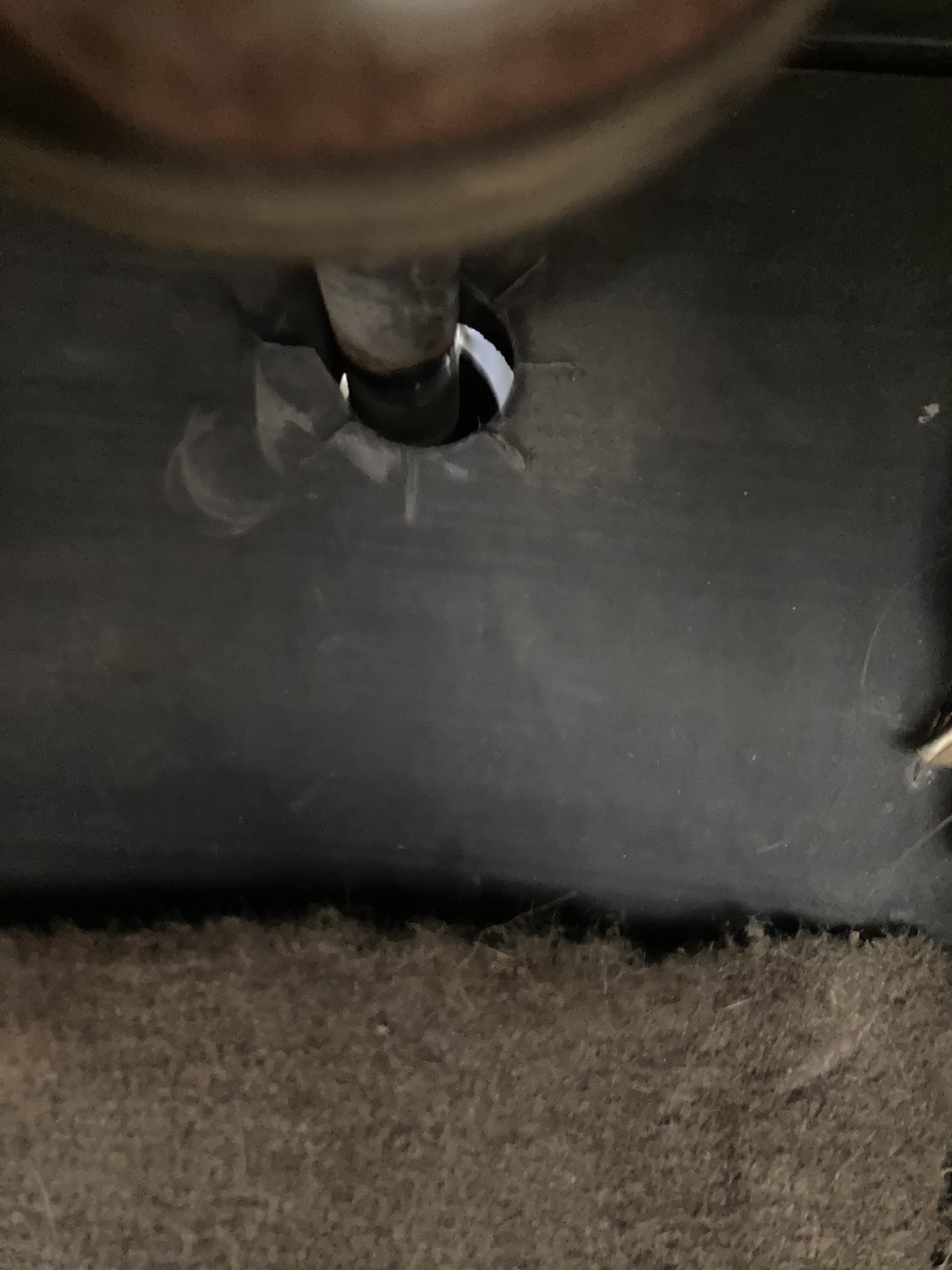

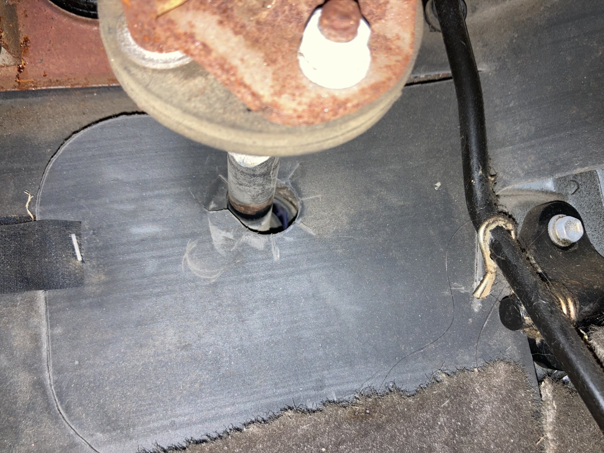

Now that you mention it though I was able to see daylight through my footwell area when I was working under there through the hole below, can’t remember if that was the steering column though. Is there supposed to be a seal in this location?
View attachment 3000980View attachment 3000982
Yes. That's your steering shaft and the seal is on the firewall on the INSIDE.
When you have the sunroof open, it draws air from the cabin and since that seal is shot, it draws air from the engine compartment and you will get the WD 40 smell.
That's why I suggested to replace it.
To find what I'm talking about, look up "hot feet". I didn't say you HAD hot feet.
Thanks, I read through it and it doesn’t seem too hard to take care of that, so I’ll order that part. I didn’t realise a little seal like that could play such a big role in preventing fumes from entering the cabin.
