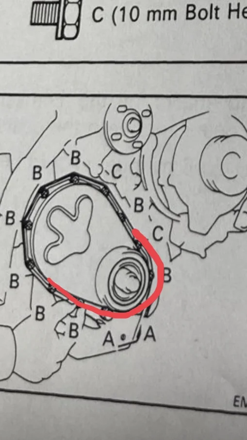

There should be fipg on the bottom half of the timing cover gasket where the oil sits while it’s parked. Look at the factory service manual for the engine overhaul to see where to apply it. Also there are specific bolts and studs that have different torque values and lengths so make sure you get that right or it will leak.

Hmmm... you’re right. I have a different manual and it doesn’t show it. I wonder where I learned that??? Anyhow, I’ve put the black goop around where I marked in red here. The first time I did the job I messed up the torque values and broke the aftermarket gasket. Last time I used Toyota parts and did the torque sequence correctly. But I still added the sealer and I haven’t had any leaks.
Hmmm... you’re right. I have a different manual and it doesn’t show it. I wonder where I learned that??? Anyhow, I’ve put the black goop around where I marked in red here. The first time I did the job I messed up the torque values and broke the aftermarket gasket. Last time I used Toyota parts and did the torque sequence correctly. But I still added the sealer and I haven’t had any leaks.View attachment 2742665

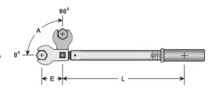

I used a crowfoot adapter on a torque wrench at 90 degrees to get at the lower bolts with the pulley on. Slid the pulley on to set the cover in place, then torqued the bolts. Your way prolly works just as well.
Does this not change the torque values of the wrench? I’ve always avoided using adapters or swivels on my torque wrench unless it’s a straight extension. Never thought of using a crows foot though. The ‘E’ measurement lengthens the wrench, so doesn’t that affect the foot pounds? And shouldn’t you compensate with your torque settings if you’re going to use this method? Or is it a negligible difference?
Another hotly debated automotive topic. I generally avoid adapters on mine as well. It does change the value if its not set at 90 degrees when you turn it. For clarity, what I mean by 90 degrees, is orienting the crows foot where its opening is 90 degrees turned from pointing straight out so the opening is pointed out sideways on the wrench. I think the idea is when the crows foot is pointed straight out, it increases the length of the wrench and where the bolt is distance wise from the handle, thus changing the torque value you are applying when you wrench. When you set it at a 90 degree angle, it is the same distance from the bolt to the end of the handle. Allegedly that's enough to allow the values to be pretty much the same as using a normal torque wrench. Whether true or not, I figured it was better than torqueing by feel those bolts with a box wrench. Seems to have worked for me anyhow. HTH.
Edit: Interesting calculator for determining torque with extensions/adapters:
