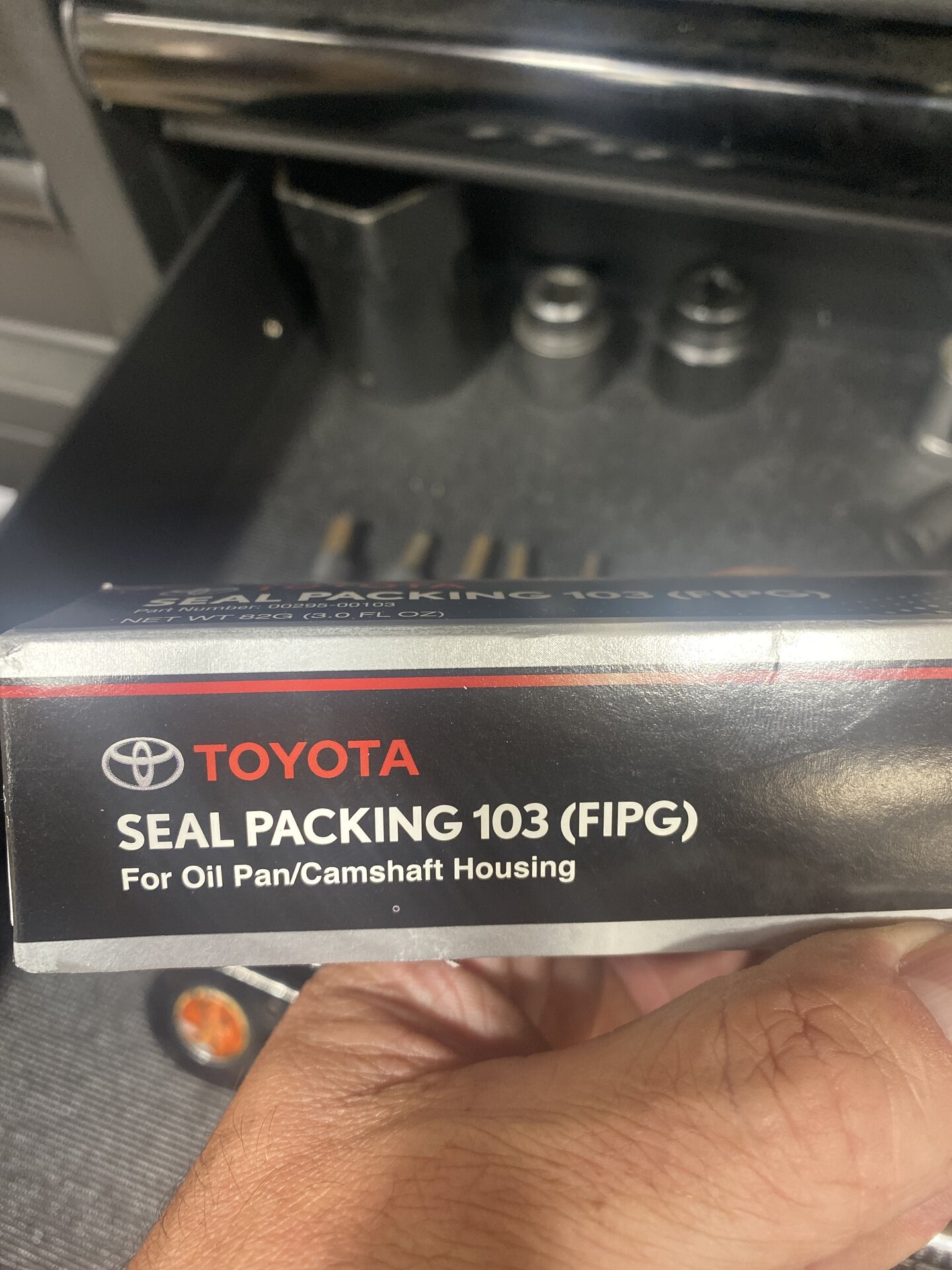

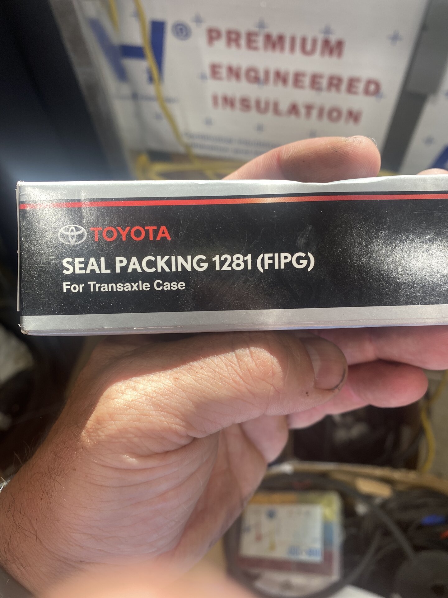

FWIW:
Toyota 103, for engine oil service
Toyota 1281, for gear oil service:

They're both heat & oil resistant silicone based RTV. So, from a product perspective, they are interchangeable. Only Toyota knows why they use both. The color differenecs are to make it easy for maintenace personnel to load the proper stuff. The label comes off a 55 gallon barrel, no one's going to open it to find out what's in it; they just squirt it in a trash can and move on with life.
Oddly, TB1207B is listed for coolant, while Toyota lists a separate coolant sealant. Makes me think they got a bulk order deal from their OEM.
