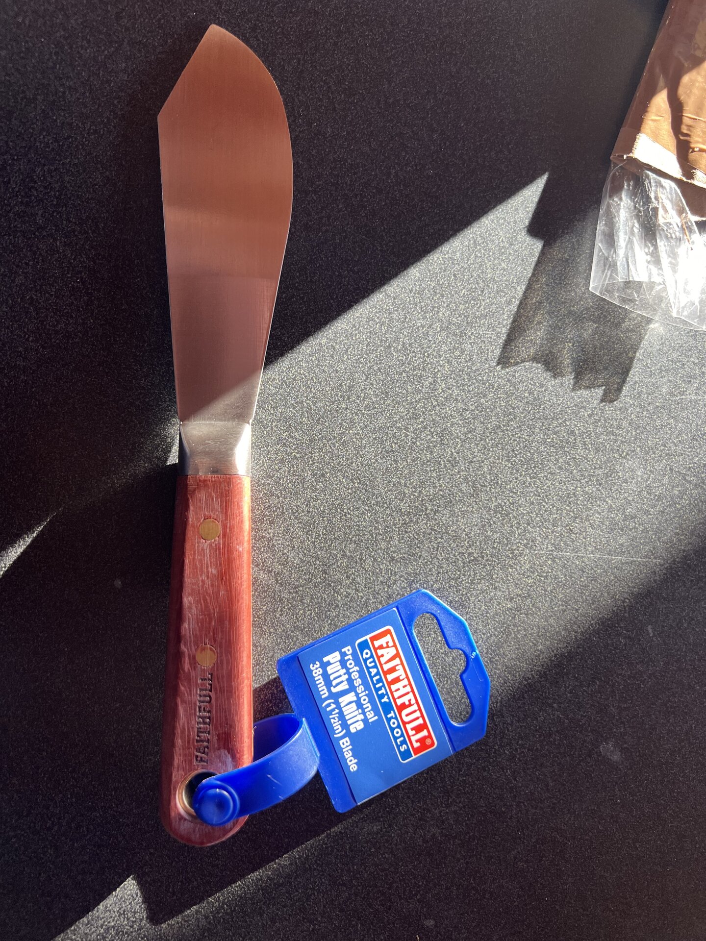

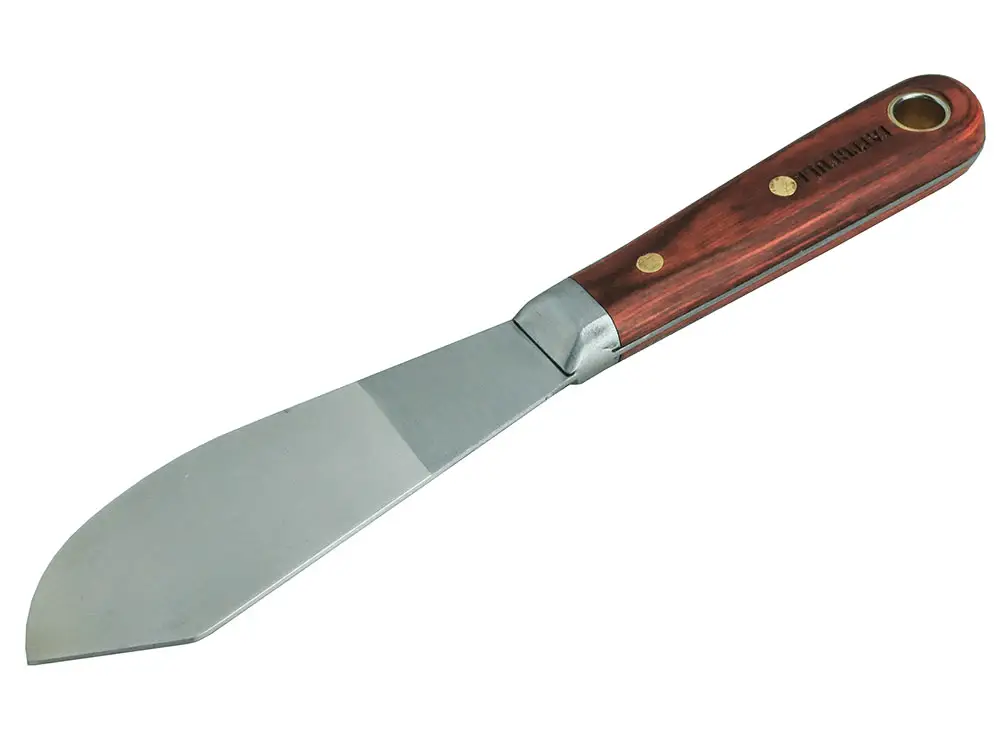

You can do this super easy and smooth in 30 seconds without risk of damage! Get yourself a good putty knife that looks like this:
A few gentle taps with a rubber mallet and it'll go straight through the full thickness of the FIPG. Work it around gently and slowly and the case will release no issues. I've disassembled four gearboxes in the last few months. This is the best way.
EDIT: Looked up the technical name for this style of putty knife - It's called a Clipt Point (or just Clipt) putty knife. It's traditionally used for applying putty to fix glass panes into timber window frames. It's available in any local hardware store in places like Australia, NZ, UK, etc, but google tells me it might be harder to find state-side. None the less, this is definitely the best tool I've seen. A good one has an actual bladed edge and a fine point, so it goes in and works around like a razor blade, but with a strong handle and a lot of leverage. It can pop any kind of seal in a minute flat.

Definitely uncommon in the US. There are a couple available on Amazon, but you have to tell it that you didn't mean "clip putty knife", even though it doesn't have anything called that and DOES have Clipt putty knives. Stupid search engine tricks...

I ordered the clipt scraper ($20, but that's a bargain if it works well), I have one of those gasket removers posted above too. And I will make sure to put my purse down and beat the hell out of it with the big deadblow hammer.

The tool arrived.
Can't hurt to have it in the arsenal.
I agree that this tool seems way too thick to be ideal. I may grind/polish an edge on it.

Well all these months later I just wanted to close the loop. I tore down a transfer case with the tips you all shared. It went flawlessly and I didn't have any breakage. I did use the funky scraper from the UK, bit only after releasing the fipg (I didn't try to drive it through to break the seal) - I mostly just used it because I had it, a paint scraper or screwdriver would have worked fine too. The biggest change I made (due to watching Georg's work) was to use a heavier hammer with a stout brass drift, but knowing where to safely apply force to not break the castings. Doing it this way makes me understand why it is no big deal - proper tools, proper technique and proper force applied to the proper location makes it easy. The trick is knowing - like GI Joe cartoons used to say "knowing is half the battle". Thanks for educating me!!
