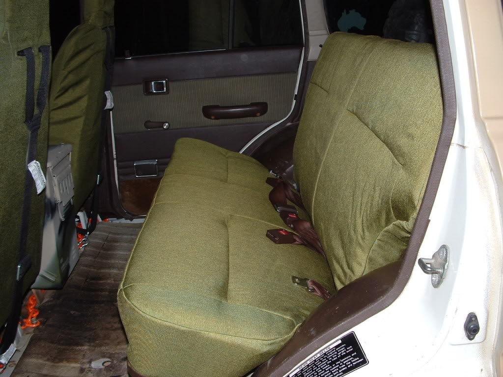

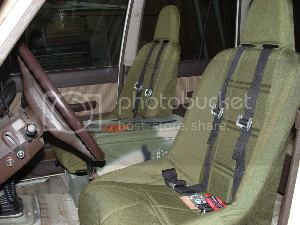

If you followed the earlier thread, https://forum.ih8mud.com/60-series-wagons/255693-final-fix-drivers-seat-tear.html I installed a pair of Mastercraft Military Seats in the 60. That left teh rear seat looking pretty worn out and sad. I ordered matching Cordura an reupholstered the rear seat to match the Mastercrafts. Now I just have to bed-line the floor and I think the interior is nearly done.
Fronts
Backs
Is there supposed to be a metal trim piece at the bottom of the seat back along the carpet-to-fabric edge? It needs one, but I never had it.
No, no trim at the bottom, the fold of the one piece rear carpet covers that area.
See there you go Chris, I thought I was mistaken. As it appears I was correct. I'll still look for that extra top piece when I go home.

How did you install that ammo can? Just remove the stock console and bolt it down?
-Carl
He gave info on the ammo can in his orginal thread, IIRC he bolted to the original mounts somehow, it's a 30 mm ammo can (don't want to get shot with that) and he welded one of the lid latches so it works as a hinge. His last seat thread kind of got overtaken by all of us drooling over the ammo can. He also modified it to lock and attached the factory cupholder
-Carl
Hey Carl, that is correct. IIRC the bolt pattern is 4 1/2 inches wide by 8 1/16, with a 4 inch offset from the front of the can-but I'd have to re-check. I used the stock console mounts because they are welded to the floor. BTW make sure that your holes are exact from left to right. There is no adjustment if they are wrong. If they are off from front to back, you can use a BFH to "adjust" the factory mounts a bit.
