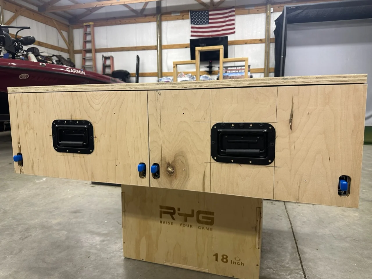

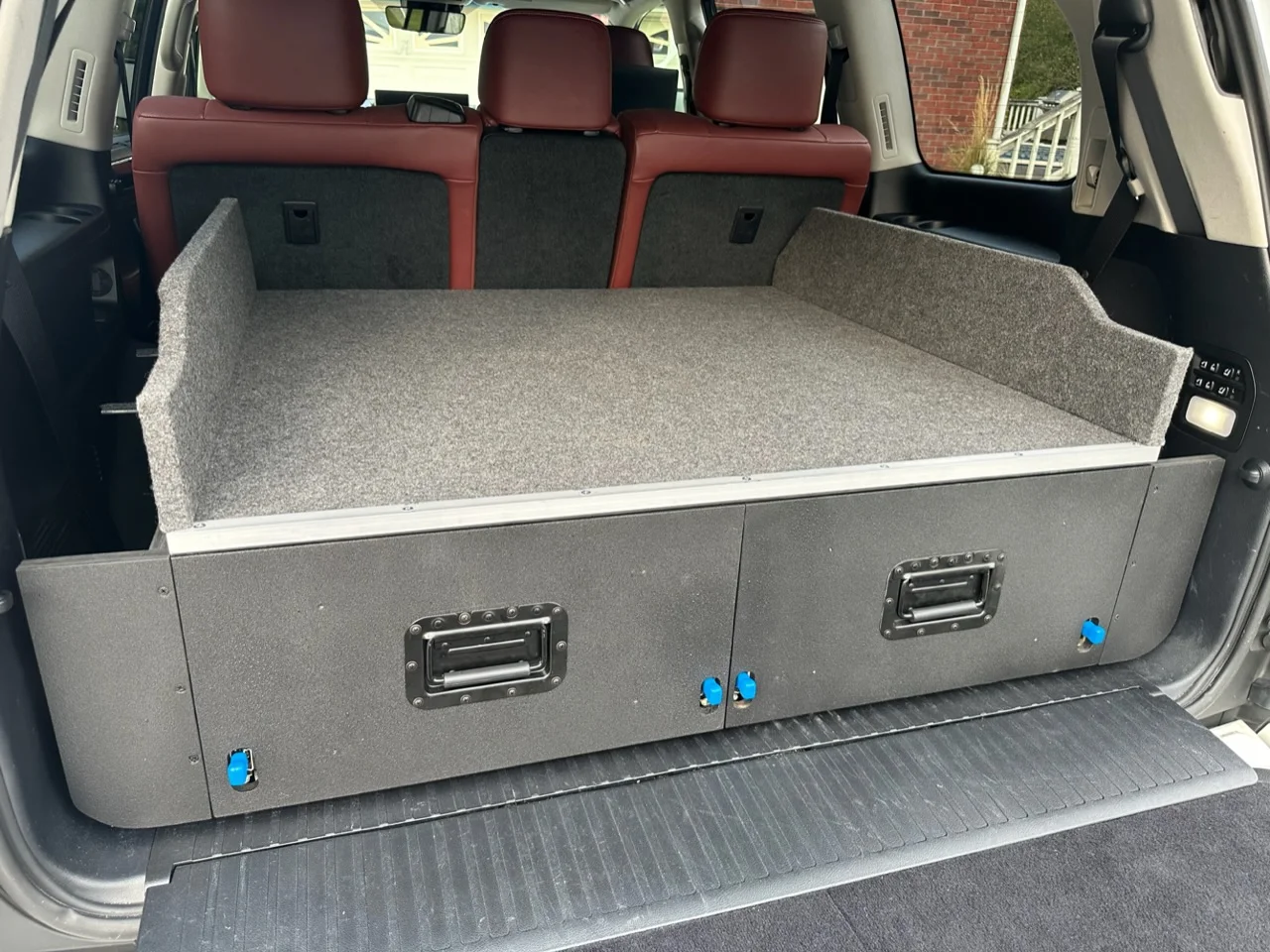

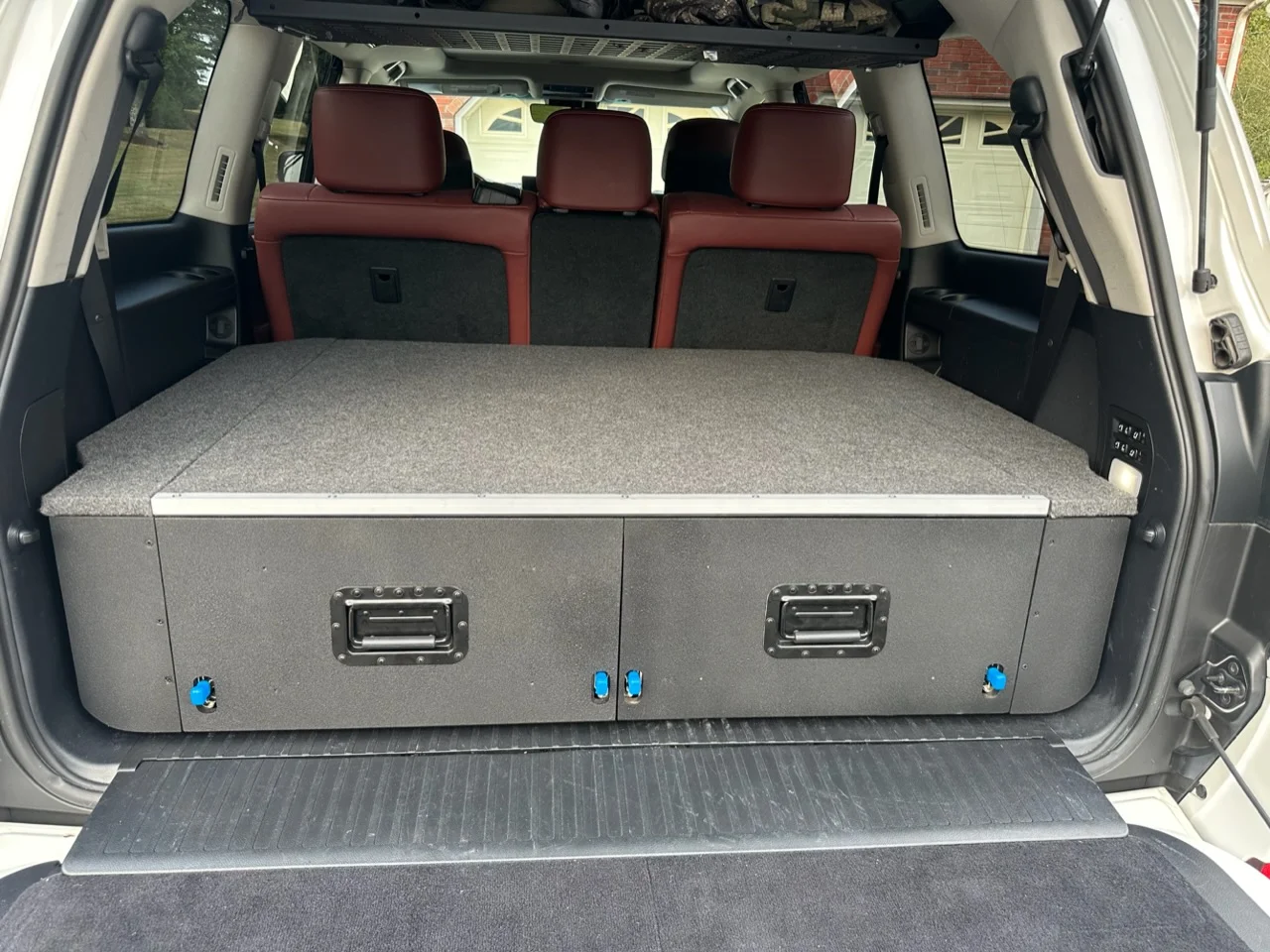

I am a pro precision rifle shooter and wanted a better way to carry all my match gear without being cluttered. I took ideas from several threads and some aftermarket drawer systems. I used 3/4” and 1/2” maple plywood, 250 lb locking drawer slides and t-nuts and screws for the drawer slides. I wanted two big open drawers with one being big enough for my pack. I wanted wings so I could store my compressor, hoses and other items I carry everyday since I have 33” tires and aftermarket wheels. I used speaker carpet inside the drawers and on all sides of the box other than the front, which is raptor liner. I am pleased with how everything turned out.

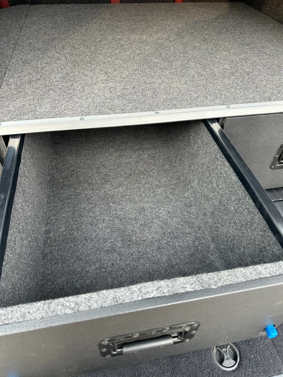

The carpeting on the inside and top will serve you well in regards to cutting down on objects moving in transit. I have ARB drawers in my 2015 and the carpeting on top is very helpful.

It was some rubber channel that had double sided 3m adhesive tape on it. I found it off of Amazon. I wasn’t sure how well it would hold up but so far, it’s done well. I am in and out of these drawers constantly too.
Thanks. It almost looks like aluminum in that picture. I'm familiar with the rubber channel with the adhesive strips.
