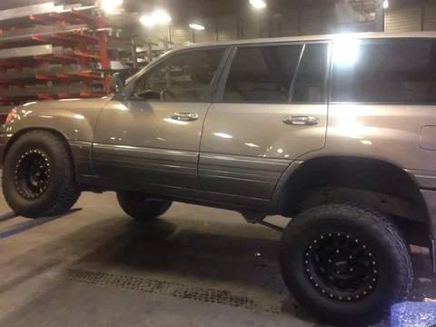

The method wheels look dope. I want those. Wanna sell them?
