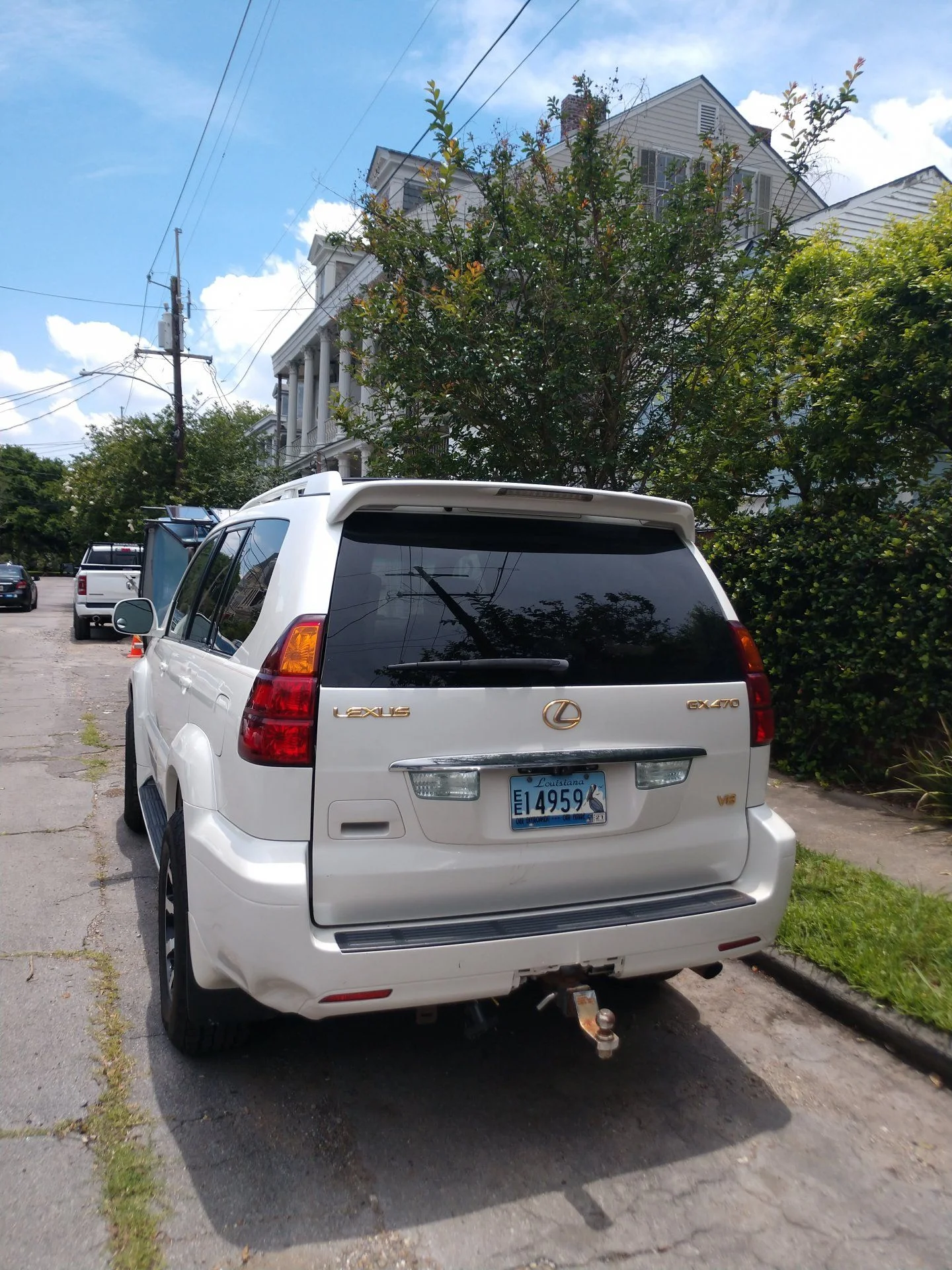

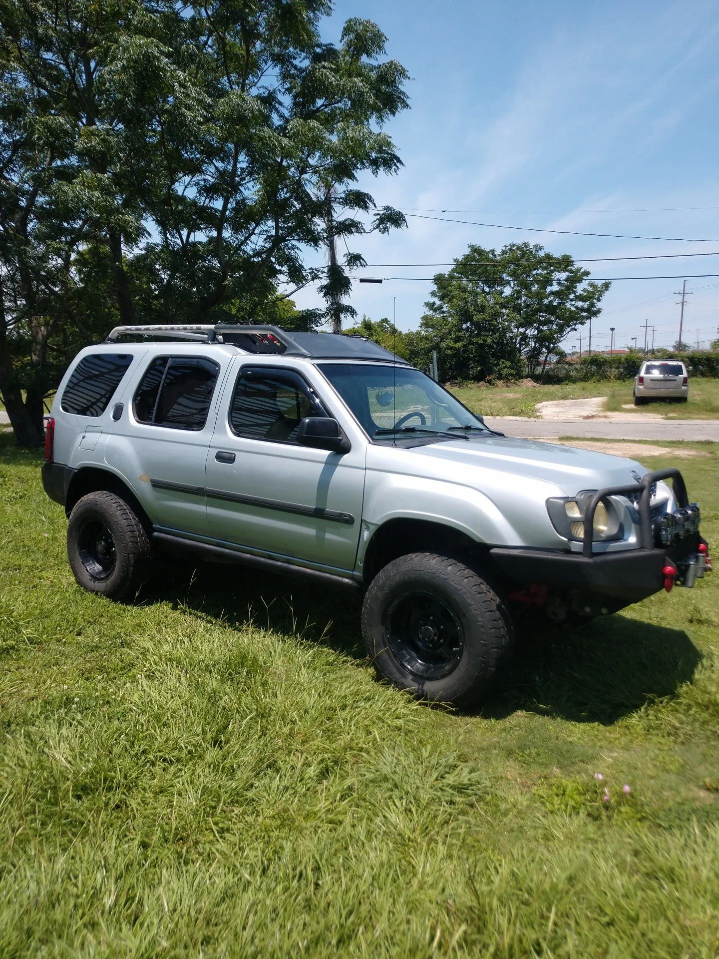

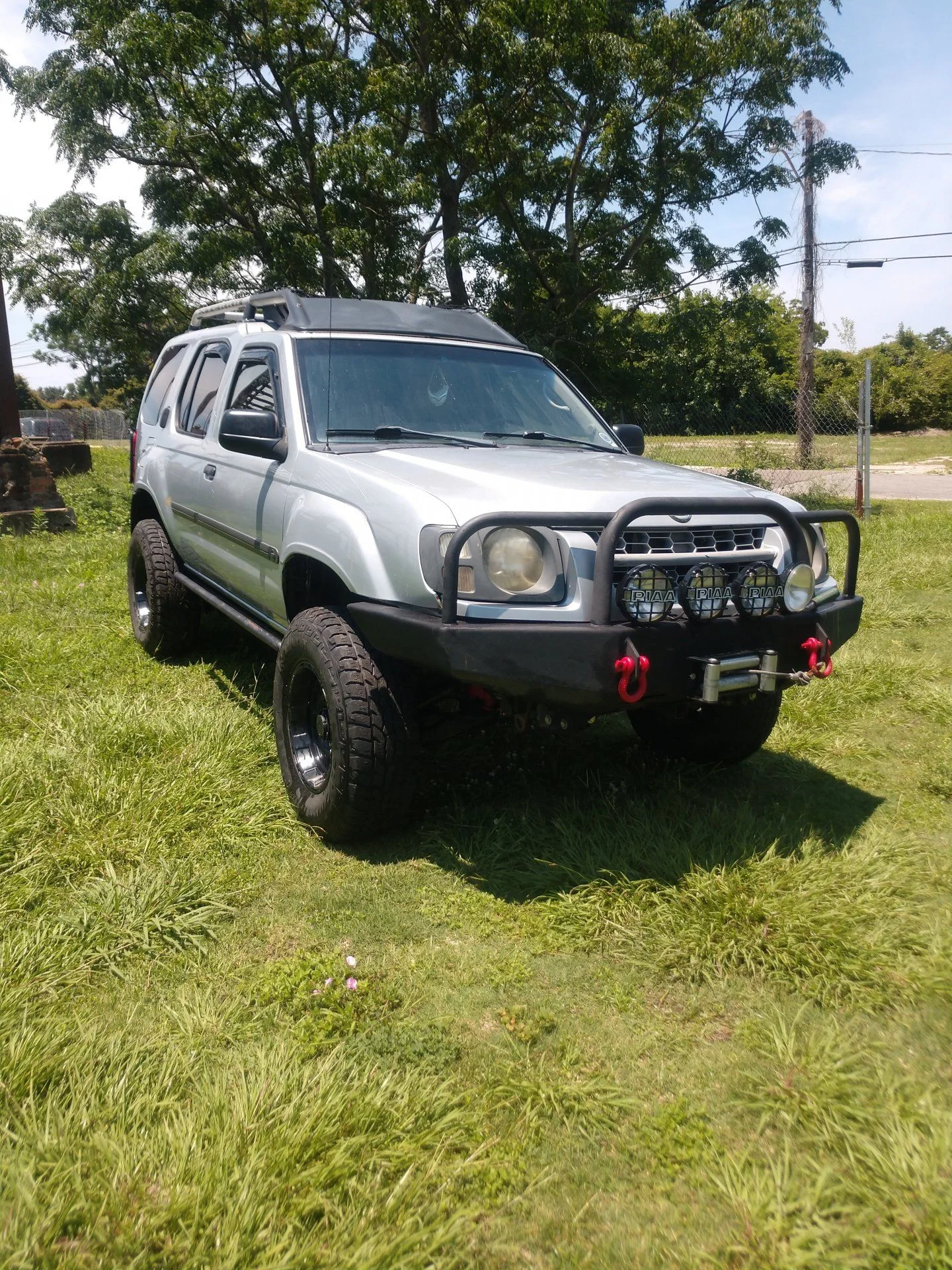

Rear= OEM fj+2" puck so I should be able to order +3" (hopefully 3.5" height) fj springs and if so what's the most budget friendly way to achieve goal in the front. Attached a couple pics of the gx and 1st Gen I sold to get it. At the end if the day I only had to come out if pocket $500 to get the GX but had to include the warn 8000lb winch and pretty rare alpine 12" type x sub in the deal.
