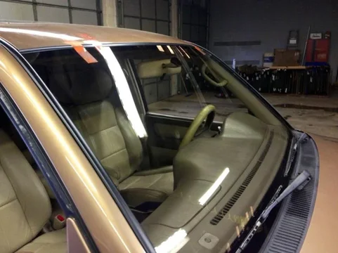

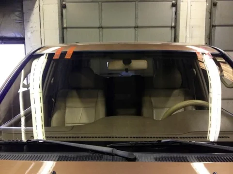

Took two weeks to nail down the best shop to do this.
Guy was awesome. Replaced side mouldings too with brand new ones. No more wind noise...no more water leak. One very happy cruiser owner.
I clean my windshield pretty good from time to time, but how it looks driving out of the shop with the new glass is just nuts. It's like there's nothing there.
You're not kidding. I almost felt the wind whipping through my hair. Then I realized they left the side windows down :) love new glass though.

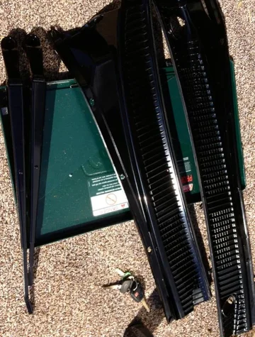

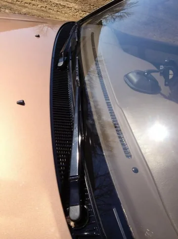

My windshield looked so good, it made my faded wiper arms and vent cover look worse. So today I fixed that:
My insurance carrier uses Safelite for glass claims. They installed Toyota glass. $100 deductible and its a no-fault claim.
Perfect. There have been some threads in the past regarding off-brand glass that isn't of the same quality nor (IIRC) did the installers use the factory rivets. Thread.
The local Safelite did a nice job each time. I knew.nothing about the rivets the first time but got the full story from the tech who obviously knew his stuff. No leaks no wind noise. Just like new. As the op said, the new glass is grin making stuff.

Look for a shop that knows cruisers. My guy was very familiar, used rivets, did a fantastic job. No
Leaks or wind noise. Cheapo installers will actually remove your old glass and leave a bed of urethane behind. They set new urethane on top of that and set the glass which causes all kinds of issues. I know because my first installer did it that way. Leaked, wind noise, etc. be super high maintenance. Ask them about the rivets. Tell them your last jnstaller did a terrible job. FWIW, safelite didn't want to do my glass.

The vent cover... Did you clean & paint or replace? Mine is looking a bit faded and I thought about trying to clean and repaint but I don't know how that will turn out. Thanks!
Not sure I ever responded via pm but I painted them black gloss
