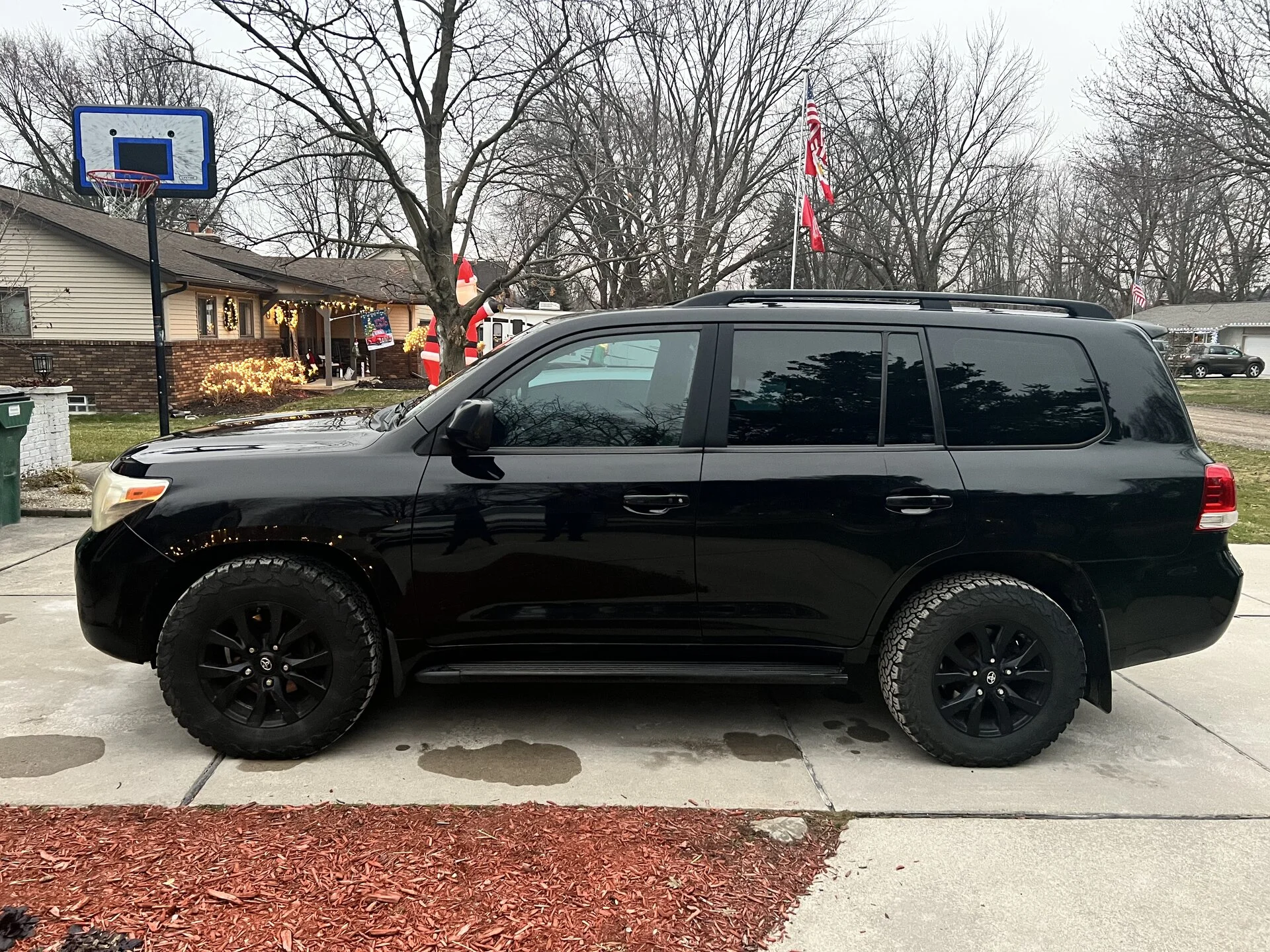

Hi guys, just picked up my first LC last week from South Dakota. Have a few ideas for some tasteful mods. First thing is I want to level it, unfortunately I see a lot of options, 1/2 OEM spacers, 30mm, 50mm, etc… I think I want to go 30mm as that seems to be what would get me level front and rear. Any insights, photos, etc? Really trying to keep it on a tight budget.

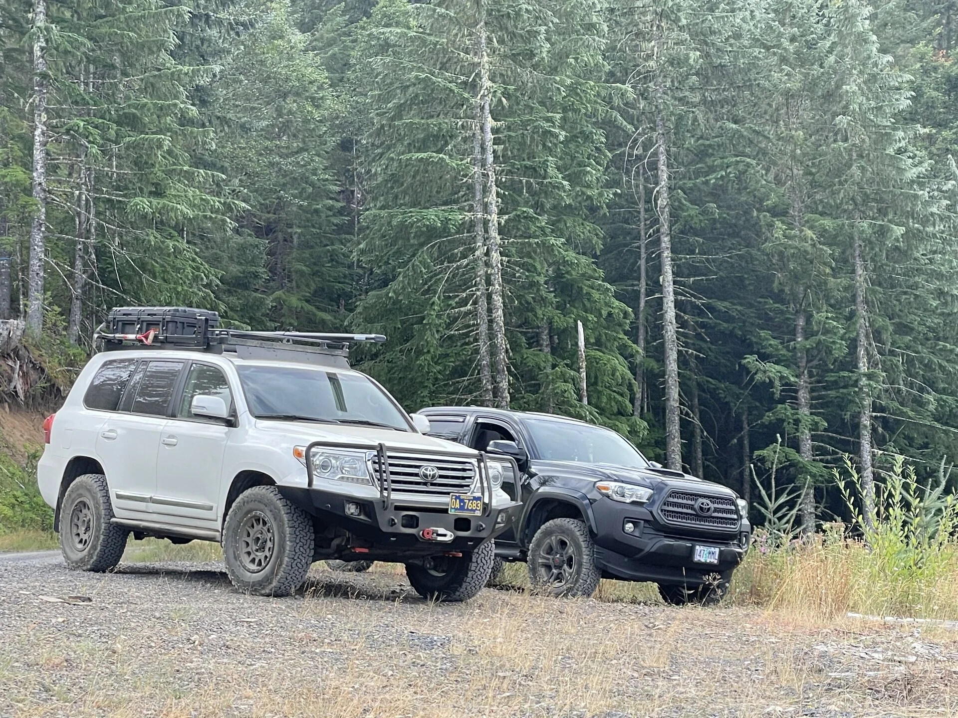

Seriously though - I started with the OEM leveling kit and tires and said that’s all I was gonna do. It was fine. Perfectly capable truck that could do 90% of the things I wanted it to do, if not more.
Then a year or two later, somehow ended up with this thing in my driveway. It all happened so fast.
Oh and congrats on the truck! She’s a beauty! Love the black on black thing you’ve got goin on there.
The OEM 10mm front spacers get you pretty close to level and allow clearance for 33's, that's a great place to start. Congrats on the new Cruiser and welcome.

I'm not sure the obsession many new owners have with leveling. As I understand it, the slight rake in the suspension is by design.
Congratulations. Nice cruiser.
Nobody likes the stink bug look.

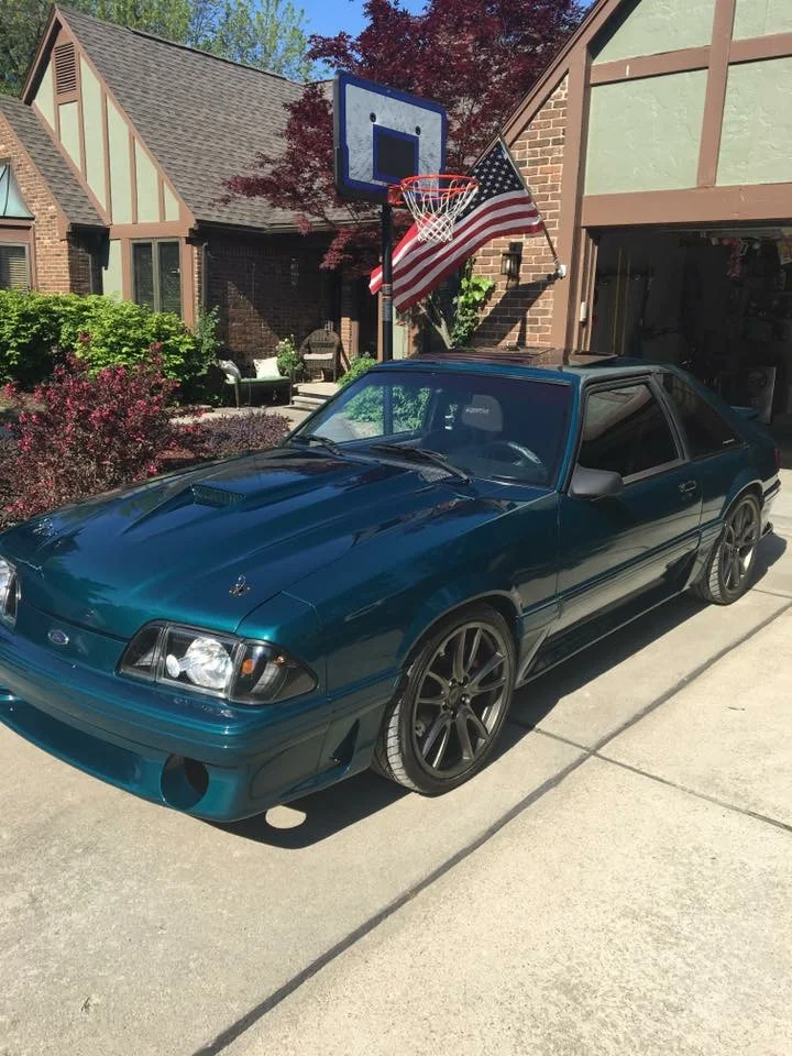

Your fox body really takes me back to junior year of High School. Based on what you’ve done to it you’re gonna need a second job with your cruiser.
Nice collection.
Fox bodies will always hold a special place in my automotive heart.
Sad thing is there aren’t a lot of good examples left, so many were modded out and totaled with front end damage.
Agreed and that's likely what's leading their soaring prices. I had a 1993 Cobra in Teal Metallic, I never should have sold it. I had my fathers 1999 Cobra for a year in HS (bad mistake on his part lol), a 2004 Terminator that I bought upon graduating college, and then two GT500's. It's safe to say I like the snake cars lol. Now days I still contemplate another but I am leaning more towards a P-Car for the next sports car but I still love and appreciate the Cobra cars.

Yes it is indeed.
The way the weight is levered over the axles, you dont want to remove the rake.
Anywhere the rig is loaded, front, cargo whatever, the rear squats like its supposed to as its all levered behind the front axle.
The weight distribution unladenis like 300-400 lbs forward on the LX when i cat scaled it stock.
The entirety of the payload is supposed to load the rear axle.
I do love the level look, but ive had the slight rake and kept it throughout all the BS I've done to it.

Thanks for all the input, not too familiar with these rigs so like to hear multiple views on it. If I do go with something it will most likely be the 10mm factory spacer. Gives me a little more clearance for bigger tires but still has a slight rake to it.
