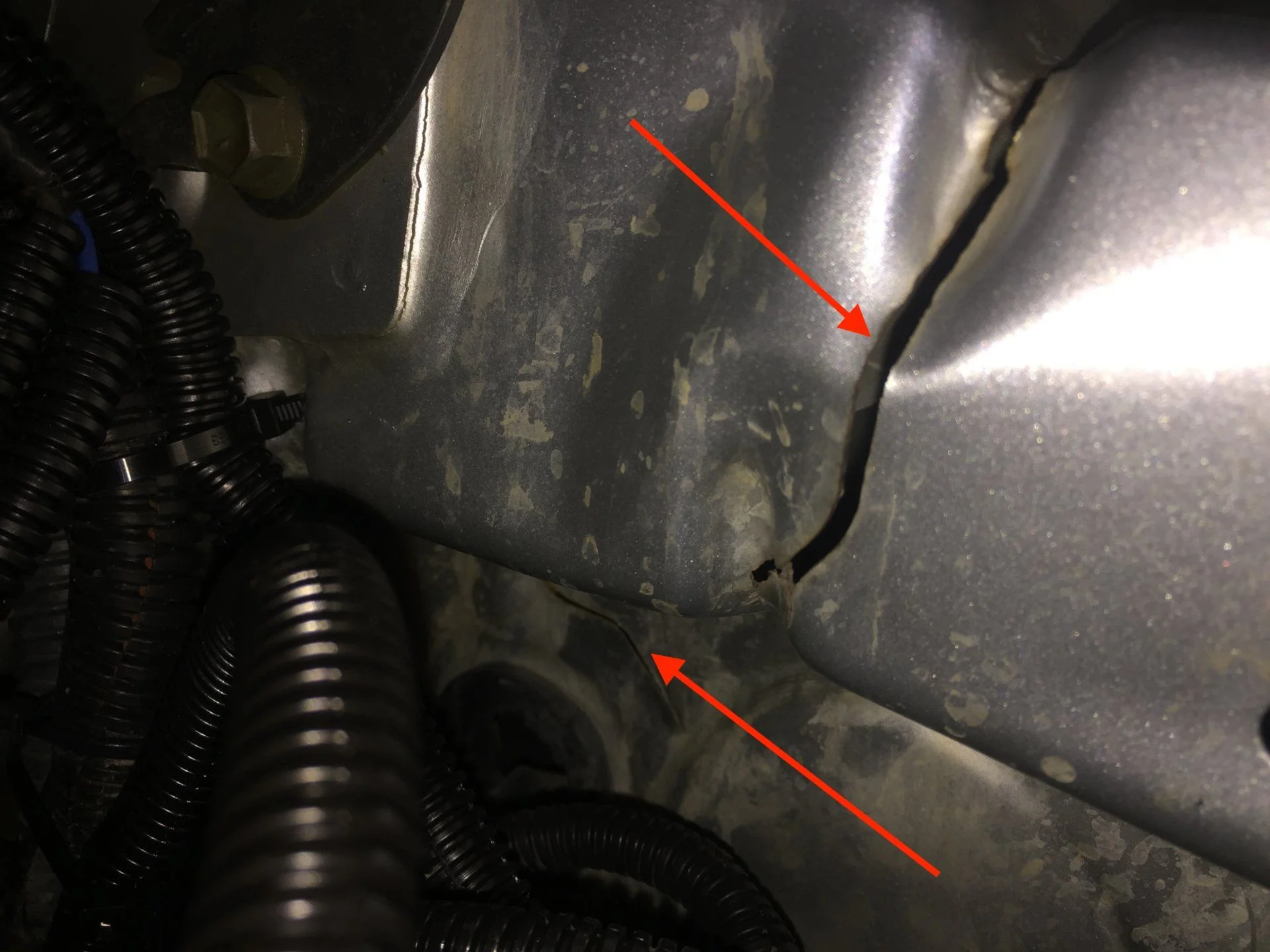

I would look for a 2008 or newer, the inner fender cracking revision happened midway through 2008. The 6 speed is a must.
Inner fender apron bulge and cracking happened into later model years as well- into 2009 from the reading I've done. If you dont know what to look for: check the area just infront of where the hood struts mount to the inner fender. It should be perfectly flat-, the plastic trim on top should be flush and not bowed. Look for cracks leading towards and underneath the radius of the inner fender. Look in the wheel well at the edge of the sheet metal where the splash guards mount- check for cracks there and above the tire.
here are some examples: notice the bulge.
