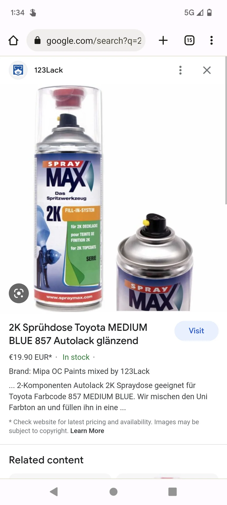

Found one source while searching Google, but they're in Germany.

Used this with good results after seeing others on here also have good results with it from this vendor.
They had what I needed for my 55.
