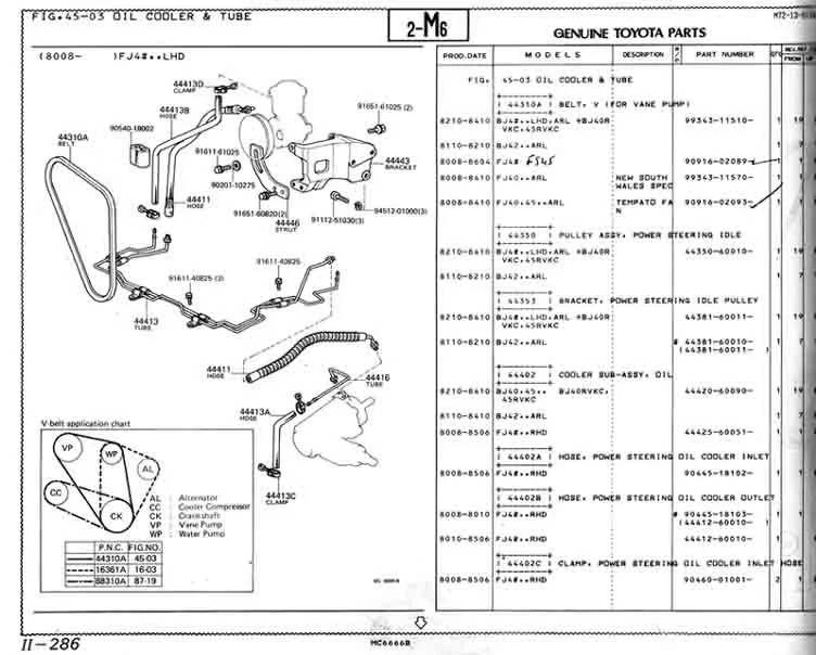

PS pump mount
Edward,
This pic is a scan that is originally is 1.4 meg - if you need it, pls pm me at hewitt_pat@hotmail.com
hope it helps.
That Saudi parts illustration looks strange with the pump on the right hand side:eek:
