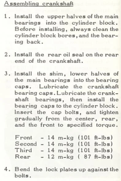

Then, I go to my 1966 "F Engine Repair Manual" (FSM) and look in the section about assembling the crank for proper shimming procedure. The manual states, "Install the shim, lower halves of the main bearings into the bearing caps." This is on page 2-30, "assembling the crankshaft" Thanks again, MUD, for the FSM download!
Here is my question: are there actually different sized shims? Do I need to look in a different part of my FSM for guidelines on determining the proper shims?

Here is a snippet from the FSM for you to read what I read.
I just measured all my old shims. They were all consistent at about .008".
I am leaning toward the conclusion that all shims are created equal, in this case.

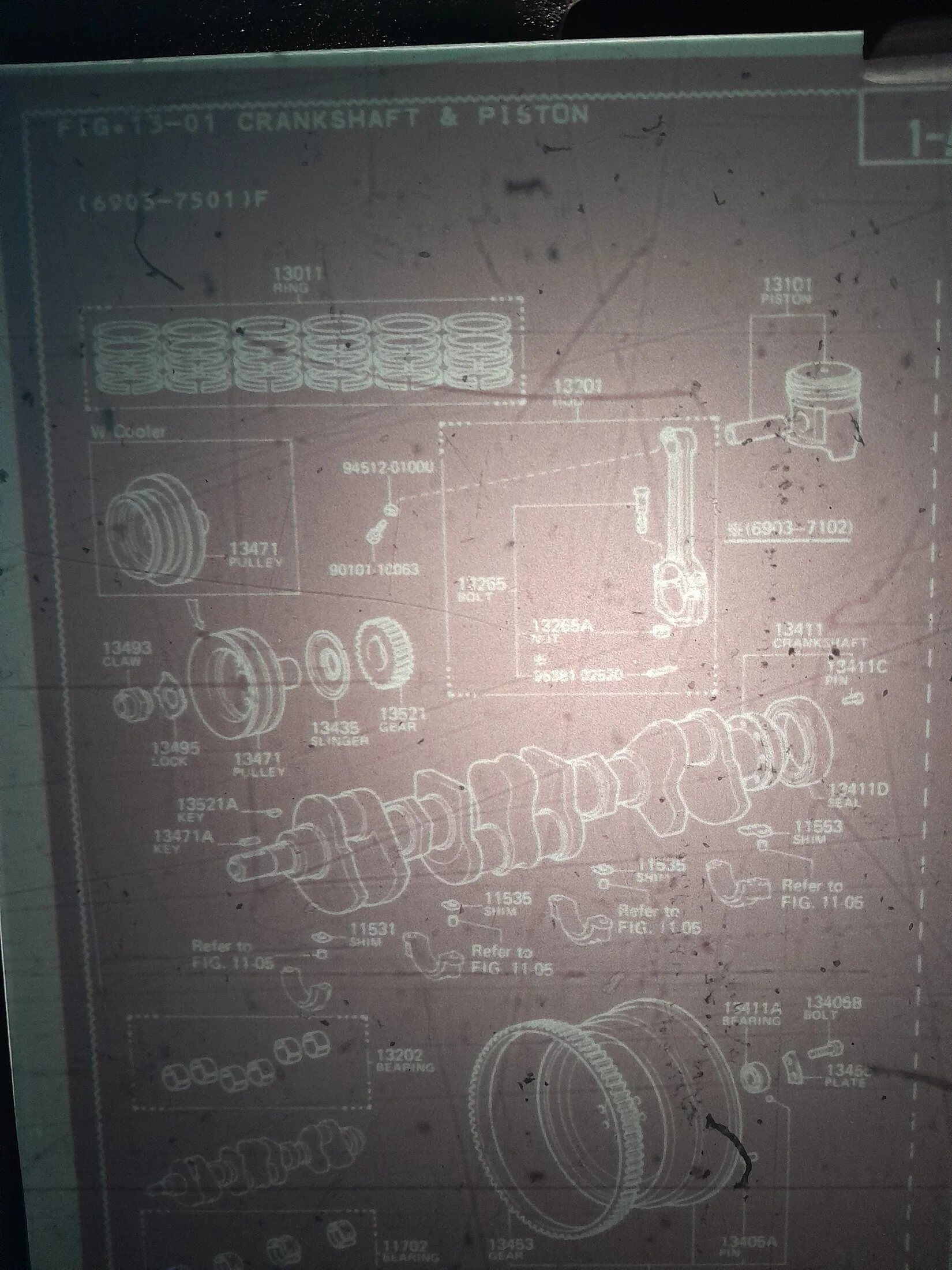

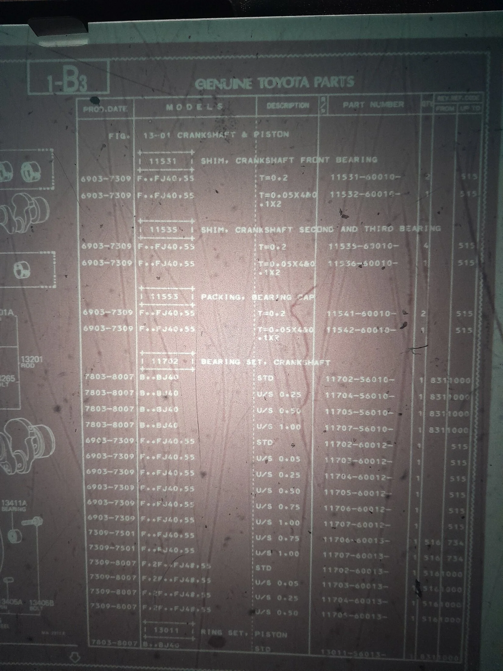

These pics are from my microfiche set for the F engine, 03/69 to 01/75. Maybe your '66 engine would be similar. I don't see alot of choices on shim thickness as shown. The "T" under the description column indicates thickness in millimeters.

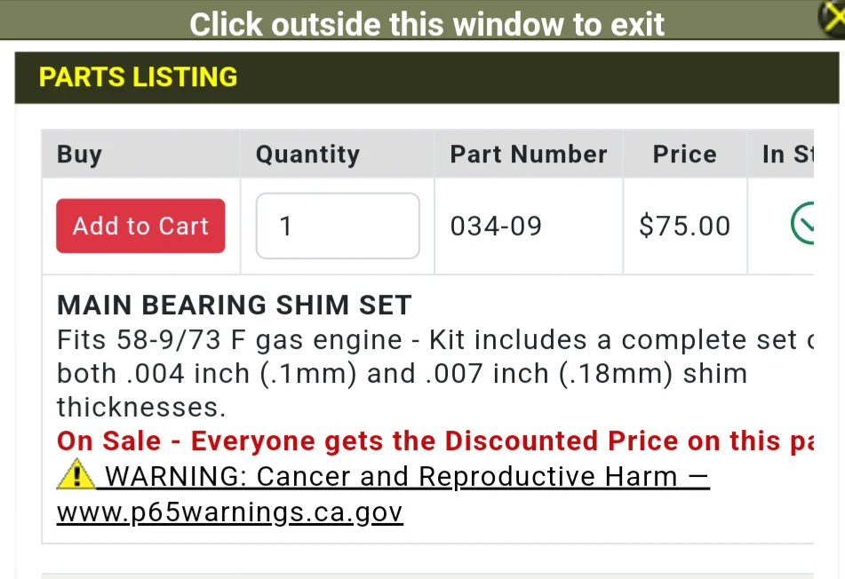

I think the item referenced as #9 at $or is what you are looking for, has some at $75. Give them a call.
Timmy nailed it.
Thank you! I placed an order for these! I had hoped to find just one but this set is the only option I found.
