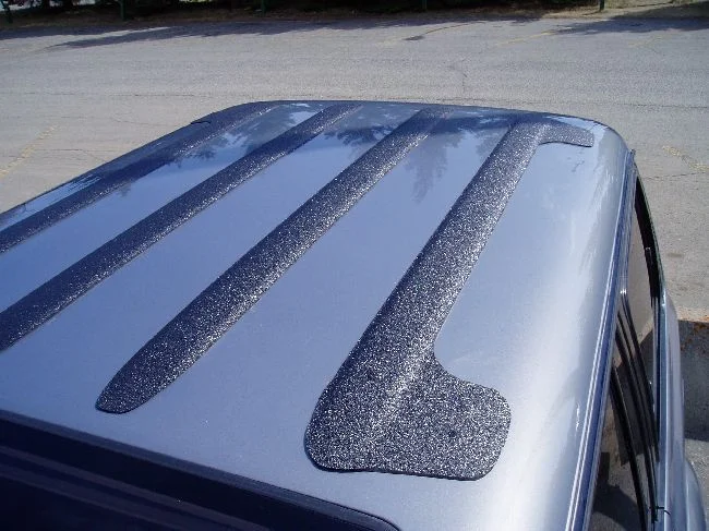

Here is what I did and what TYLER did...it was his idea so I can't take credit for it but I followed and it worked great.

That is great looking! And a much easier than a paint job!
Did you have to make a mold of some kind or did the Rhino shop do that for you?
I emailed Rhino with pics of tylers roof and they said no problem and gave me a price then I went down and they did everything else including taking off the tape from the rails and filling the holes...one stop repair!!

Check out my thread dedicated to Line-X'ing the roof subsequent to roof rack removal.

Damn nice both of you. Does Rhino come in white?
You can have it color matched for an extra fee...
