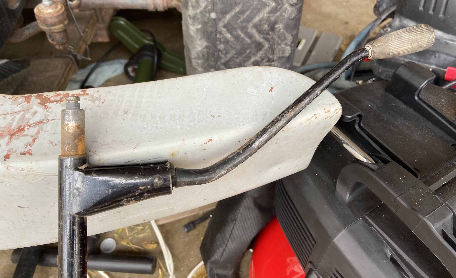

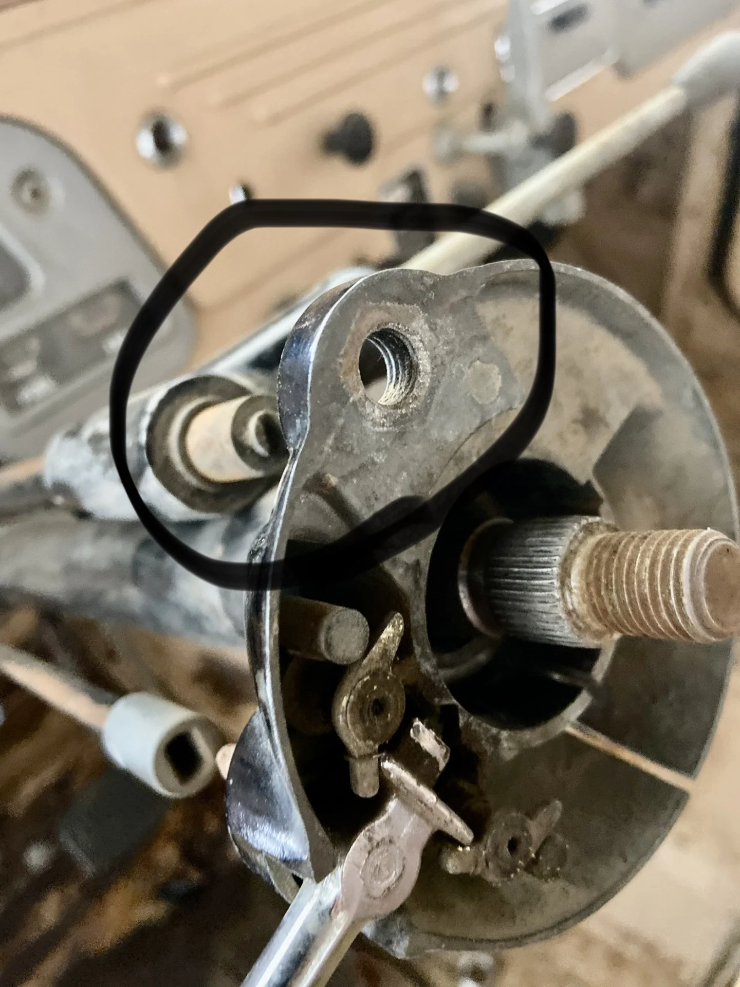

Not even sure something is missing. I need to connect the shifter to the turn signal collar.
Obviously I’m missing the know how.
It’s actually integral Paul. The part that drops into the shaft is turned down and threaded on the upper end. It literally threads and unthreads itself out of the turn signal housing with every shift. :meh:
