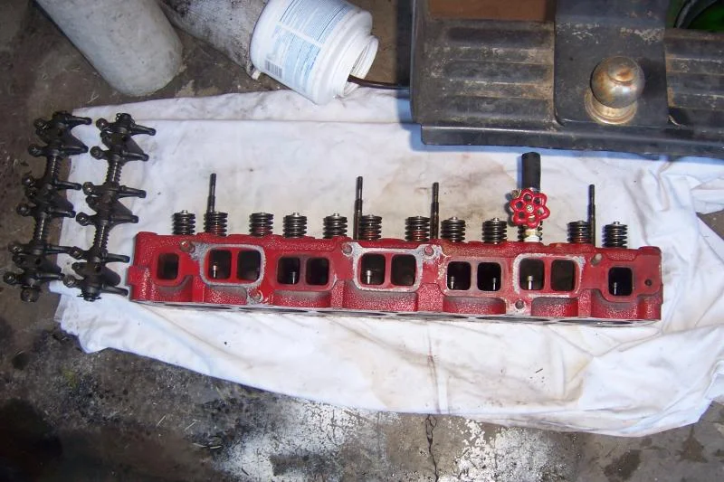

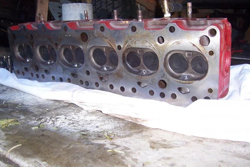

So I have a 9/72 FJ40 with the original motor, minus the smog and air-rail stuff. No mods other than that. I have a line on a rebuilt head from a '68 F, and I want to be sure it would work. I don't know if there is some incompatibility due to open vs. closed combustion chambers (mostly cause I have no idea what this means), and flat vs. domed pistons (I can understand this concept, I'm a zoologist, not an idiot). I checked the info on the FAQ and found alot about putting a F head on a 2F block, but couldn't decipher the unique properties of the '73 motor. Fourth FJ40 I've had, first one with an F motor, all others were 2F. And as long as I'm asking, what's the deal with a vacuum retard dizzy? Can I just disconnect the line and go on mechanical advance alone? Thanks in advance.
This is what I'm considering getting:
attachment.php
attachment.php

So am I right to assume a '68 head with a closed chamber for use with flat pistons will not work with a '73 block with "a very small dome on the piston."?
Or should I just quit being stupid and swap the heads and see if stuff fits?
I think you should be good with that head. And sorry about the no-help links:doh: I thought sure that one of them would have the JimC post about casting numbers and which ones go with which pistons/blocks. That head should have the same oiling system as your old one.
