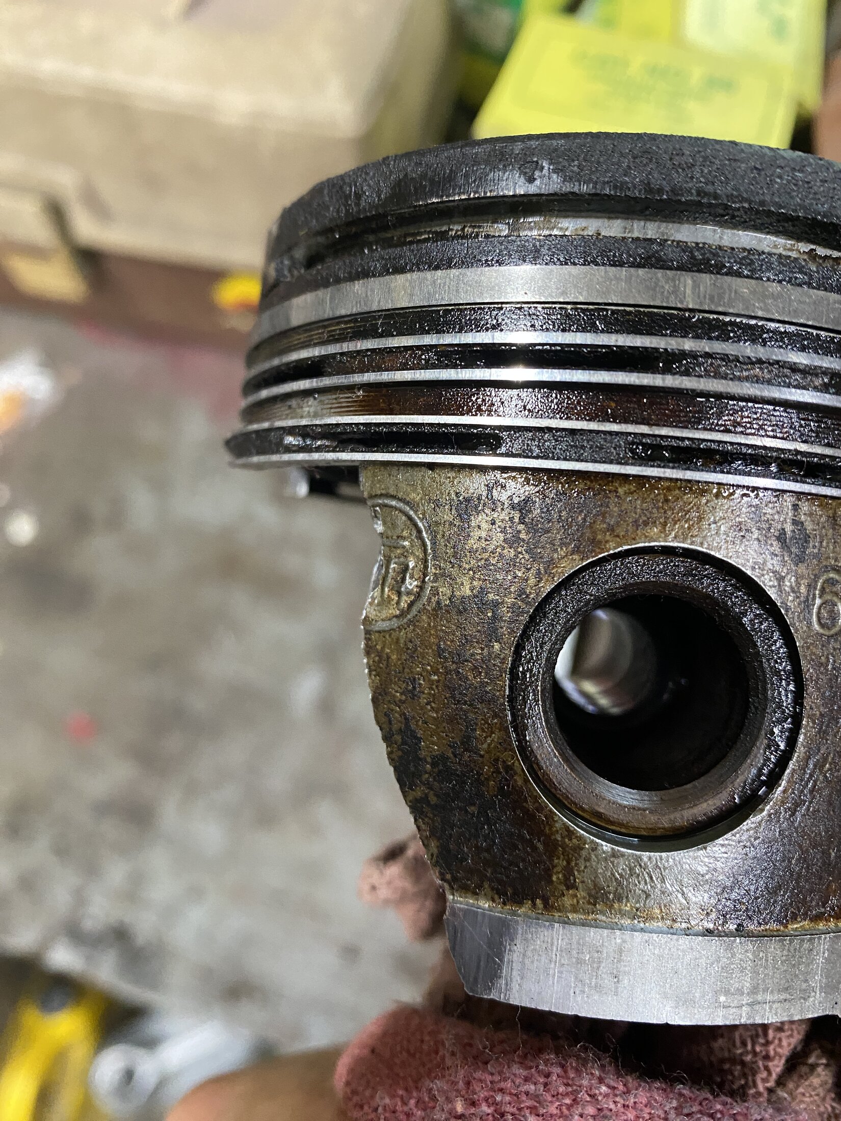

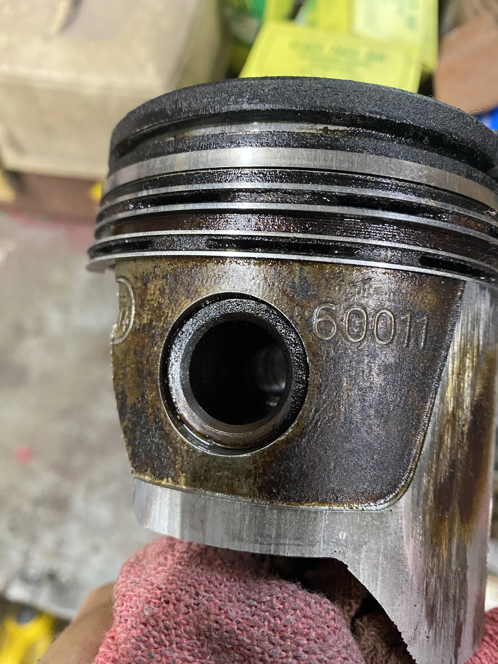

A couple weeks ago the #6 piston in my 40 came apart. I’m ordering new parts to get it back together and just wanted to double check I’m getting the right thing. The build date is 12/71 and it’s the original F engine. The PO had it since new and kept very detailed records. I can’t find anything about the bottom end being worked on. Also from everything I’ve read if they were overbored they would have numbers stamped into the top which I don’t see. So based on all this I’m assuming they’re standard bore but just wanted to double check here before I ordered new ones? Also the broken one I pulled out has the TEQ logo and the number 60011 on it if that helps.

That piston has clear signs of pre-ignition to the point where the head of the piston has eroded to the oil ring. And there are some very questionable score marks on the side that I am guessing match the cylinder bore. That is likely your root cause of the skirt giving way.
And also something definitely was rattling around in that combustion chamber. Did you find the missing pieces of the oil scraping ring?
If you have the head off or have a borescope, what do the other piston tops look like?
What did the rod bearing look like for that piston #6?
